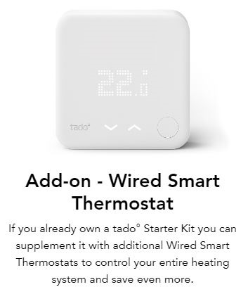

Add-on - Wired Smart Thermostat

2. An additional Smart Thermostat
To control the second heating zone and wired in to replace the TP5000 [I think this product has been updated so the diagrams I gave Daint may be slightly different]

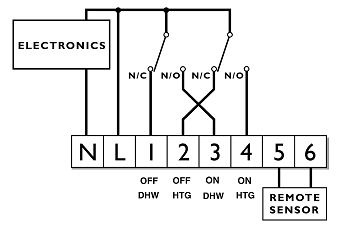

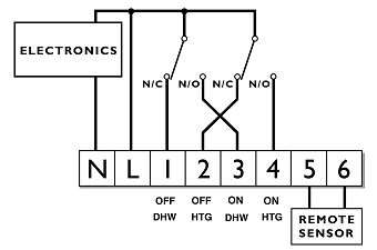

The TP9000 which is being removed is wired as below:
The remote sensor is an integral part of the TP9000 (albeit remotely located) it should be removed along with the TP9000.

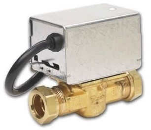

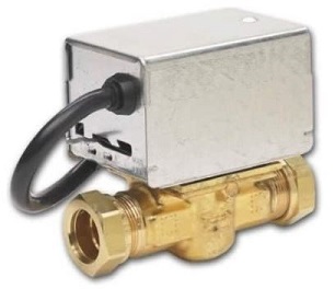

The thermostats do not control the boiler. They are wired to motorised valves that look something like this (other makes are available :))
There will be one motorised valve for each zone. When a thermostat calls for heat, the valve opens, when the temperature is reached the valve closes. So in your case, the downstairs zone motorised valve will be wired to the TP9000 and the upstairs zone motorised valve to the TP5000.
2. If Bedroom 4 has the Smart Wired Thermostat, then if it isn't calling for heat, then Bedroom 5 and the Towel Radiator both with TRV's won't be able to demand heat will they as they are all on the same zone?
That is correct. When the motorised valve associated with each zone is closed by the room thermostat, then that switches off all of the radiators on that zone. This is why positioning of the room thermostat is vital. It should be located in one of the last areas to heat up so that the other rooms are already warm (but not overheated as their TRV's will prevent that) before the room thermostat turns off the whole zone. The radiator where the room thermostat is located should not have a TRV fitted, as one will stop the other working properly.
The two zone approach is a building regulations requirement. So I'm guessing that your home is quite new. The building regulations require that the sleeping areas to be on a separate zone to the living areas. This is for energy saving as it allows the bedrooms to be controlled separately from the living areas, in that the bedrooms can be off during the day or at a lower temperature that the rest of the house.
Which zone the radiators are on is determined by their plumbing connections. Not the controls.

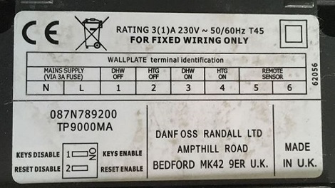

Smart Wired Thermostat fitted to replace the Zone 2 - TP5000. Working well. Logged a call with Tado Customer Services, and awaiting them doing their magic.

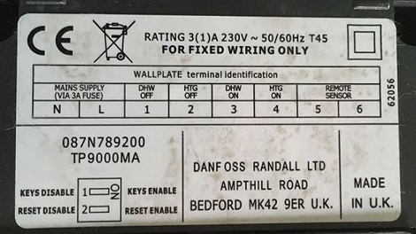

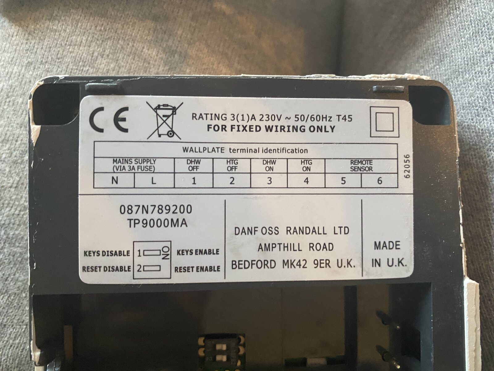

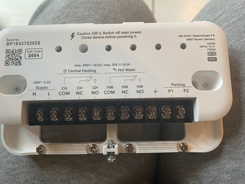

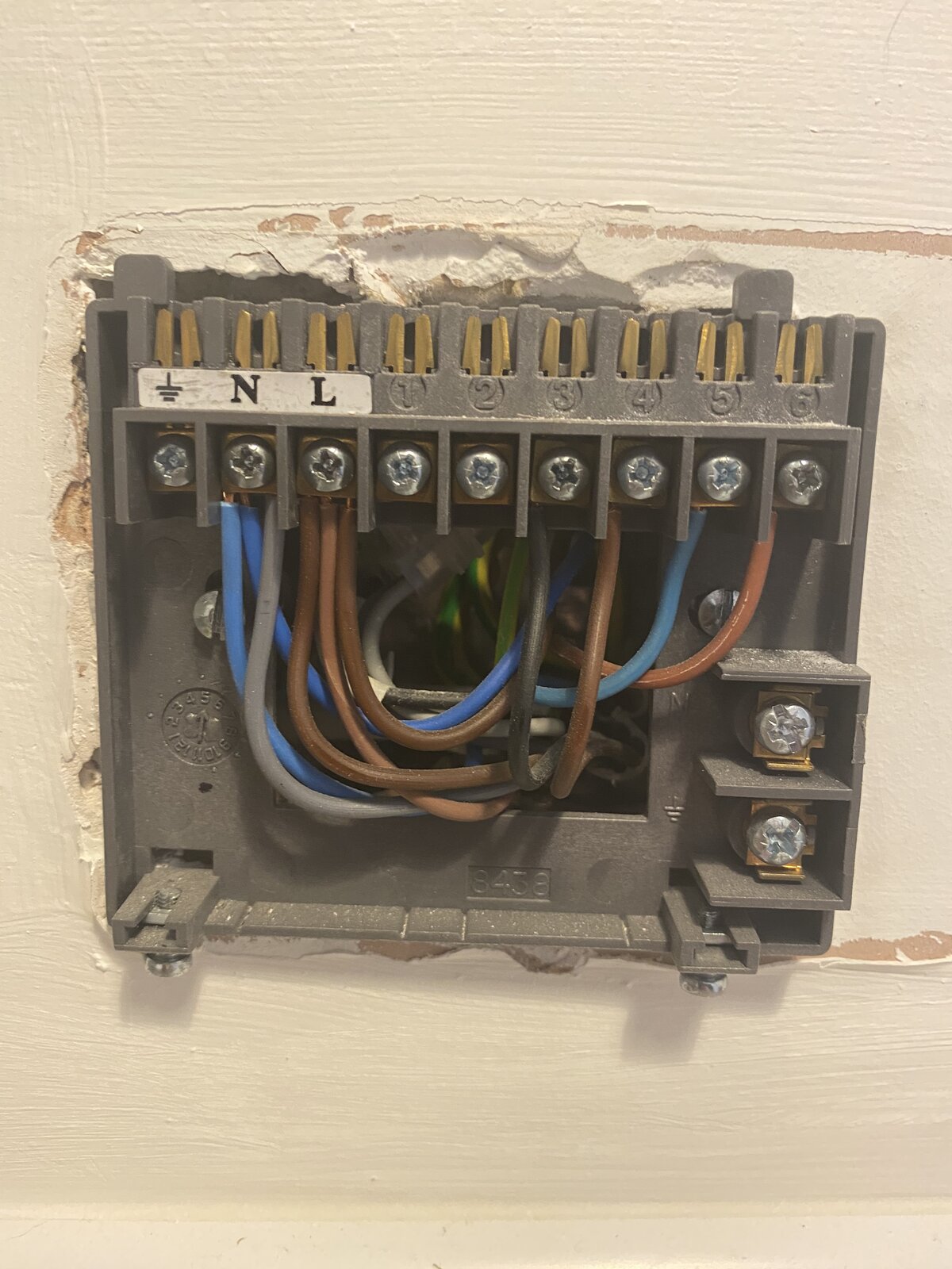

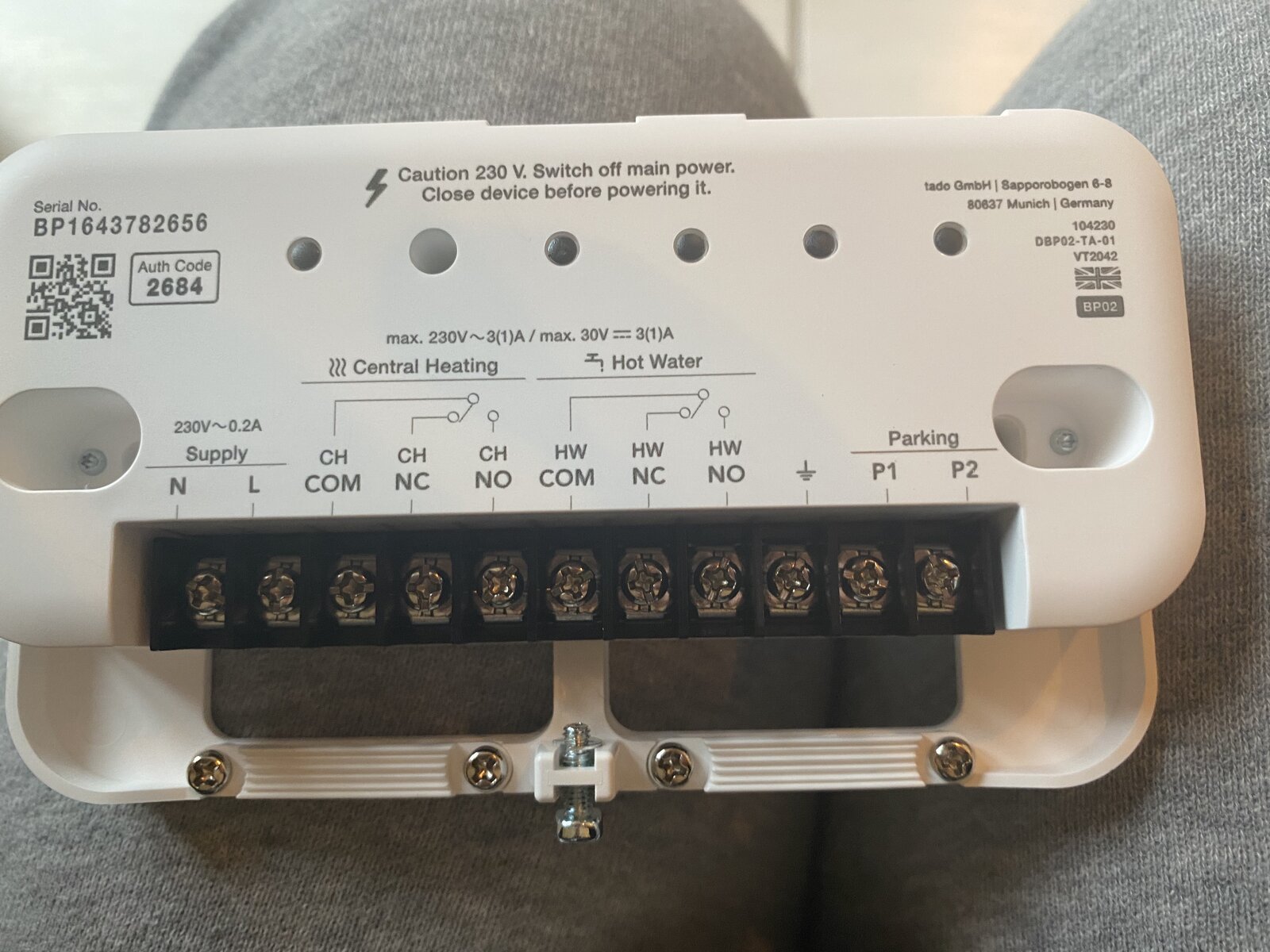

I have just purchased the tado° Wireless Smart Thermostat Starter Kit V3+ with Hot Water Control and am struggling on how to wire the Wireless Receiver v3 in place of the TP9000. I have attached images of the removed TP9000 and the Wireless Receiver. I know 5 & 6 or no longer needed at were for the TS2 sensor but as for rest, I'm not sure. Can someone simply explain what goes where, for example wire 1 now goes into CH COM etc.
I have another general system query. Our bedroom has a thermostat which will be replaced by a tado wired thermostat. However, we want this room kept cool, but another room on this same floor needs to be warmer. Can I set the tado in our bedroom at 20 degrees, then the other room at 25 degrees using a tado smart radiator thermostat? My fear is that the bedroom thermostat controls the temperature of the whole floor so no room can be made warmer that our bedroom! If that is the case, is there a way around this?
Any help would be very much appreciated.

Hi Luke, welcome to the forum.
For next time, ideally you should have started your own new post. Hijacking someone else's is against the forum rules. Don't do it now though because you will be duplicating your post and that's also against the rules. :)
Anyway, back to your question. Remove the remote sensor as you have ascertained, then you can determine what the wires from the TP9000 do from the diagram on the back of it.
The wires then are moved to the terminals at the Tado that have exactly the same function.
So:
TP N = Tado N
TP L = Tado L
TP 3 DHW On= Tado HW NO
TP 4 HTG On= Tado CH NO
Then the 3 Tado terminals L, CH COM and HW COM should be linked together.
