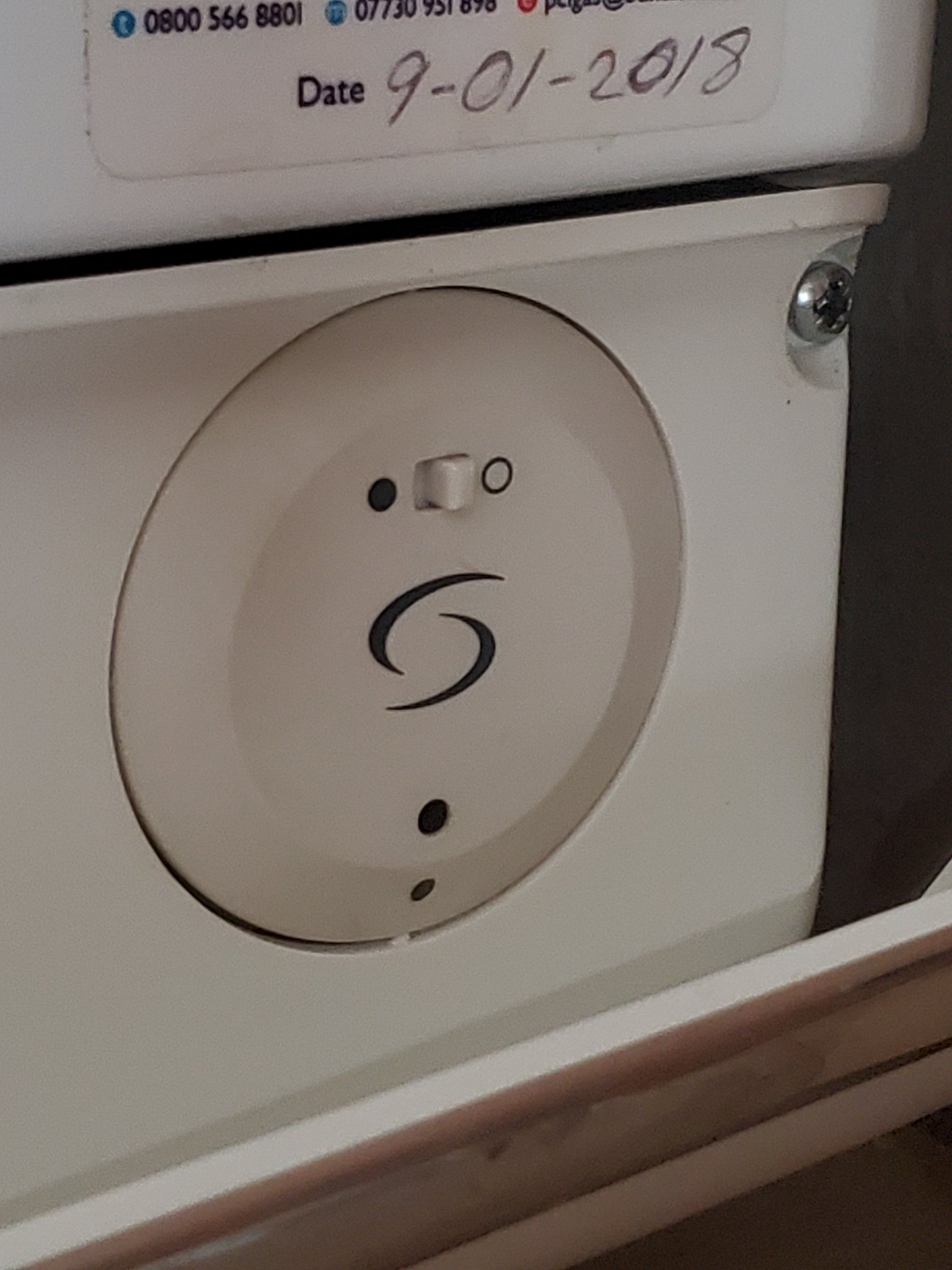

Hi there I have heating controls for my baxi duo tec boiler, the controller is a Salus RT501rf
Recently the boiler seems to be coming on of its own accord, not due to the RT501RF which seems to be working fine [it turns the boiler on if manual set a temperate above the current temperature showing on the RT501rf, and turns it off when i reduce on the rt501rf)
not sure what the button on the top of the controller does or if it should be on the left (solid black circle) or right [empty circle) - see photo.
I dont have any manual for these heating controls
Can any of you experts help?

Left is manually always on, the right is auto and controlled by the programmer.
Any motorised valves installed? If not, possibly the Salus sending a switched live.
