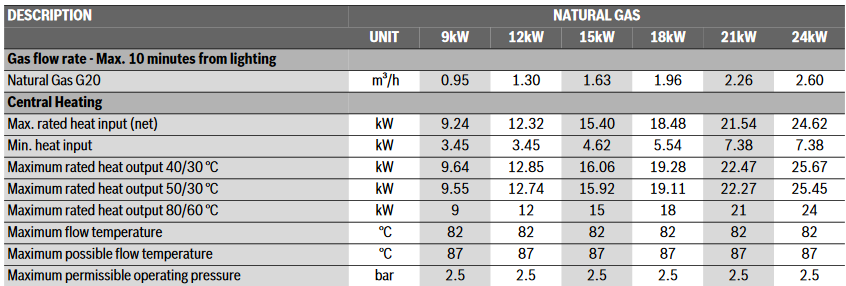

Job one is look what boiler should do.
You will notice there is a range, so looking at 18 kW 5.54 kW to 18.48 kW and when in mothers house which also had a modulating boiler I found it hard to tell if the boiler was ticking over or running flat out, here with an oil boiler easy it only has one output, so if running that is output, but the return water temperature can control the boiler output.

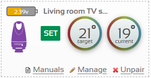

So I used the TRV the Flat Battery TRV.jpg computer shows both target and current, so if current exceeds target then close the lock shield a small amount, and after trimming the lock shields the TRV's kept the room within 0.5°C of set point and worked very well, except when other heat sources caused problems like sun in bay window.
Once set I found the radiators ran a lot cooler, as the boiler was modulating so getting a constant heat just enough to maintain the room temperature not the all or nothing I was getting before they were set. Since the radiators ran cooler, when the sun hit the bay windows they stopped heating room faster so less over shoot caused when sun came out.
