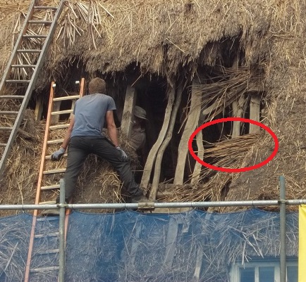

While the thatch does provide good insulation they can allow cold air into the loft space when the wintery wind is strong. It depends on the way the roof has been thatched. The thicker the horizontal base layer the better.
Get a Master Thatcher to look at the roof and give you an appraisal of it's condition and how long before it will need maintance or re-thatching
Also get quotations for insurance costs before committing yourself to purchasing the cottage. Insuring a property with a thatched roof is expensive and on going.
