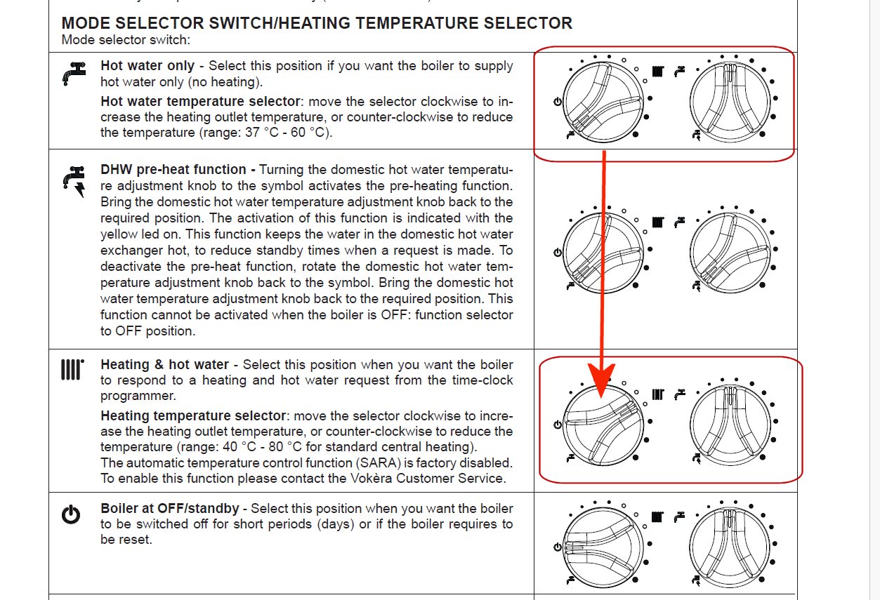

Open flap on boiler.
Should see two knobs. One for hot water temp and the other for radiator temp.
Probably see lights as well. Green is good and all working.
Post picture of boiler and controls may get you better advise if you can't see anything that could be a problem
As suggested - if the boiler runs and gives you hot water then the boiler should be ok. Pull up the front cover flap to get to the controls and check that the left hand CH knob is turned clockwise from the tap symbol to point towards the 3 white dots

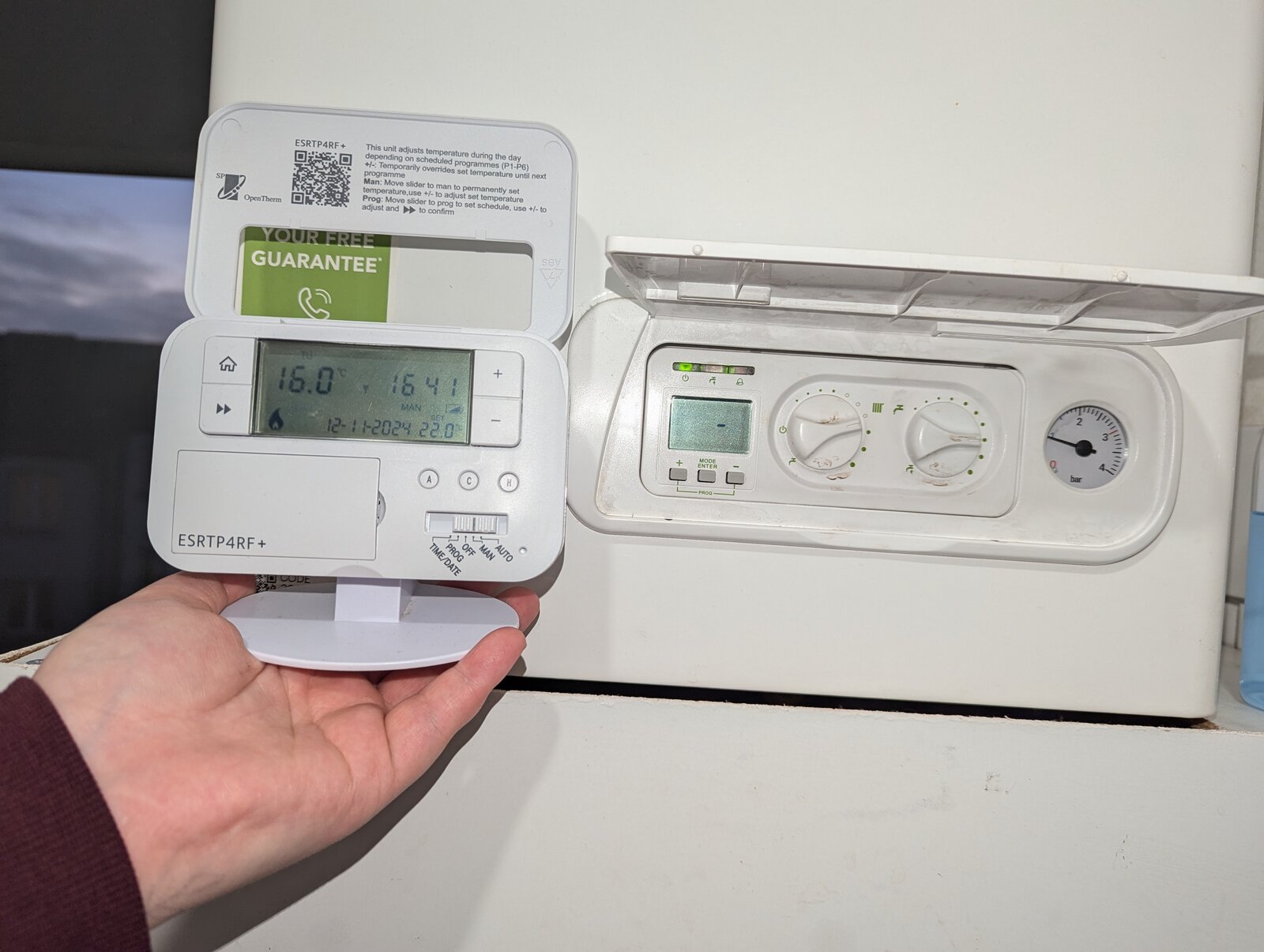

This is the boiler and the thermostat
Your thermostat is showing low battery, have you tried changing these for good quality alkaline ones?

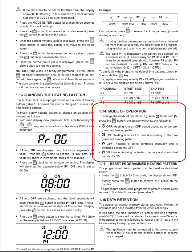

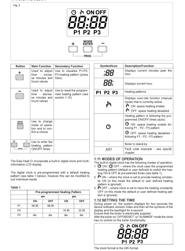

Ah ok - its the Easi Heat CI - comes with the digital timer - Don't you have the manual, if not might be an idea to download a copy.
If I remember rightly you have to set the timer/programmer with the time, it can lose it if it's been off for a while. If it is already set (press mode) then you'll probably need to set the mode to always on. I presume there is also a receiver plugged into the boiler for the ESI programmable thermostat that's in your hand?

It may also be worth checking that the thermostat is correctly operating.

Tried new batteries, it didn't work. We worked our way through the user manual and tried the programmed mode and the auto mode just on the 24hr setting.
We also took the front of the box off and found the receiver, pressed the manual button and nothing happend also pressed the m/a button and nothing happened.
The m/a button did turn it self off while I was setting up the programmed mode

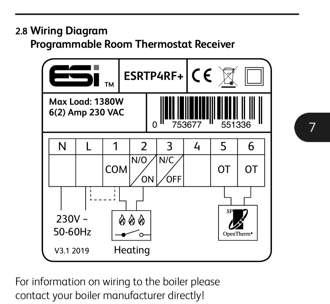

The last thing I would attempt to do, would be to bridge out the thermostat receiver; ruling that out as being at fault.
If you feel comfortable and with the power safely isolated, could you show us the wiring behind the receiver?
