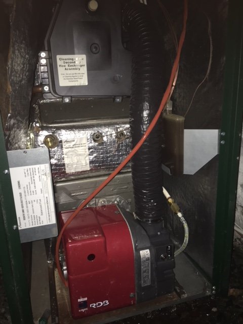

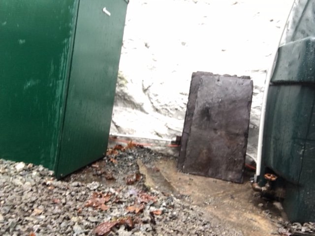

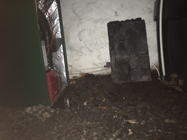

Boiler is a Worcester Camray External Boiler. The Riello Burner RD3 sits in the bottom of the boiler with the oil pipe into the side of it.
The oil tank sits a few inches higher than the boiler but is not raised up any more.
Am I right in saying it is gravity fed only?
I presume, the question I need to know is what height is the oil actually drawn into the burner?
thanks.

It will run until the oil drops below the tank outlet.

Thanks, wasn't sure whether it would be as low as that given the marginal height difference. I have never run it that low so wanted to know.
Not saying I am going to run it right down but it is good to know as I always run on the side of caution... but also prefer to buy as much oil as I can infrequently if possible...
If I was you I wouldn't let it run down more than 8inches above the out let if you do there is a chance that dirt and water can be pulled into the pipe and jigger the oil pump and cost you a lot of money.Bob
Ignorant on this but isn't that why there are filter bowls on these?
I thought the pumps provided a marginal degree of suction meaning that the tank base can be a foot lower that the pump and still function?
