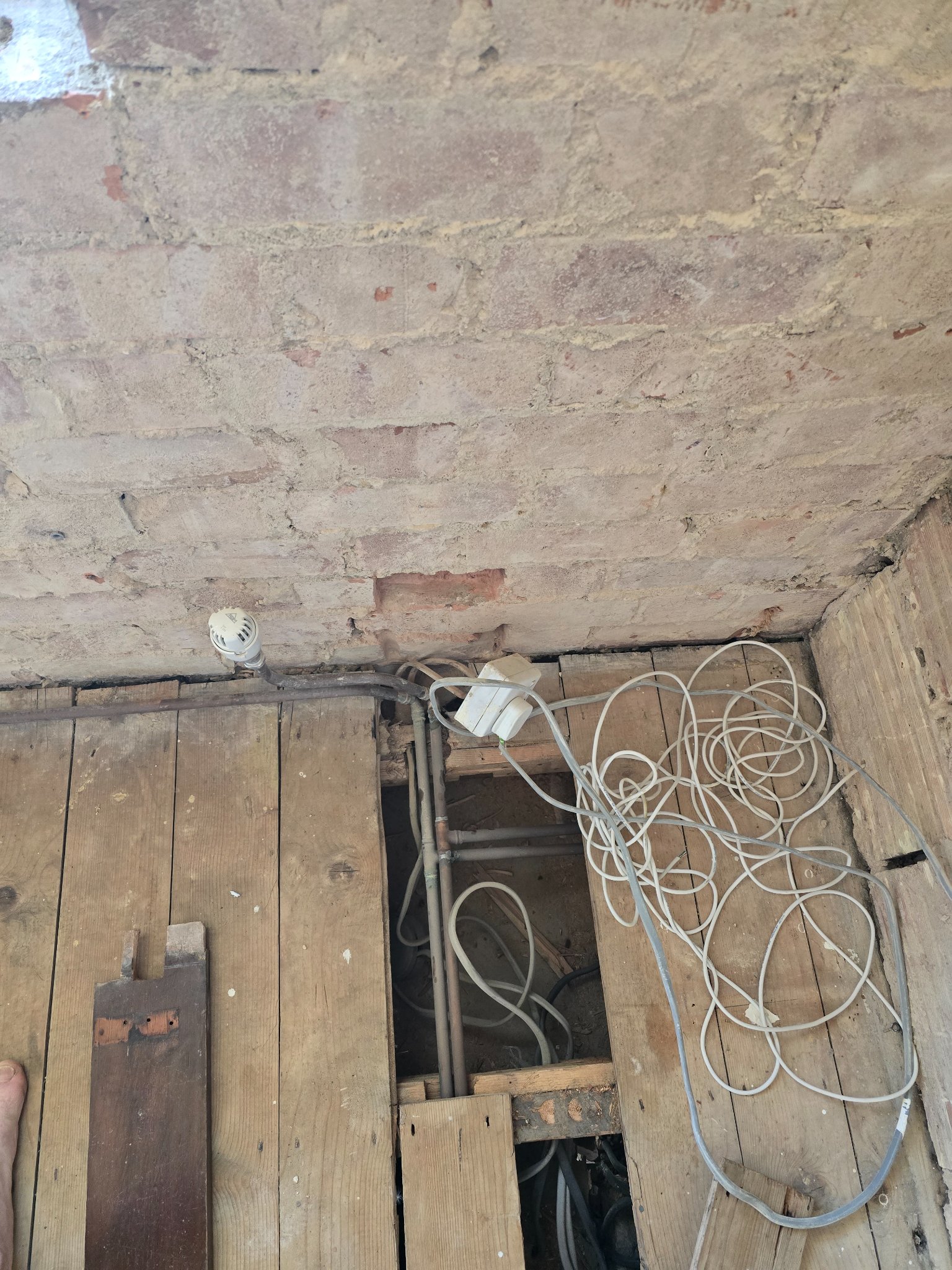

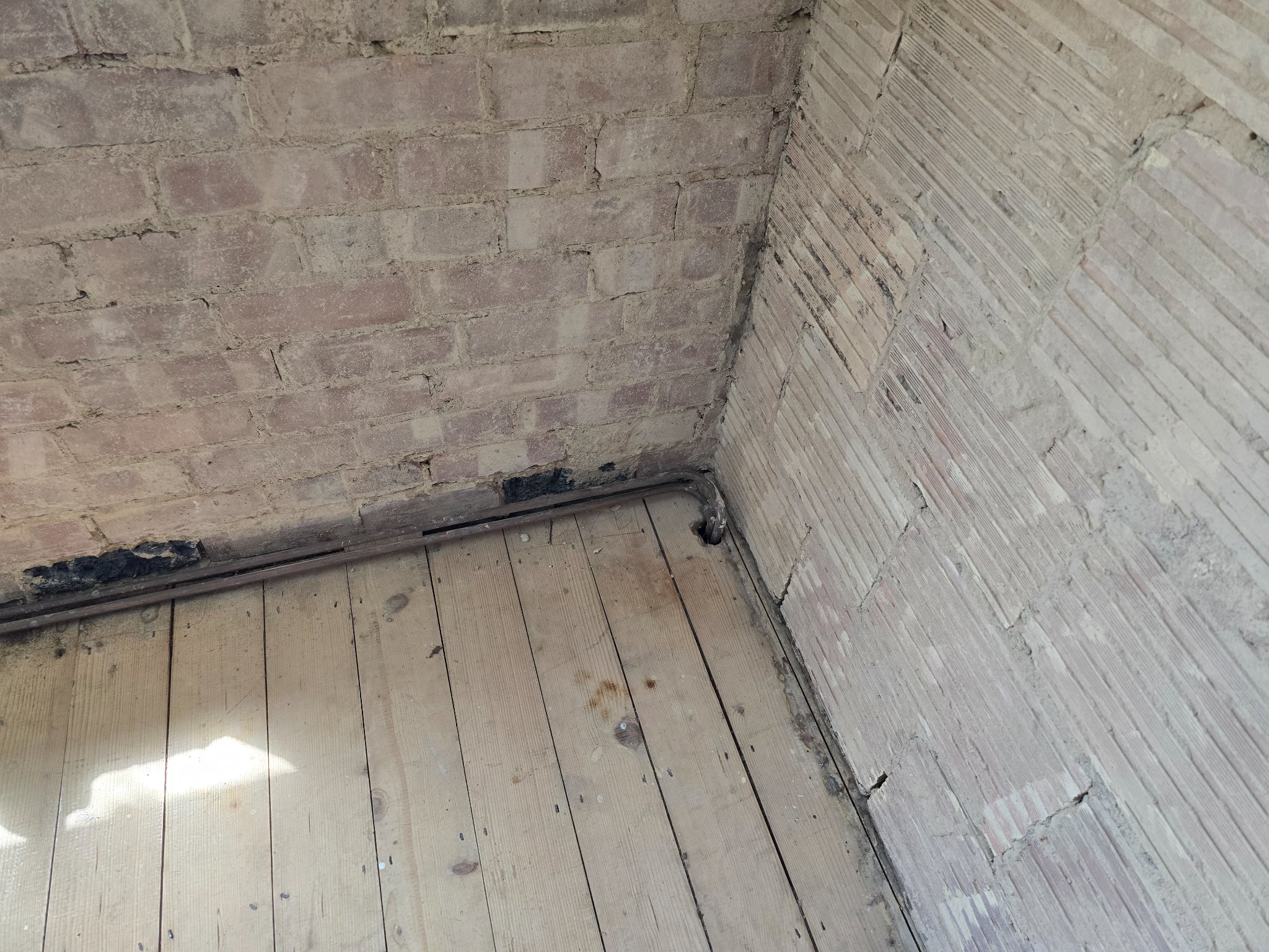

Hello
I am looking to 'hide' the heating pipes, under the floors or in the masonry wall.
By the looks of it the floor joint is to close to the wall and the only option is to hide them into the wall.
Any advices will be greatly appreciated.

Either or really, lift the boards to put them under the floor or cut a channel in the wall. Whatever you prefer.

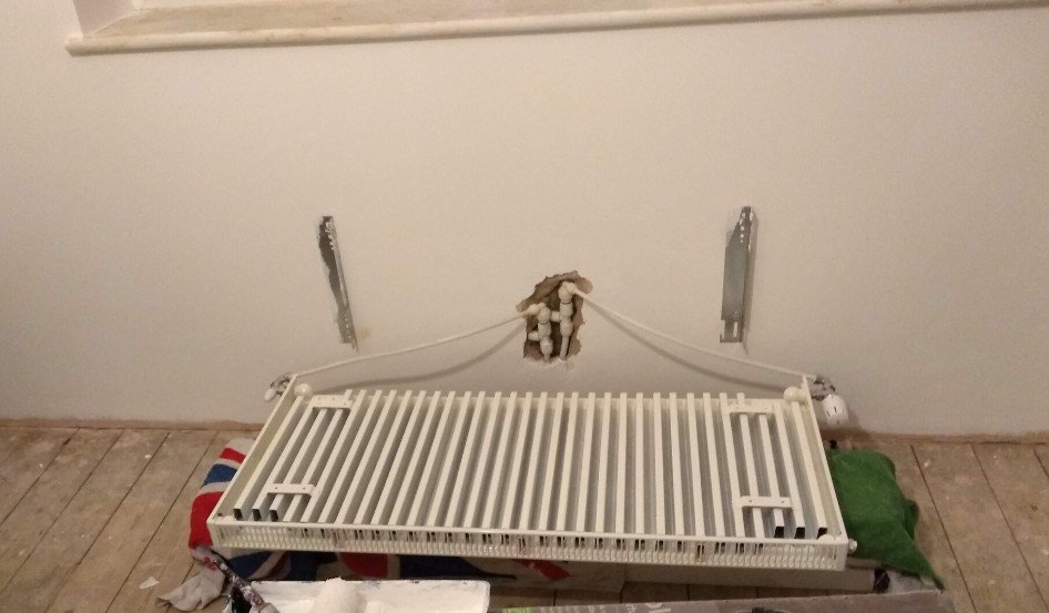

If you're not a skilled plumber then replace from the red line onwards with 10mm plastic pushfit. If you want a nice clean look run them up the wall behind the rad.
This is but messy as a temporary fit but gives the idea.
If you bury them in the wall and goodness forbid you have a leak, might prove difficult at that stage, probably best under the floor.
