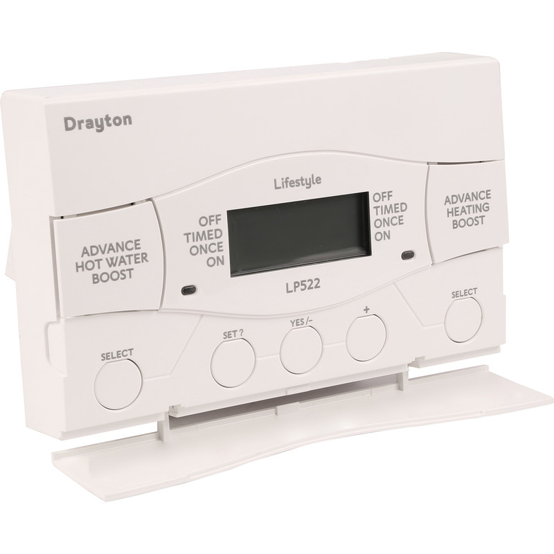

Is it normal for a digital programmer on a fully pumped open vent system (with a heat only boiler, three way valve, tank stat, central heating stat) to require central heating and hot water to be called for at the same time for the central heating to work?
Or should they work independently when requested on the programmer?

If it's fully pumped it should be possible to have independent control, but it might require a few wiring changes. Some programmers have a jumper or switch which allows you to select between gravity hot water and fully pumped, some have a mechanical linkage

Ahh, I thought that might be the case.
So, it looks like this programmer has been set up to allow individual calls for heating or hot water. But, the heating only works when both are selected. Because the programmer does not override the hot water to "on" automatically, you have to ensure both are manually "on" for the central heating to work.
@ianmcd This is a picture of the programmer.
OK it is set to fully pumped , if it was set to Gravity then when you press the CH button the HW button will come on at the same time whether asked to or not
So does that suggests that boiler and pump are not wired to accept the individual calls?
The 3 way valve seems to be operating correctly. Other than this programmer quirk the system seems to run fine.
Incorrect wiring, or the microswitch in the 3 port valve has failed.
I did a test using the thermostats.
Both thermostats set to "off/low".
1 ) Hot water only on the programmer. Turned up the tank stat until it clicked, and the boiler fired for hot water only.
2) Repeated the same for central heating: Both stats set to off/low. Central heating requested only. Turned up the room stat. No boiler fire/pump.
3) Repeated - Both set to off/low - requested both on the programmer.
a) First I turned up the room stat and the boiler fired and pump activated and it seems the 3 way valve opened for central heating.
b) Then, I turned up the tank stat, and I am pretty sure I could hear the 3 way valve motor activate at that point to heat the tank too.
Does this suggest the 3 way valve & microswitch is fine and it is incorrect wiring?
I think it has always done this. I've been using it for a year or so (new house). I just went with it last year, but I knew there was a quirk with it.
It's the first time I sat down to work out what was going on.
If you turn off the power supply and remove clock the backplate should have
N L hot water off in 1 hot water on in3 heating on in 4
turn the HW off and confirm that the 3 port valve definately motors over to Heating only and not mid position
So turn the HW off via the programmer, and while the boiler will shutdown (due to the potential wiring mix-up), the 3 way valve should still go to heating only?
How will I tell if it goes to CH only rather than mid position?
