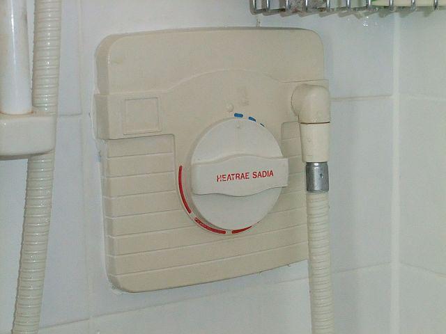

I have a Heatrae Sadia shower, and I can't work out how to get the thing off the wall to gain access to the pump (which needs attention).
The central knob pulls off and reveals three screws, which I have removed, but the outlet pipe is still preventing the front panel from coming away.
Can anyone advise how to remove the outlet pipe, and hence allow the front panel to be removed?
Picture of the shower (hopefully) attached to show what I mean! (Obviously I have disconnected the shower hose - it's the small right-angle fitting attached to the main unit that's the problem :-)
Any help appreciated.
That's a supajet 100.
Take the dial off as you've already done
Turn the swivel hose connection so that the outlet faces the valve spindle and pull off, ensure that the 'O' ring remains inside the outlet fitting.
Then remove the 3 screws.
I do have the instuction manual for this shower if you need it. :wink:

Managed to get the front off, and the thing looks quite easy to disassemble.
Unfortunately, it seems the pump and motor assembly is an obsolete part, so I'm either going to have to try to renovate the existing pump, or replace the entire shower.

Most of the important parts for this shower are now obsolete.
And changing this shower won't be straight foreward as this shower is supplied power from a transformer at 11.5 volt most power showers are 230v so a new cable will also be needed to be run down the wall.
The only shower i know powered from a transformer is the aqualisa aquastream.
