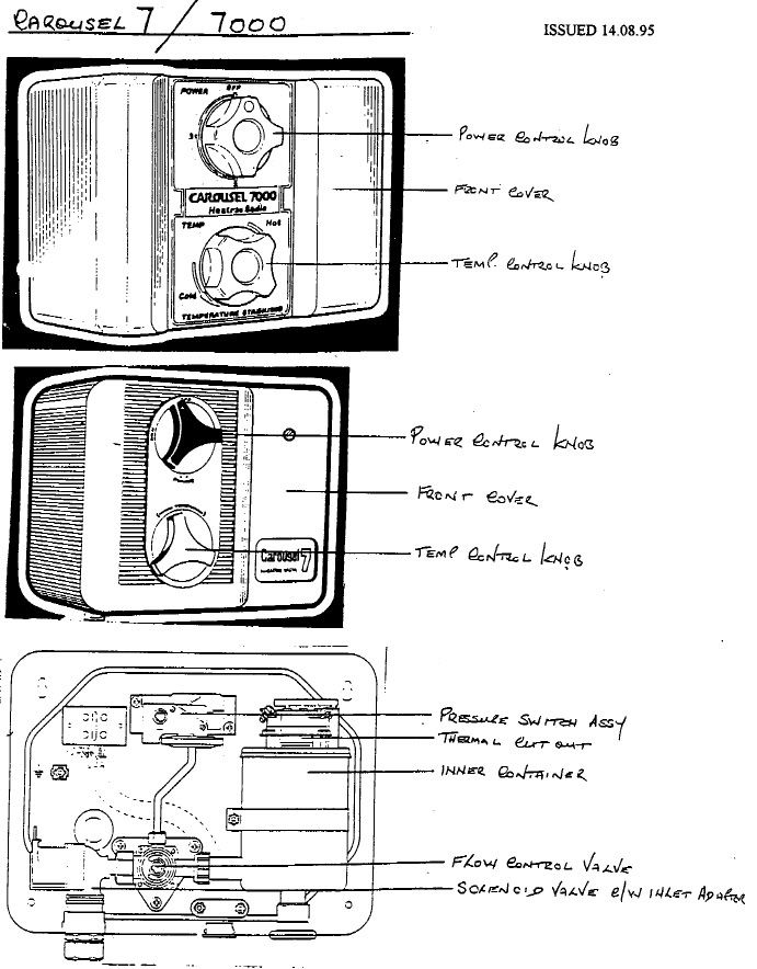

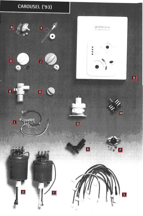

I've got a Heatrae Sadia Carousel (quite an old one) that has developed a dreadful leak, I've taken the cover off to have a look (while wearing heavy duty insulated gloves) and the leak seems to be coming from the large white circular plastic disk that controls the temp setting.
Is this repairable or is it a bin and replace job?
what model carousel ? there is about 3 different models.
give us a pic if not sure.
It may be a bursting disc which acts as a form of safety valve. It has possibly popped for a reason.
Not sure of the model but it's about 15 years old I guess.
Haven't got a camera handy but if you imagine a unit with two turn knobs...the upper right sets the flow to high med or low and the other sets the temperature.
The white plastic dial is behind the temperature dial.
Without pulling it fully apart the white dial looks like it's actually two plastic pieces and the water seems to be leaking out the join where they face each other. Hope this helps.
Getting somewhere.
is the dials like 3 points or 4 ?
Err.....not quite sure what you mean.
The flow (smaller upper right) dial had off, low, mde and high positions with off being up.
The temp (large middle bottom) dial had up an down and a hot / cold scale behind a clear(ish) plastic window to the right of the dial.
Hope that helps
Just had a look and there's a cat number label
95 021 535
It's a 7.5Kw model
Hope this helps
Not this one is it ?
yes where on the shower did you get that from it don't tally up with any numbers i've got.
