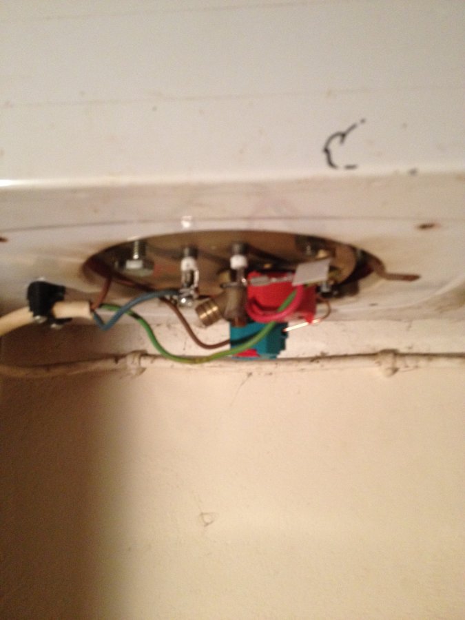

I have an heatrae sadia FBM water heater. recently, when the water is heating up, after its been on for 15-20 mins the water stop flowing. its starts to slow up and then stops completely.
any ideas on how to fix it?
any help would be greatly appreciated.
thanks.
i forgot to mention that after any where between 4 to 24 hours later the water starts to flow again. then once turned back on i get the same problem all over again
Have a look in the top - there is apparently a ballvalve there it's probably stuck.
hi Nige F, the ballvalve is ok, thats what i thought it was. do you know if there's something inside that would swell from heat? because thats what it seems like. The water heats up and the flow slows down and eventually stops. Then when i turn it off and it has had time to cool down the water starts to flow again.

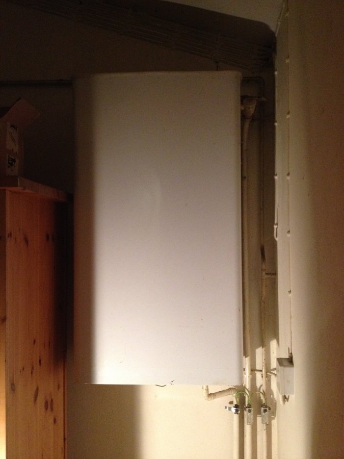

Hi simond, there's no blender valve. just mains cold to the top, an over flow and the hot water outlet is at the bottom.

ok, so i think i might have found the problem. the hot outflow pipe has 2 bends in it before it goes straight down and disapears into the wall. i can hear the water just trickling through as it fall down to the bottom of the pipe. would that be a limescale build up? i still dont know how that relates to the water getting hot and no water coming out? can i put descaler straight into a boiler?

ive been at the water heater all day to no avail. i drained it, took the element out, cleaned out the very little limescale that was inside (had the element replaced about 6 months ago). flushed the pipe from the ballvalve through to the water heater. i did it back up, filled it and the water was coming through great. about 30 -45 mins after i turned it on to heat, the water stopped coming through again. its like something is expanding with the heat of the water and constricting the pipe. when the water in the heater cools down the water starts flowing again. im pretty much ready to take the element out and throw that in the bath instead,lol ;)
ok, so ive narrowed the problem down, its not the boiler it the hot water outlet pipe. i took it off but there was nothing in the first length, im guessing its just after the first bend. does anyone no what it could be? its fine when the water is cold but stops when its hot. does limescale expand with heat?
lol, it wasnt the pipes :( . i put a small tap directly on the hot water outlet where the pipe used to be. when its heats up the water stops but if i open up the tap, pressurized air comes out followed by the hot water!!! any ideas?
