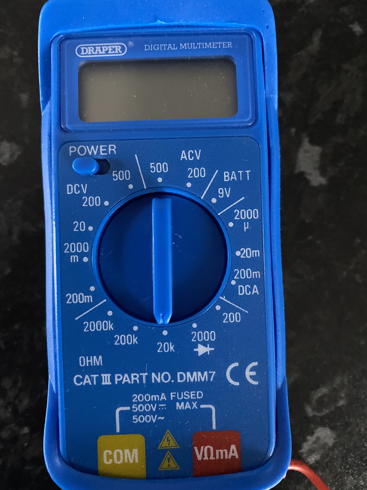

thsnks again John,
Iv got an amp multimeter which I checked the capacitor with but not sure if I had the meter set to the correct setting. I got a low reading on the capacitor of 0.30 but not sure if I had the meter set correct?!

Testing a capacitor with a multimeter isn’t as straightforward as it seems, unfortunatey.....I have my own theories but others will know better.
Here’s my disclaimer!!
My method - with the cap on the bench and disconnected from everything for half an hour, so it’s completely discharged......
Set the meter to high resistance and touch it onto the cap leads
Immediately set the meter to dc volts and there should be a reading which will reduce as the cap discharges.
Personally I’d replace the thing.....it’s the only way to be absolutely sure. The value is around 4uf I think.
John :)

Iv had to take the whole ignition out to get the capacitor unscrewed.. I’m not totally sure if my multimeter is set up for the correct reading so I’ll get the capacitor changed and see if that does the trick..
your multimeter doesn't have the facility to check a capacitor
Thanks I didn’t think it was right..
