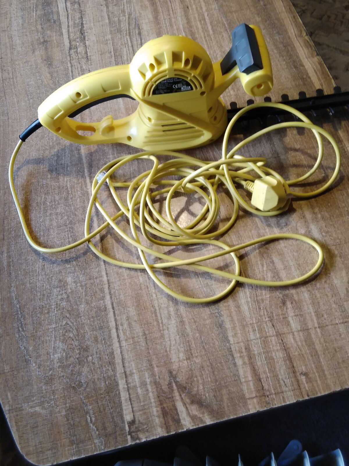

Good Evening All
Yes, another thread regarding Power Tool cables already within two weeks of a similar thread.
I have just been given to try/borrow a Hedge Trimmer from someone else (who I am quite sure did not perform the repairs illustrated shortly).
I would say the machine is no more than a few years old.

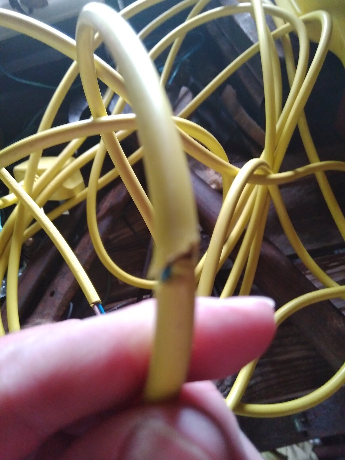

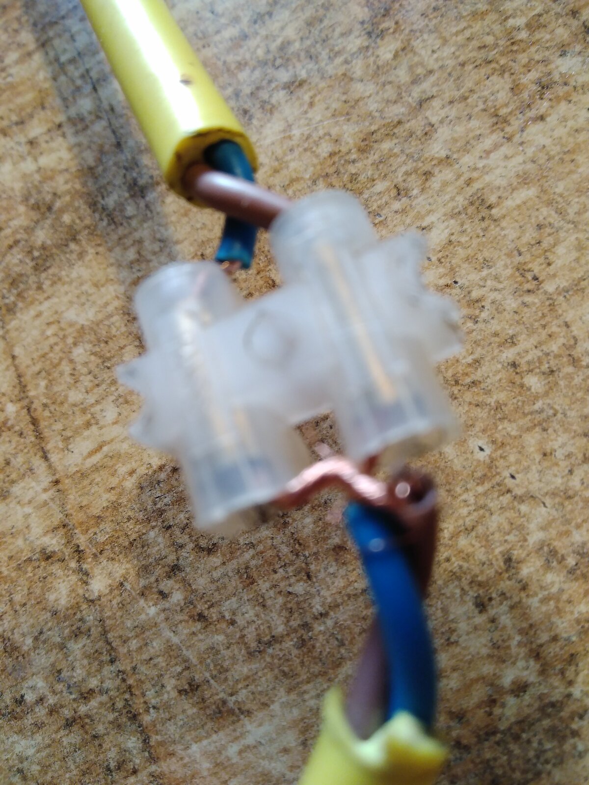

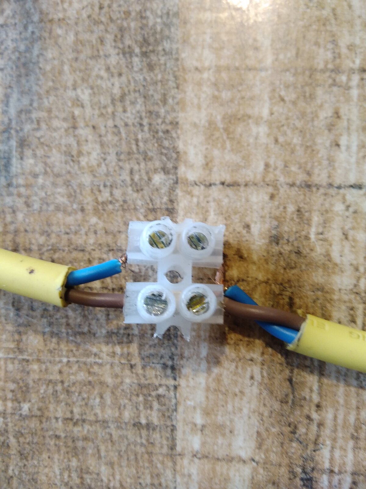

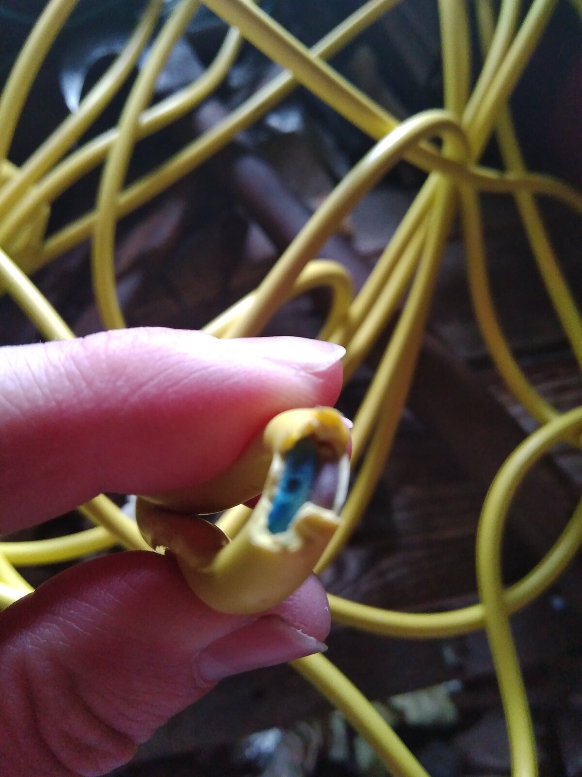

There are two sections of damaged cable within about a metre of each other, the cable cut been towards the machine end.
Anyway, enjoy the photos!
(Again though, it is something a lot of you would have seen 'many times over').
Regards

Jeez.
Looks like the whole cable is up for renewal then.

You can't really do that! Not without their permission. You should write them a letter explaining why it is dangerous and that they should not use it until made safe.
I would fit a Duraplug 2 pin plug and socket connector, the male side on the appliance a few cm away from the machine and the female side on a new length of flex with a moulded plug.
My late Mother in Law had a mower with a connection like picture 2 ( unknown to me ) it nearly killed her .....but for my wife hearing her yell and ran out passing the socket and switching the power off ( no RCD or whatever in the house! ) A nurse's / daughter's intuition ?

I couldn't get my head around was the way the closest cut to the machine was not in range of the blades.
I had a roll of 0.75mm² flex in the car and soon did a full replacement.
I have one fitted to my hedge trimmers. If I'm climbing a ladder and it snags on the way up it will, hopefully, simply pull apart without unbalancing me on the ladder. As my wife once said, it I injure myself whilst using it she can yank it apart without endangering herself. Mind you, it has an RCD plug at the other end so if I slice it then the danger would be isolated immediately.

That is what I thought, but experience has proved otherwise, often a hedge cutter can cut through its own lead without tripping the RCD, not sure how quick the lead is cut, but seems too fast for a 40 mS RCD to trip.

That is my intention, since the cable cut is fairly near the machine. However, cut the section of cable out between the cut bit and the repair and join with a two part connector, but re-using the long undamaged end with the moulded plug already attached (of course, I will check the cable thoroughly first to see if it really is undamaged and in a satisfactory condition . About 1 metre of cable will be lost, however the lead itself is not hellish long and would probably require an extension lead to be used most times in any case.

Head cutters are usually double insulated with two core cable. Cutting the cable won't trip the RCD as there no path to earth.
