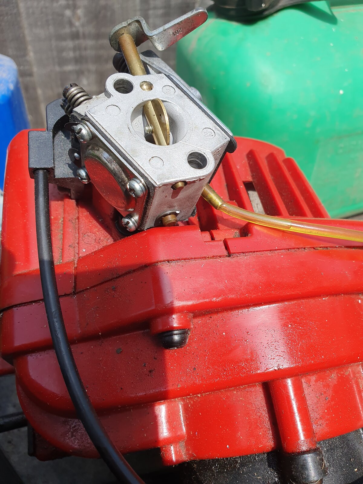

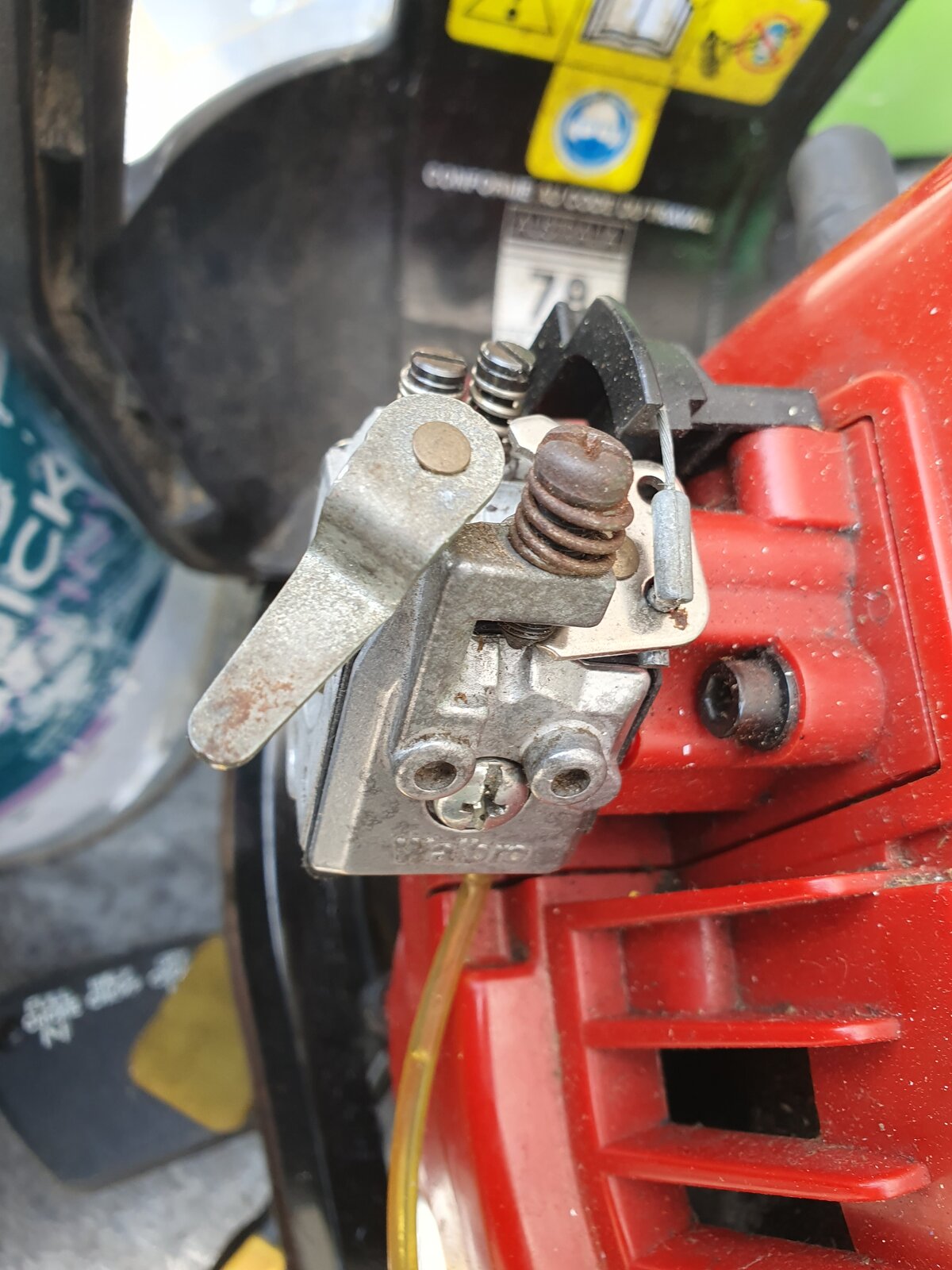

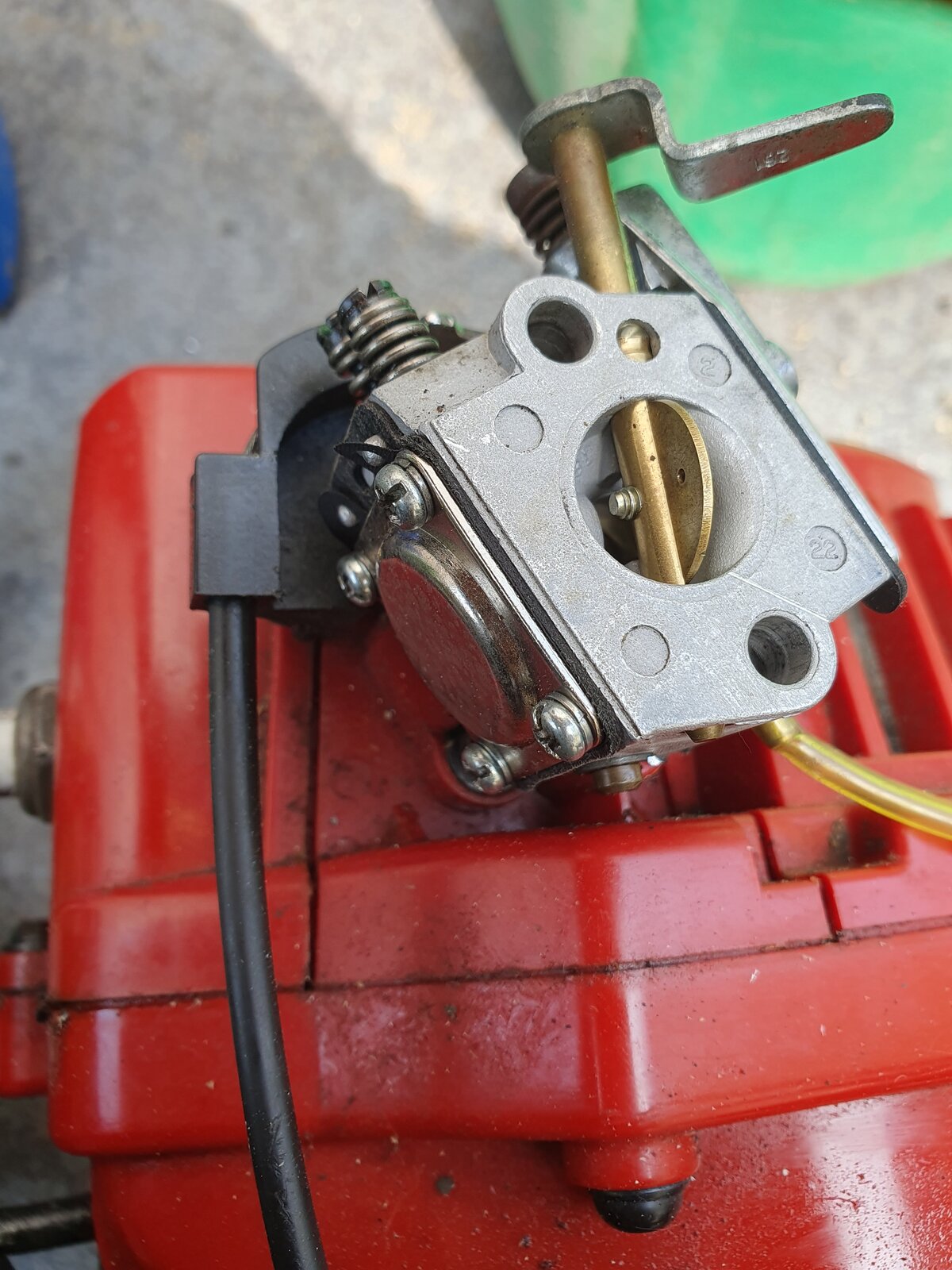

No numbers
It's a walbro carburetor
I'd say that is a very early machine, somewhere around 2001 - 2003.
Anyway, I'd try to track down a replacement carb now and here are a couple of numbers that may help.
530035306 WT-221
530069682 C1U-W4 (This one is a Zama equivalent).
Try ebay, Amazon or whatever
