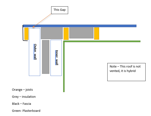

Height of outer wall, where should it end?
23 Jun 2018
74
Hi, I'm preparing for a flat roof which slopes to the front. On the side there is a cavity wall, and I'm unsure where the outer wall should end. Must it meet the bottom of the OSB deck (as illustrated), eliminatting any gaps with compo or does a gap not matter?
