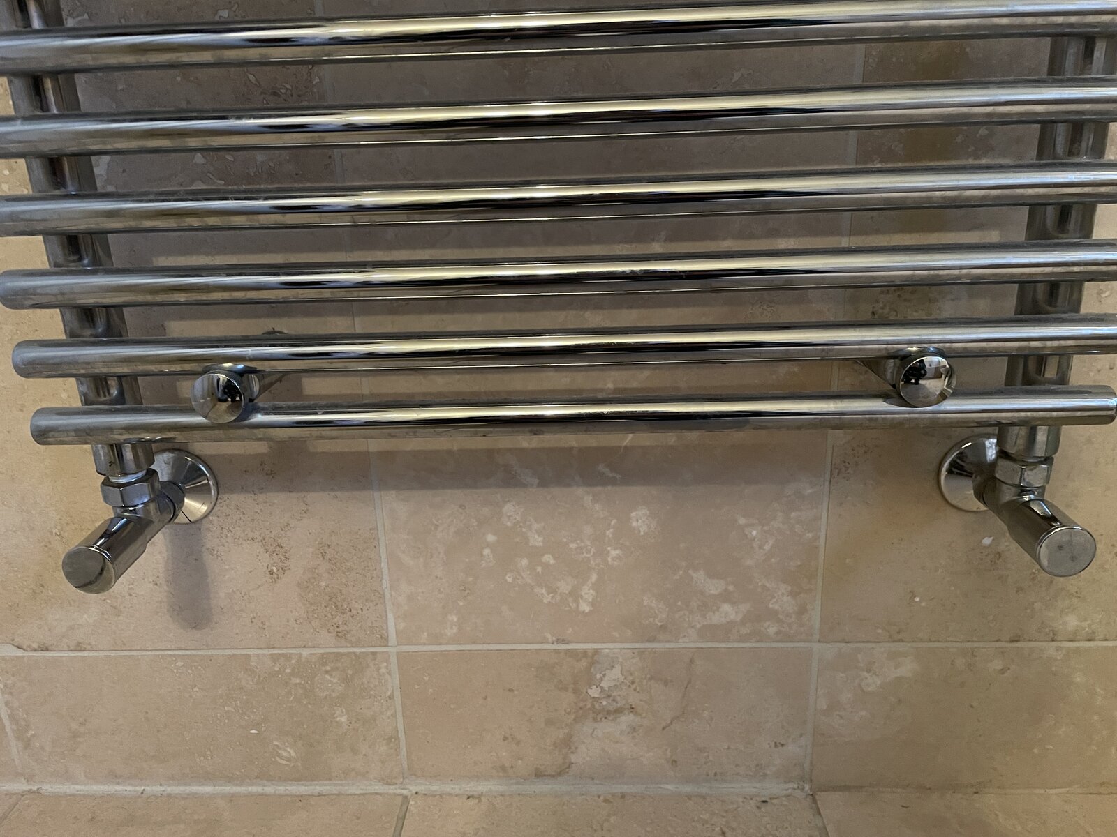

Morning. It’s that time of year when the central heating is turned on for the first time in month and inevitably problems emerge.
Initially the bathroom heater was just slow to heat but it’s now stopped completely. It doesn’t have TVRs though you can turn the valves to turn the water off and on.

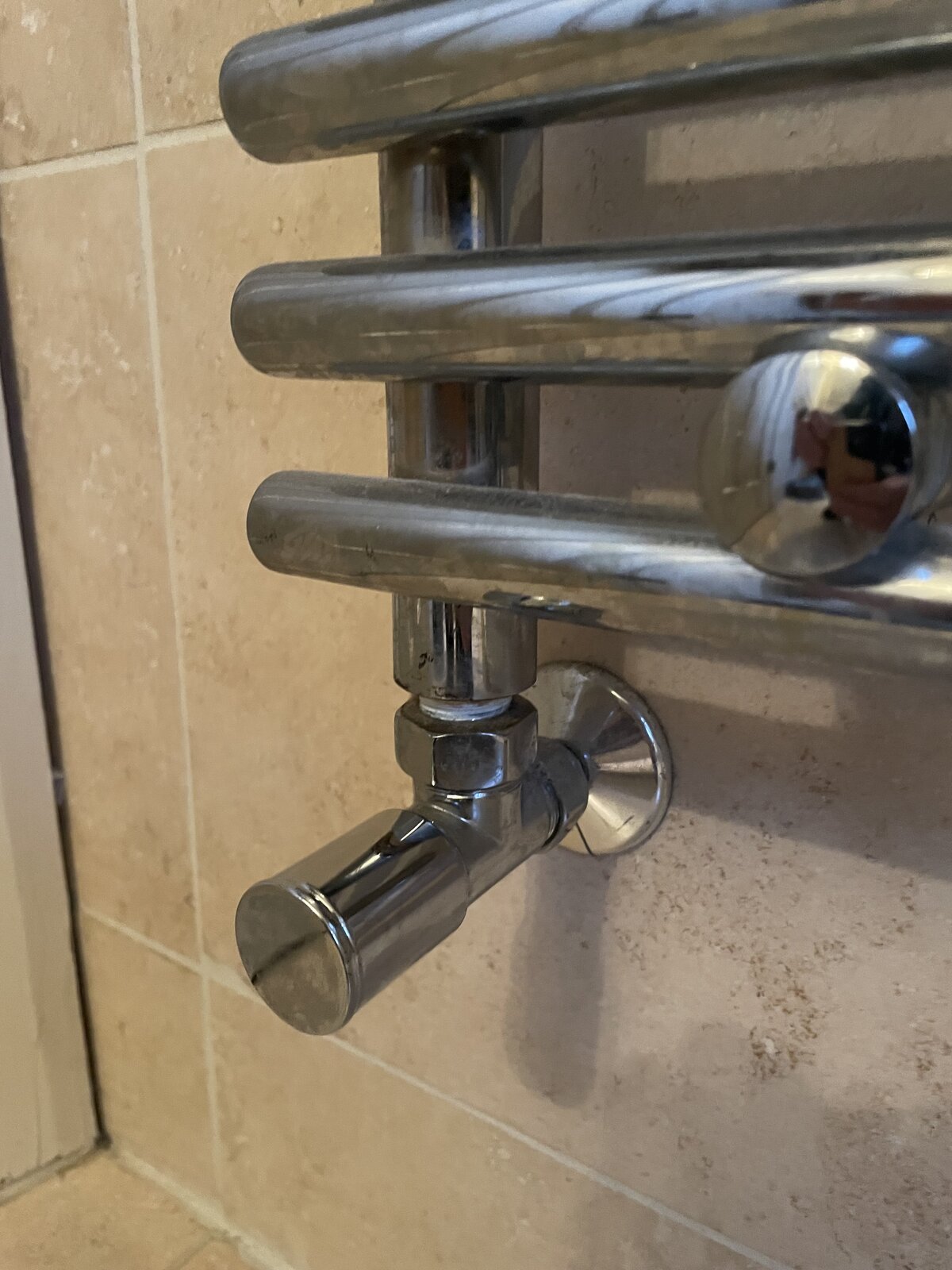

I’ve turned the valve on the left clockwise and anticlockwise (no effect) but if I turn the one on the right anticlockwise black water immediately leaks out so i have left it turned clockwise to the max.
I’m thinking that sludge has blocked the radiator and It needs to be removed and washed through.
This radiator has not been removed since installled around 16 years ago. The boiler was installed 5 years ago and the system would have had a power wash.
Any help/advice would be most appreciated before I call a plumber out.

If you've turned the valve clockwise, you will have turned it off.
Some of those valves can be repaired when they leak, if not, you'll have to replace it/them.
Have you tried opening it fully? Sometimes they stop leaking when fully open.
Not yet. I dare not open it but if I get a container under it then I can see what happens.
Am in contact with a Checkatrade plumber who’s saying power flush (£800!) which sounds like a default answer but expensive compared to others. He might be right- it’s been 5 years since installation
Find another plumber who will change the valves for you. Even if the system needs a powerflush (which is unlikely if the rest of it works ok) those valves will need to be repaired/replaced first anyway.

Not the best rad valves, they are prone to leaking. That being said, chances are it's just the gland that's passing because it hasn't been used in so long and either the O rings have failed or the gland nut needs tweaked.
As suggested, Checkatrade is a hit or miss affair and you are probably getting replies rom the ones that don't want a small valve change job but suggest the default powerflush, on the off chance you'll actually say yes, then it's quids in. As suggested they are a mixed bag on there from excellent to excrement but it certainly is pot luck by the looks of it.
Also as suggested, the valve(s) needs replaced regardless and if the other rads are ok then it chances are the system's ok and not be sludged up. When you bleed the rads, what colour is the system water that comes out , get half a whisky tumbler full if you can. (check the system pressure afterwards and top up as necessary)

Thanks for your comment. Funnily enough when I bleed the rad at the top it’s clear vs the leak at the bottom which is black!
Hopefully it is just the valves- to be fair they’ve last many years. Is there a particular brand /type i should look for ?
