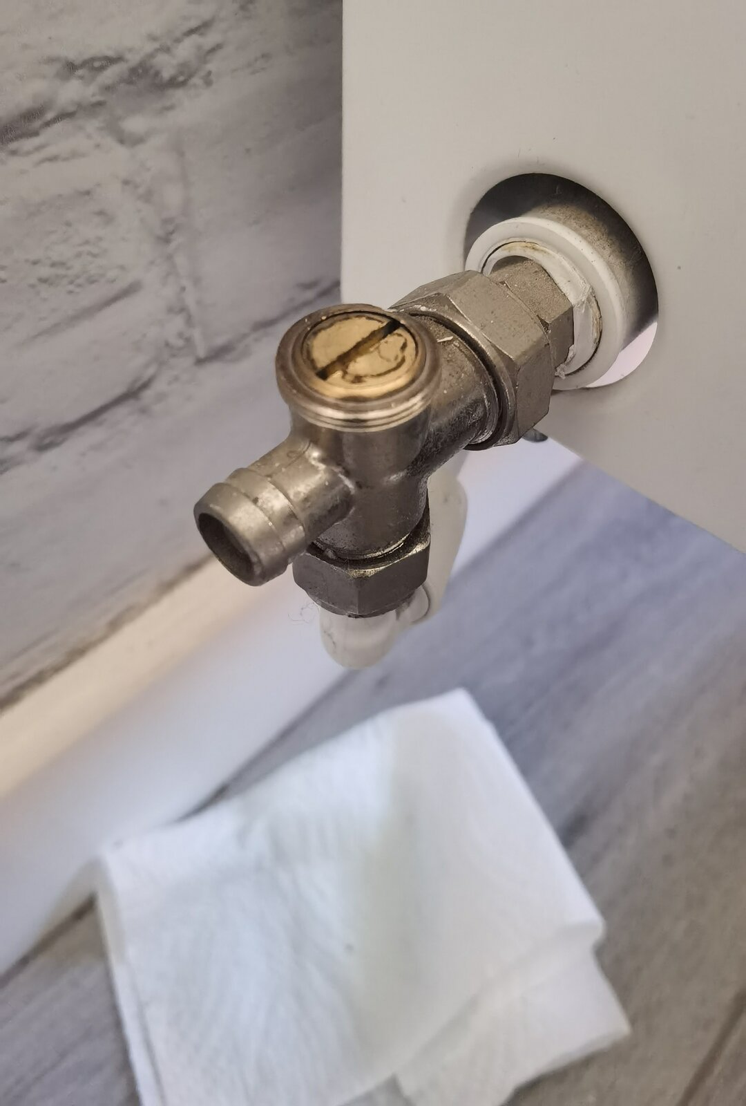

Radiators upstairs are on downstairs aren't
Time to call in a plumber ,your pump may not be circulating water.
We've got him coming Tuesday
He did send this
If you want to try more yourselves.
Close all the lockshields then open them all just half a turn
Turn on heating and go around the radiators. If they are getting hot leave them at half a turn open. If they are cold open an extra half turn. Wait 5 minutes check again.
Keep repeating this process only opening cold ones by half a turn each time and leaving the hot ones alone

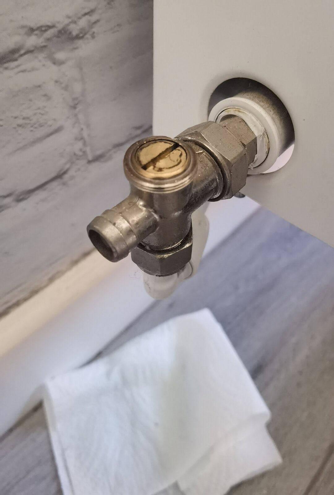

It looks fully open.
My plan was to get the nearest and furthest away hot then slowly turn the others 1/4 and extra so on.
I've fully opened it but still no heat, the pipe doesn't feel as hot now.
You can’t tell if a valve has stuck by looking at it, it will stick internally with no visible sign, repeated tapping of the valve body can sometimes free it .

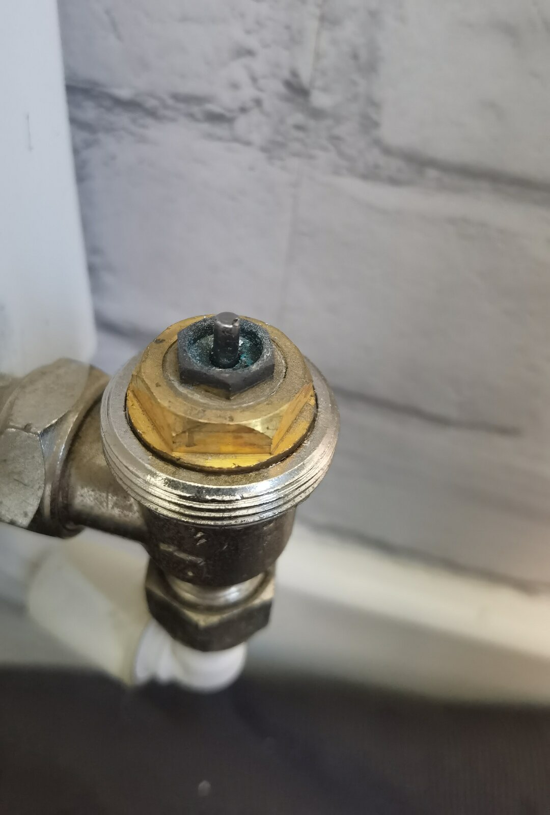

I could press it down and it looks like the ones which are hot.
I'm having another go this time just the downstairs living room radiator and kitchen both are heating up atm, ‍all the others are turned off.
So the kitchen and living room are now red hot ive just 1/4 turned the hallway and downstairs bathroom and there heating up
If it’s jammed shut the pin can still move freely .
Success there all on again.
I did give the pump a few taps of encouragement.
Will test it again tonight
Thank you for all the help & advice ❤️

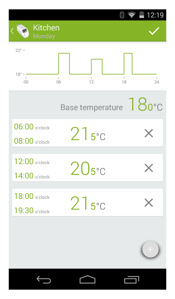

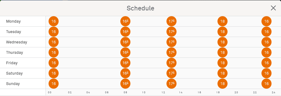

The control on the electronic TRV allows this 1763726270814.png the temperature can vary by the hour or the day, all set with the two buttons and the button dial, so rooms are not as warm when not in use, we want the room to be heated, so it can recover quickly, but not as warm when not in use. I will admit easier to set with the phone, 51RAAw1+hEL.jpgbut it does not need the phone, it can be set without it. The problem is, unless the boiler is running, the valve will not cause the radiator to heat up. Setting the wall thermostat to heat and cool in stages 1763726779403.png can help, or fitting multi-thermostats in parallel. The latter is what Wiser allows.
You can get wall thermostats that allow programming of several different temps for different times of the day. You don't need programmable TRVs to achieve this.
This is how we get the boiler to fire, but basic the TRV stops the room overheating and the wall thermostat stops it getting too cool. So both need to be programmable. No point in only one.
