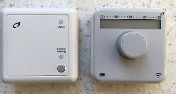

As off a couple of hours ago, our WPT1 central heating programmer has stopped working. It has constantly message "Welcome - Reconnecting..." but does not connect.

From memory, I think the WPT1 is a battery operated programmable thermostat and it communicates with a remote BR2 receiver. If so they will be similar to the picture below....
....pressing the button on the bottom right corner of the receiver should start the heating and the light above the button will be lit.
A bit obvious I know, but have the batteries in the thermostat been replaced recently?
Your thermostat might look a bit different, some have a bigger display and 3 buttons below the dial, but I think the receiver for both types is the same.

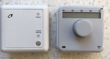

It actually looks different to the one you sent pictures of.
Ii is one on this link https://www.amazon.co.uk/BRITISH-WIRELESS-PROGRAMMABLE-THERMOSTAT-WPT1/dp/B077517N61

That is correct, there is a receiver that is wired to the boiler and the thermostat tells it what to do wirelessly. The receiver photo you posted in your link [copied below]....
....that you say is the same as yours, is also the same as the photo I posted earlier, where I also told you what to do to overide it and switch the heating on.
Pressing the button on the bottom right corner of the receiver should start the heating and the light above the button will be lit.

Thanks everyone! The issue was with the receiver in the boiler which needed resetting..... And the reset was to switch off the mains then switch them back on. In this instance anyway.
