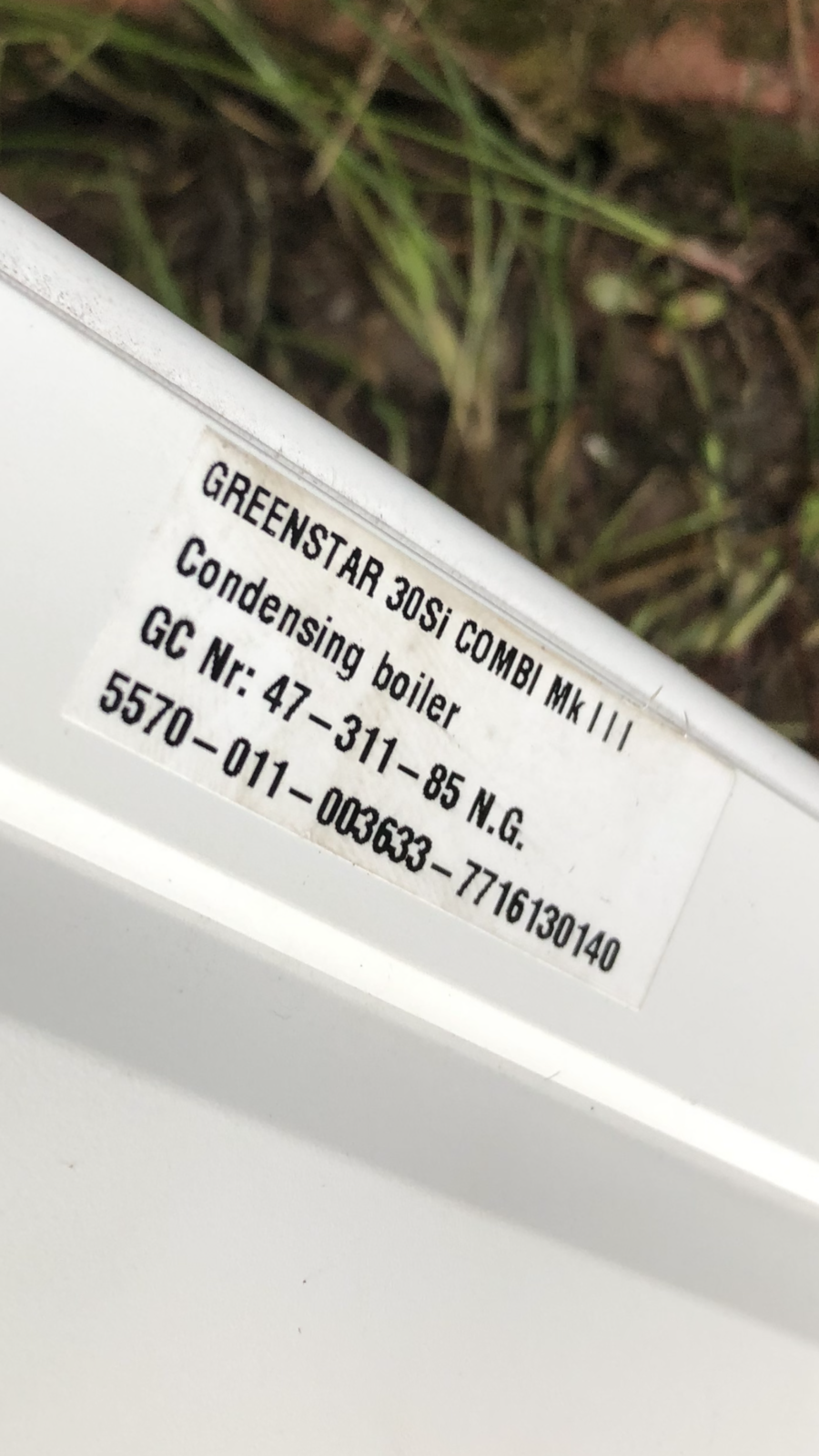

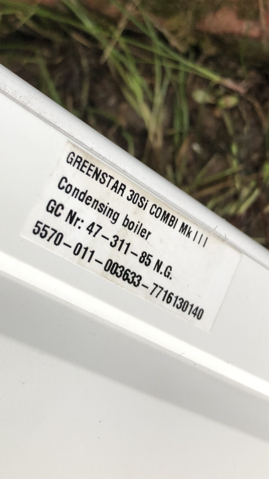

Help !!!! Combi problems
Isn't the 30Si a system boiler?
Perhaps you could start again and describe the problem in more detail.

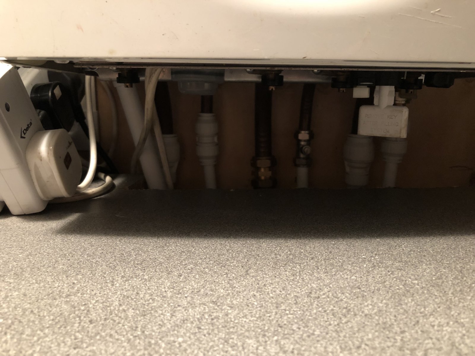

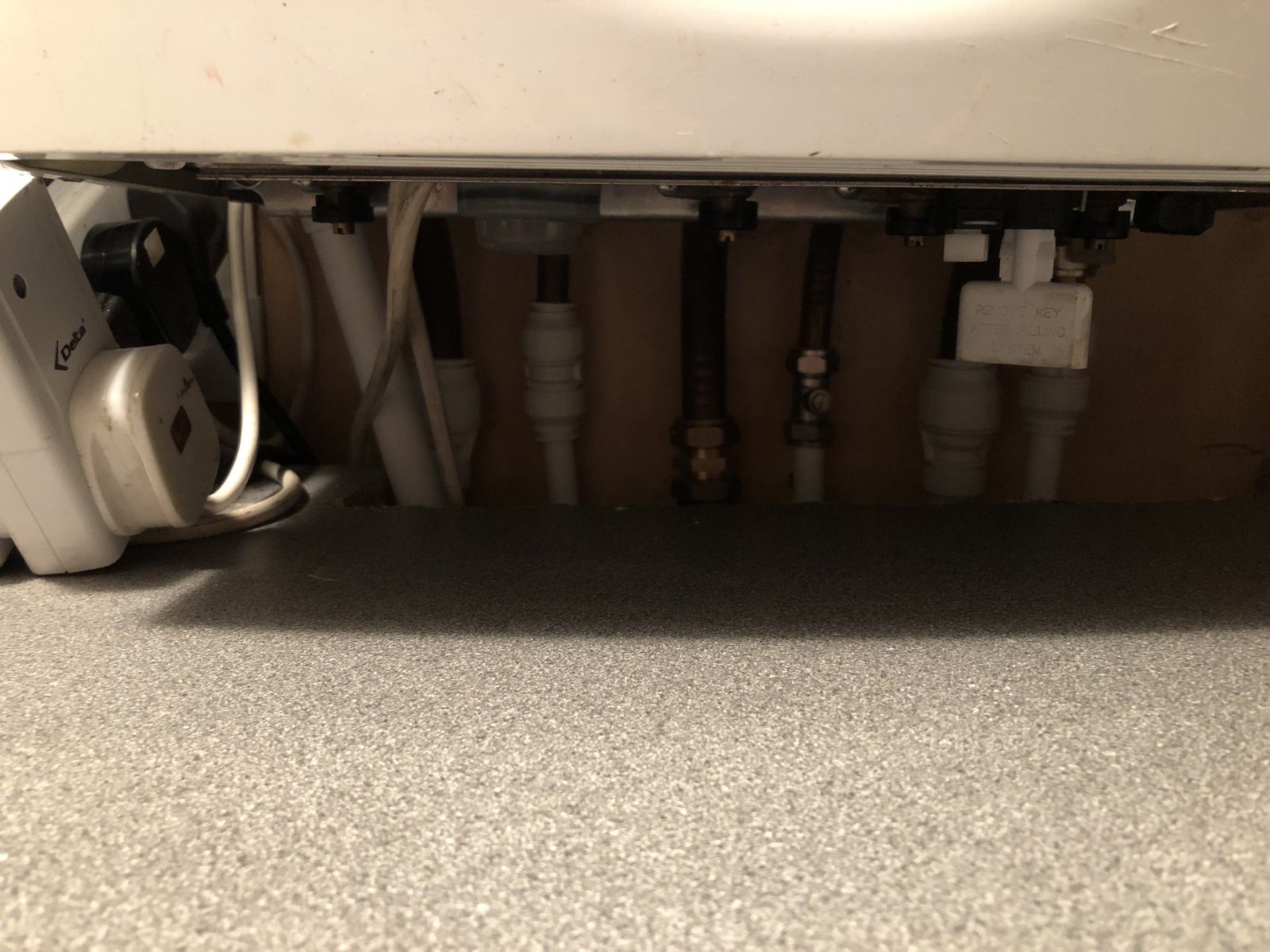

1. How many copper pipes come out of the (bottom of the) boiler? A photo or two maybe?
2. Do you have a timer for HW and CH?
3. Do you have a hot water cylinder?
4. What actions do you take when there is no hot water, and do the actions you take restore hot water flow almost immediately?
5. When it does run, does it continue to run/fire the whole time you are drawing hot water?
Hi. I’ll put some pics up. The pipes coming to/from the boiler are as follows. Rad feed in and out. Mains cold in and hot water out and gas.
We don’t have a tank
When it does fire up it’s only for maybe 20seconds. This gives me a little hot water and then the residual from the heat exchanger
