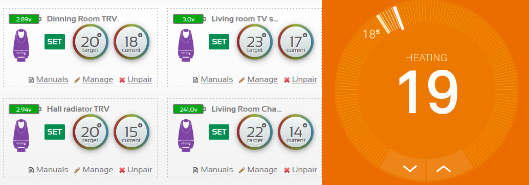

Some of my electronic TRV's show both target and current, Heating not keeping up.jpgso if the current during winter exceeds the target, then the lock shield needs closing a bit, and in mothers house once set, each room was spot on, except where the sun through bay windows caused the temperature to raise.
With linked TRV's this is not so much of a problem, as does not matter what temperature the wall thermostat is set at, but in winter only time boiler should switch off is when there is a change of target temperature, the whole idea of a modulating boiler is it does not keep switching on/off, until it can't turn down any more.
If a wall thermostat unless a modulating type also, turns off the boiler, then when the boiler is turned on again it does so flat out in most cases, doing this three times a day when there is a target temperature change is no real problem, but doing this 24 times a day wastes gas.
OK I know there is a thought that switching off the pump saves energy, but unlikely to be as much as allowing the boiler to modulate as it is designed to do.
