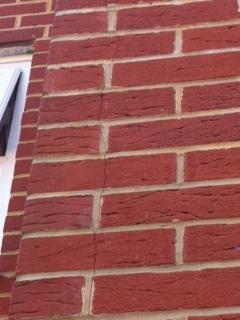

Hi everyone!
Im new to this forum but was hoping for a bit of advice and possibly peace of mind for me?!
We have just noticed a crack running from just under our roof and it runs vertically right down the side of our house about half a foot from the edge (one story, end terrace approx 12 yrs old)) its not a very wide crack but its at it widest at the top then getting thinner and thinner until it can barely be seen but this stops about a foot above ground level. Should we be worried? No idea how long its been there for, Im guessing 3 or 4 years at the most.
We are currently in the middle of a part exchange and may be having a homebuyers survey done soon I think, as our house is over 10yrs old...just. Is this likely to be brought up in this?
Please some advice would be most appreciated!
hollylulu xxx
It sounds like settlement.
Is there any evidence of this crack on the internal walls?
What material is outside of the house finished in?
Can you upload a picture of the crack?
Vertical cracks, especially near to corners and one side of the wall only, are normally thermal cracks - ie expansion/contraction of the wall.

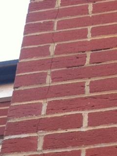

Here are the pics ive taken (hope it worked) the crack looks like this from the top going down to the bottom but it gets thinner and thinner towards the bottom of the wall.
The first pic you can see our next door neighbours house (we are end terrace and our house juts out further than next door)
Its a Barratts home, red brick built approx 1999.
Any advice much appreciated!
hollylulu
Yes, as per post nr 3.
Those soft bricks soak up water like a sponge and rapid drying causes this type of crack in this type of location.
Structurally is not a significant problem, but would/should get picked up and chances are the surveyor will refer this to a structural engineer who will then propose cutting in an expansion joint
