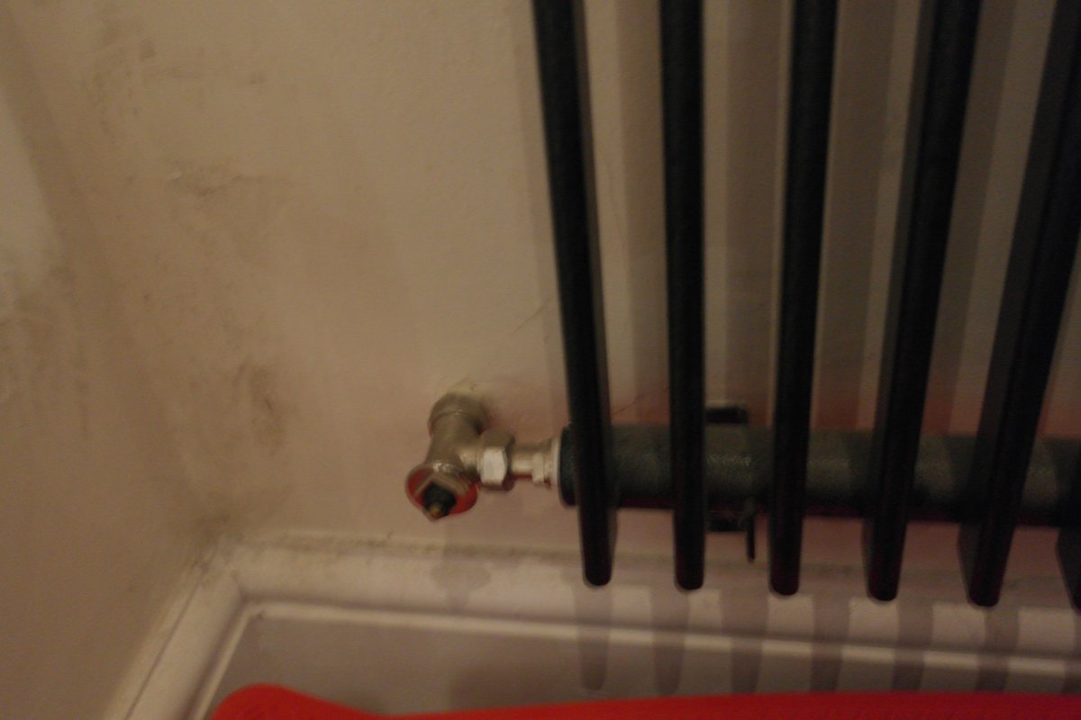

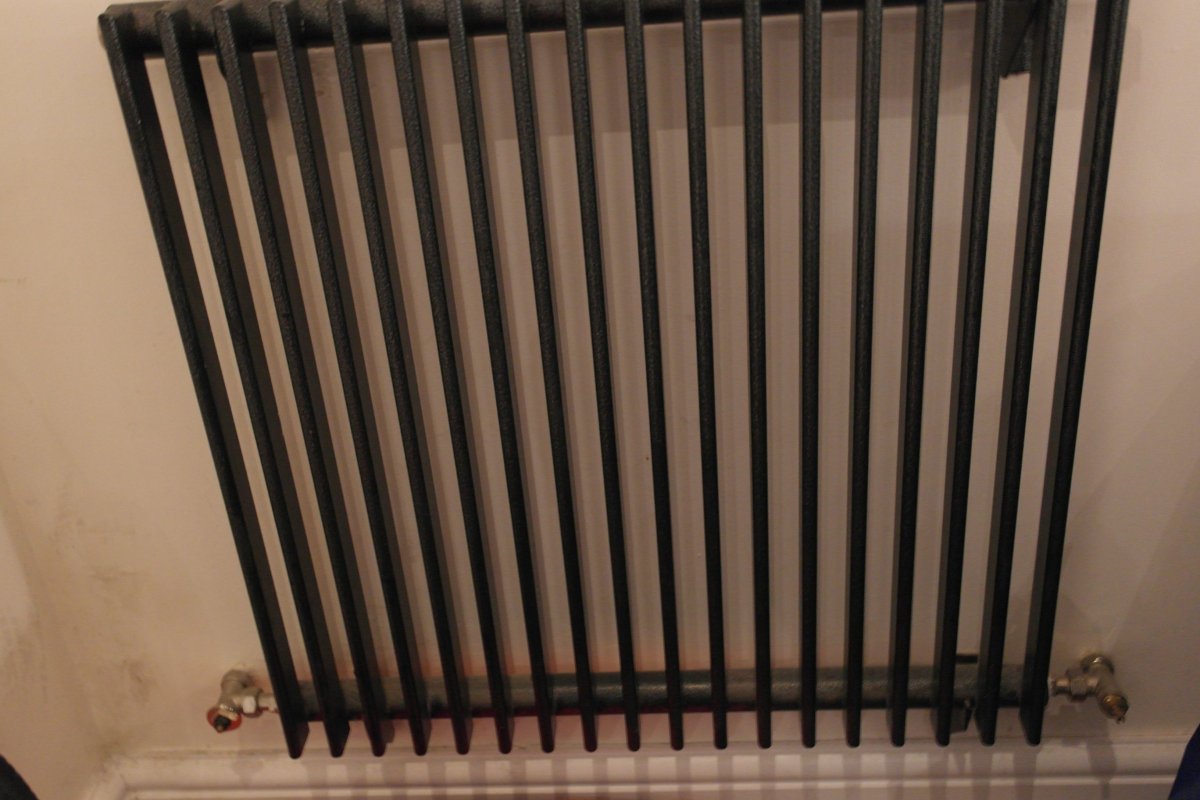

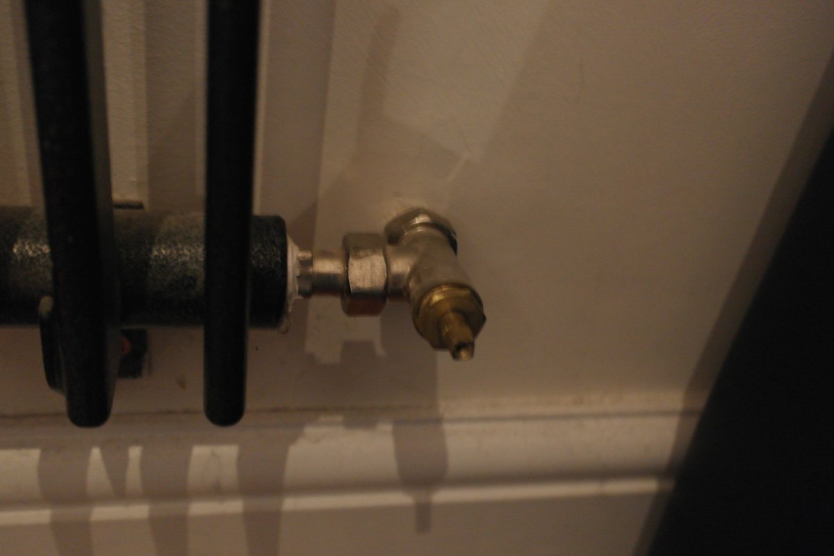

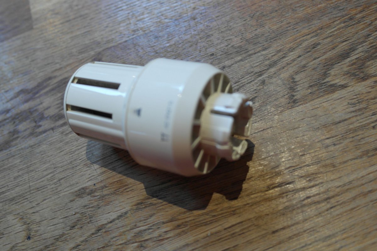

Sorry, they do actually have TRV's, but it looks like they are missing a connector so we have never been able to use the TRV's. I have posted some photos for you to see which may be easier. Just to confirm, to make sure it is fully open, do I turn the black nut on the left hand side anti-clockwise until it goes no further?
Don't turn anything on the left-hand side, depress the pin to check that it moves in out out freely (only a few millimetres). Fully open the lock-shield on the right-hand side by turning anti-clockwise.
Newboys right in telling you to just test the LH (trv minus head) to make sure it's open, but you want to adjust the lockshield on the right hand, and start it at half a turn, and then open it up in quarter turns till you get the heat output you want. It almost sounds as though you may have had a microbore system, and there could well have been a blockage in it; and if that's the case, then it's actually possible that BG's powerflush may have cleared things - just an expensive way of doing things. If the rads are now up to the required temp, then don't worry about the pump speed.
