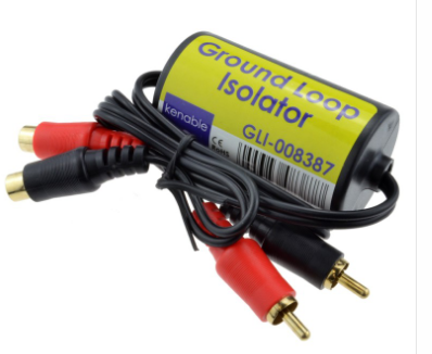

This is your friend here ......
At least in terms of being able to electrically 'separate' the parts in order to work out what is happening.
