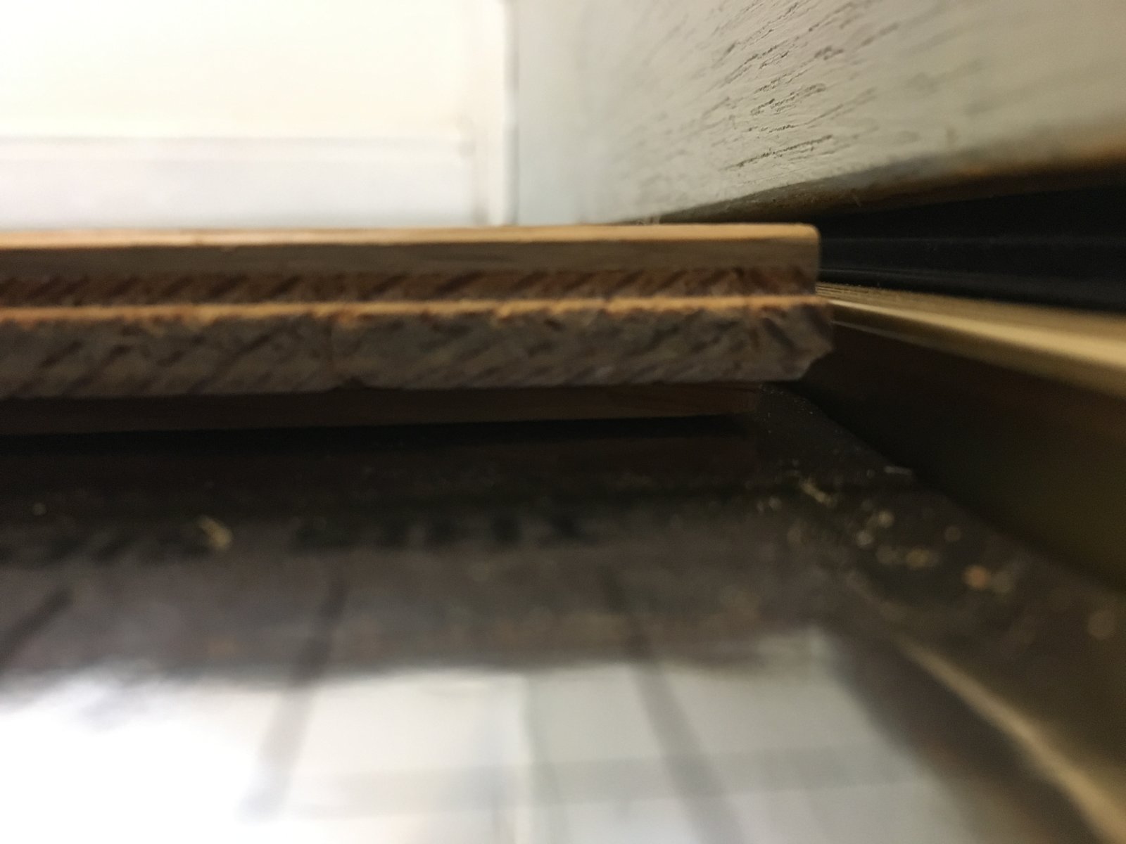

I am fitting engineered flooring and at the doorway I have a problem, the wood + underlay is a few mm too tall to fit under the existing entrance threshold lip. See the attached file.
What do I do?

Cut some of your new flooring to fit the gap your talking about but plane it thinner to fit.
I'm assuming a bit because the image isn't too clear.
We could do with a picture from the other side as well, and with the door open. What's the gap between the floor and the door, and can you trim the bottom of the door off.
How about creating a well for a mat? You can get coconut matting cut to size or buy a suitable mat and make the well to fit using either wood or a metal trim?
I have a hardwood floor by the front door and it needs a mat anyway

Is that an aly threshold?
If the door doesnt clear, find a thicker aly threshold and cut the door down assuming its timber not composite.
If the door does clear, then you need an oak trim with a chamfer to take up the discrepancy and somewhere for the floor to butt up to.
Mat well is a brilliant option and one I might have in mine. I've put off the laminate fitting to the hallway to avoid having to trim the main entrance door, so I might explore the matwell option myself.
But is that engineered, or solid wood, or what In either case, cutting a mat well will weaken the wood that's left, and if it's engineered wood, the backing board is a sod to work with. I'd trim the door, and leave the floor well alone.
no matt well normally same thinkness as floor so cut around or starts 600 or so away from door
that door looks composite but can still be cut and raise threshold
