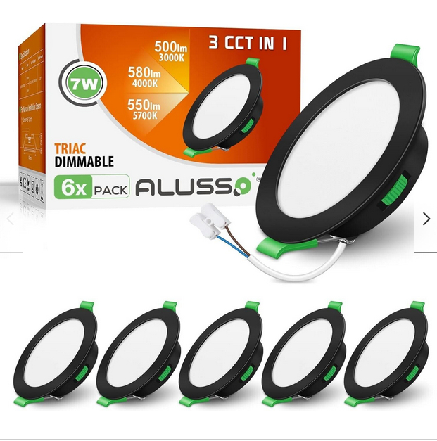

So We're at final fix stage. Had 8 of these spotlights installed as we don't have much void and we like the look of them being flush:
ALUSSO LED Recessed Ceiling Lights, 7W 580LM LED Downlights Dimmable, 30MM Ultra Slim Round Black Spotlights
Wanted a black gloss smart dimmer switch so we installed this BUT we are getting flickering which is noticeable at 15% -20% dim
Have tried an alternative smart dimmer thinking it was that but no joy
I have also tried installing these Anti-Flicker LED Adaptor Module but they don't work:
Also tried this Varilight Glowfix load regulator :
I'm guessing I need to find compatible set here but can't find anything that matches the dimmer smart switch and the LED spots
Any ideas anyone?

However now if I want to dim I use smart bulbs. It is simply too much hassle to dim LED lamps. I found these 1697291150166.png on ebay, and I look at the connection block and think that's not permitted, and 7 watt and 580 lumen is over the 75 lumen per watt minimum permitted but still not very good. But is says "compatible with trailing edge dimmers" and there is a mobile phone number so phone and ask what dimmer they use.
Personally I would use either GU10 or GX53 if surface mount required. Although not seen any smart GX53.
I"ve already contacted them and their support isn't great, just waiting for more clarity.
