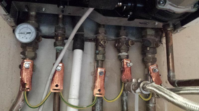

My water pressure has dropped and I cant see how repressurise it. The silver pipe is attached and doesn't seem to be a filling loop
That silver pipe is indeed your filling loop. Turn the valves on using a flat bladed screwdriver in the slot on each valve.
