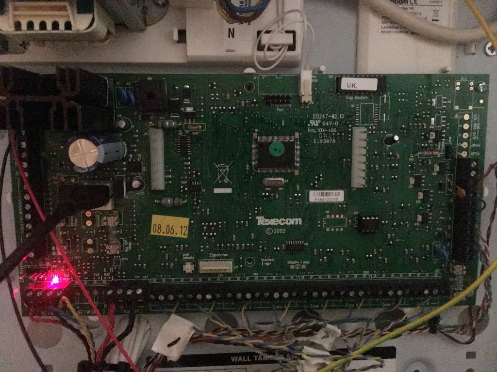

I have recently purchased a commercial property which has a Texecom alarm installed. Is it possible to identify the type of panel from a picture? I have some experience with Texecom having installed one in my house a couple of years ago so would like to get it working.
Cheers...
Its a Premier 48 by the looks of it.
Press Menu then 4 on the Keypad to display the exact model & software version. Press Reset to go back to normal.
Thanks. Does that differ from a Premier Elite 48?
Thanks once again. I tried to connect to the panel using Wintex but it won't connect (wrong panel type or UDL password). For the UDL password I used the engineers code that was given to me (and works on the keypad). Is it possible to default the UDL password?
Thanks - 1234 doesn't work. Is it possible to reset the UDL password back to 1234?
Eng code.....will say yes to zone setup ...press 7 yes ....( digi options ) arrow down untill UDL options....press yes ....arrow down until you see UDL password
