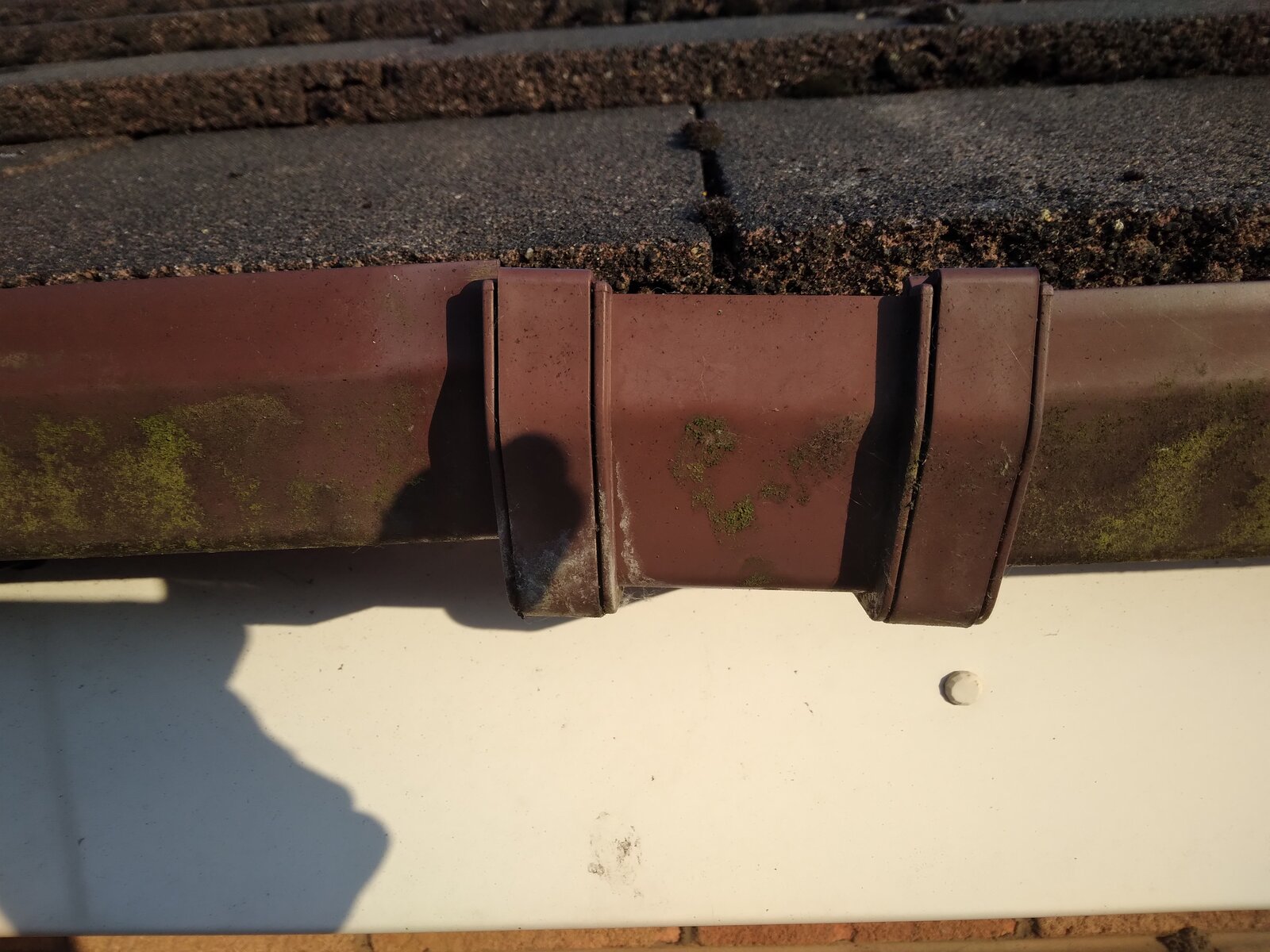

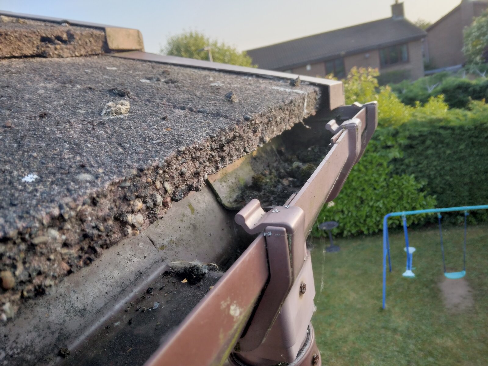

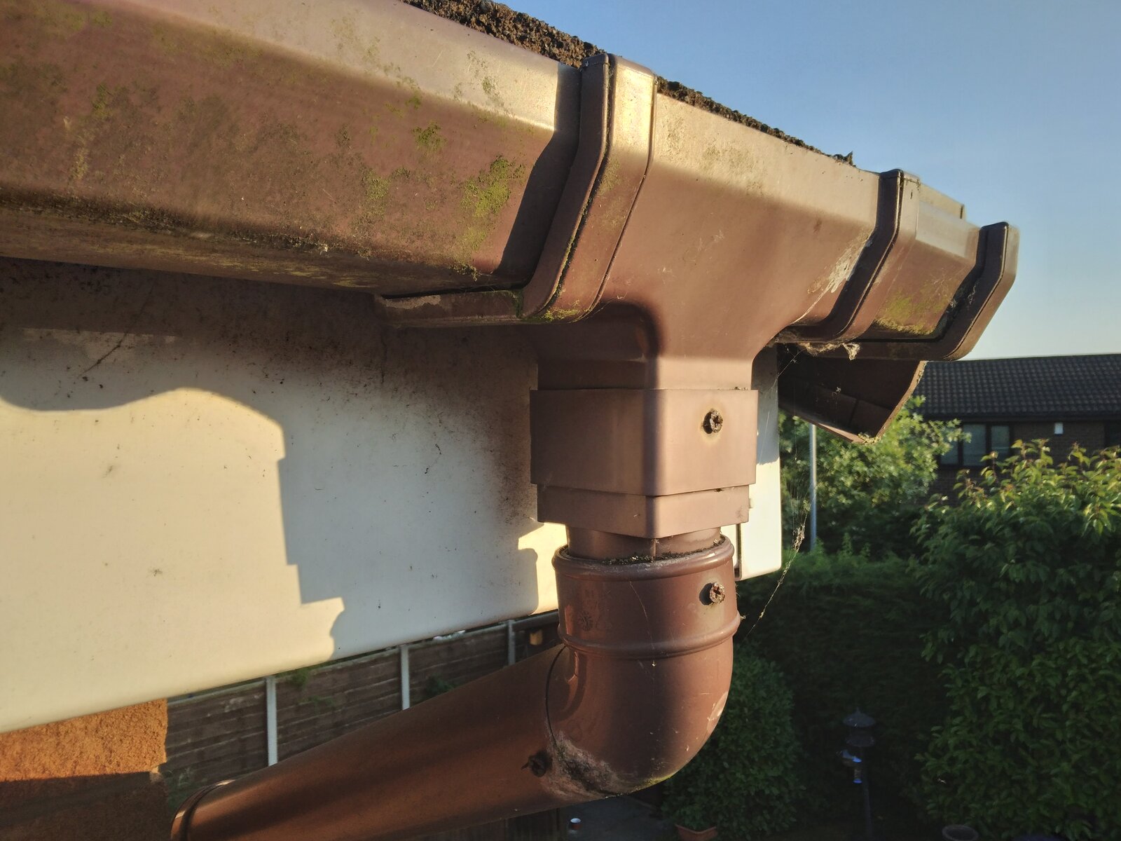

The gutter on one side of my house is leaking. On inspection, it was found to be from an inline joint that I suspect, was installed too short with the gutter barely reaching the seals. I want to replace one part which is easily accessible, this time making it the correct length, leaving the other part alone as it is harder to access. So the new gutter would have to be the same brand. I'll be getting a new joint too.
It has 5 faces to it, I believe this is called a square type. I measure it to be approx 115mm across and approx 57mm deep. It is brown and around 15 years old although I have some that looks identical on a recent building only 3 years old, so I'm hoping it is still available so I don't have to replace the whole length. Looking through some suppliers, I can see that Screwfix have a brand called Floplast, could this be it? I've attached a couple of photos.
Thanks in advance.

Could be a few, iirc Hunter did one similar too. Any markings on the underneath of the union?
Look up compatibility chart. You will find all the sizes so can work out what it might be and what will match up. Then find a fitting local to try..
Normally a brand is printed on ever part. Take one off and look inside and out.
It look like there is something printer on the round elbow - however it could just be a date stamp.
