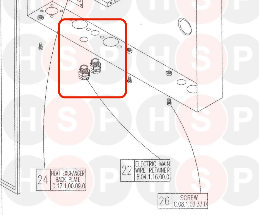

Actually the engineer is wrong, on looking at it a bit closer the C55 doesn't actually have a grommet in there, it should come with 2 cable retaining glands and they are available for £2.48 each, is that also grounds for a complaint too, given the part stated as missing was mis-diagnosed??
https://www.heatingspareparts.com/boiler-diagrams/keston/keston-spc-c55/23099/41-min-930-min-09 - item no 22

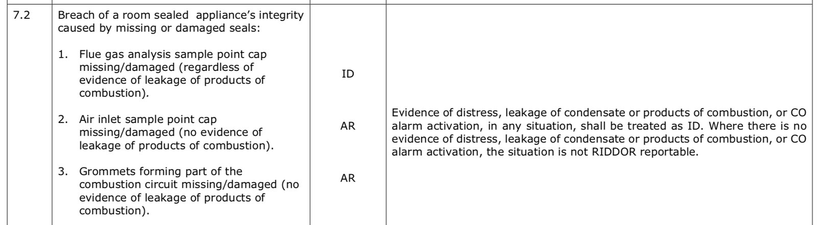

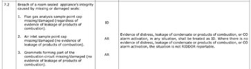

As per @Madrab, was permission obtained by yourself to disconnect from the supply? Unless there’s evidence of fumes/CO, then It’s classed as at risk only and still needs your permission to turn off, if you refuse then usually you sign a warning notice to take responsibility should something go wrong. It seems as though parts are available, so it can be fixed if this is true.
They can't turn the boiler off unless you give your permission. They are technically correct in that that hole should be sealed, but it's not a massive issue. Worth thinking about the future of the boiler though, a lot of parts are now obsolete and some of those which are available are very very expensive
