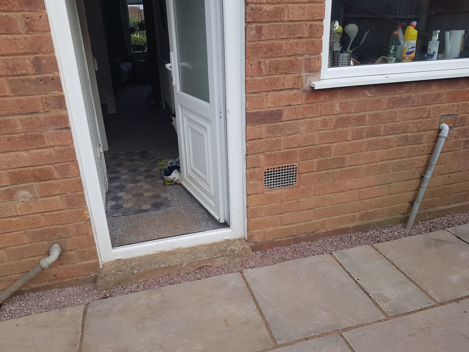

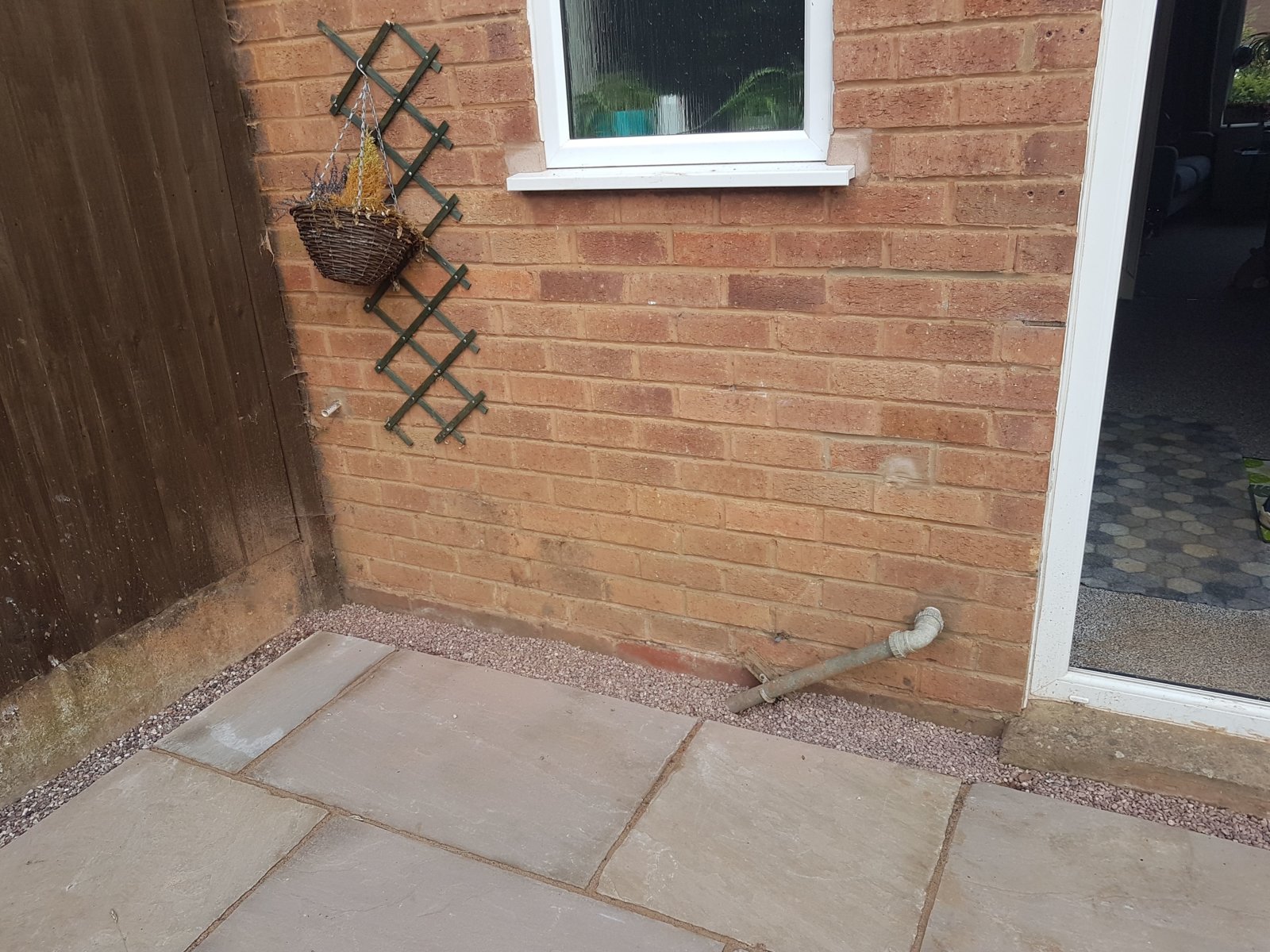

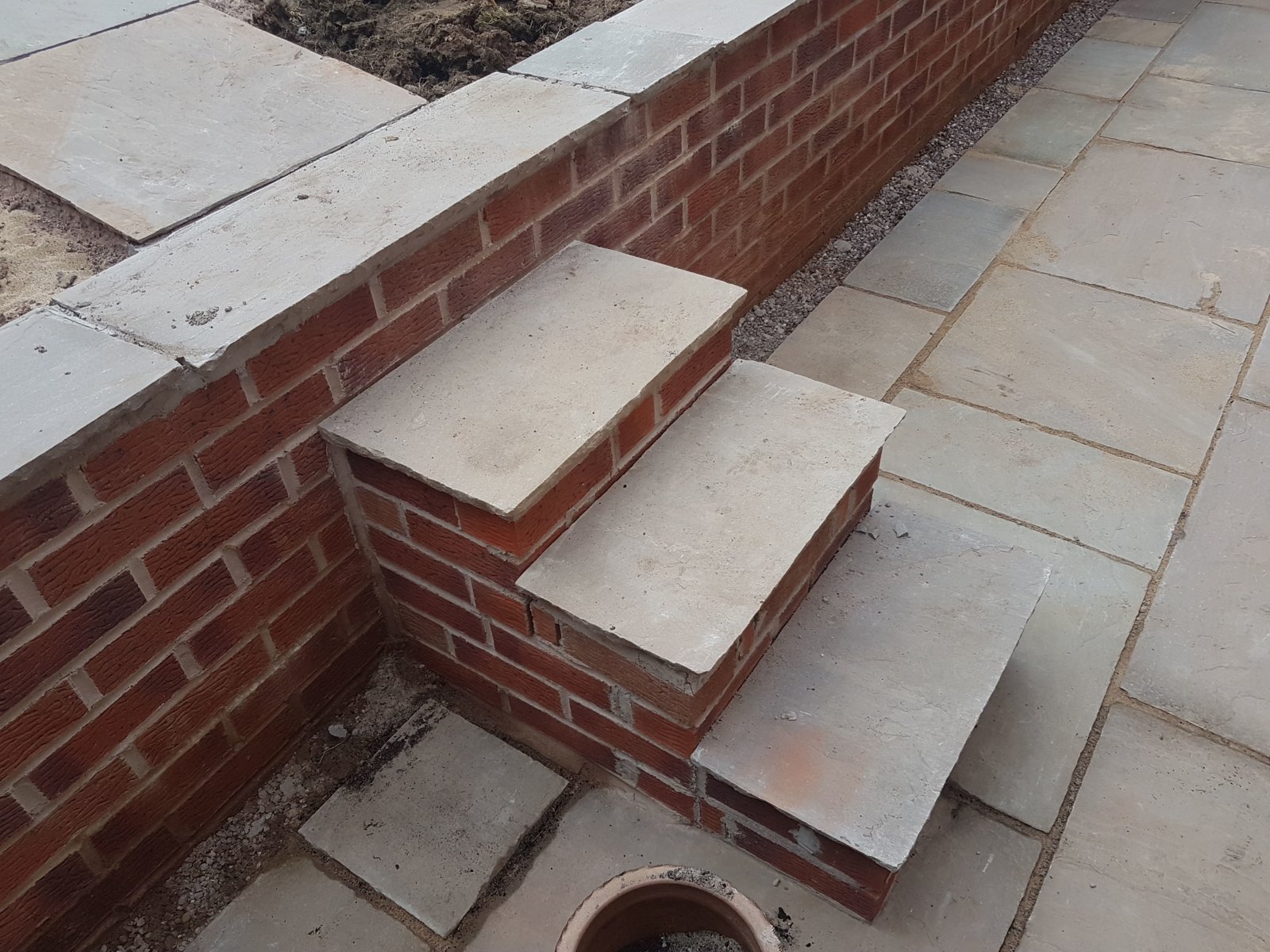

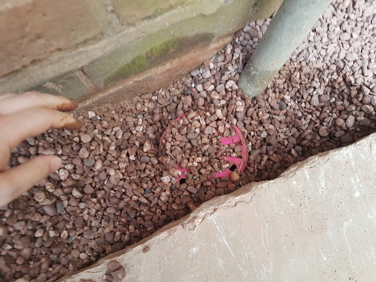

Thanks for the reassurance. I will post some pictures of the bottom here. We have paid roughly half for materials, but not for labour. We don't intend to pay until the work's complete anyway, and I understand I'm in within our consumer rights to withhold until it's sorted and I have to allow the builder to complete the work to a reasonable care and skill.

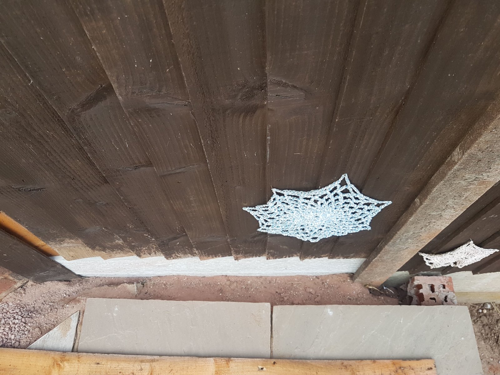

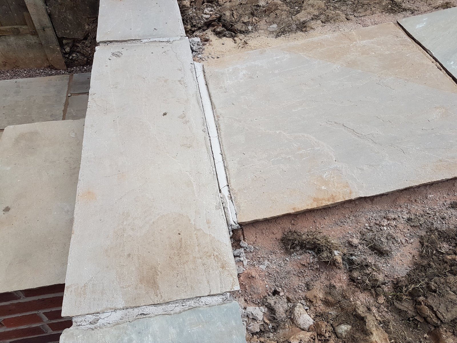

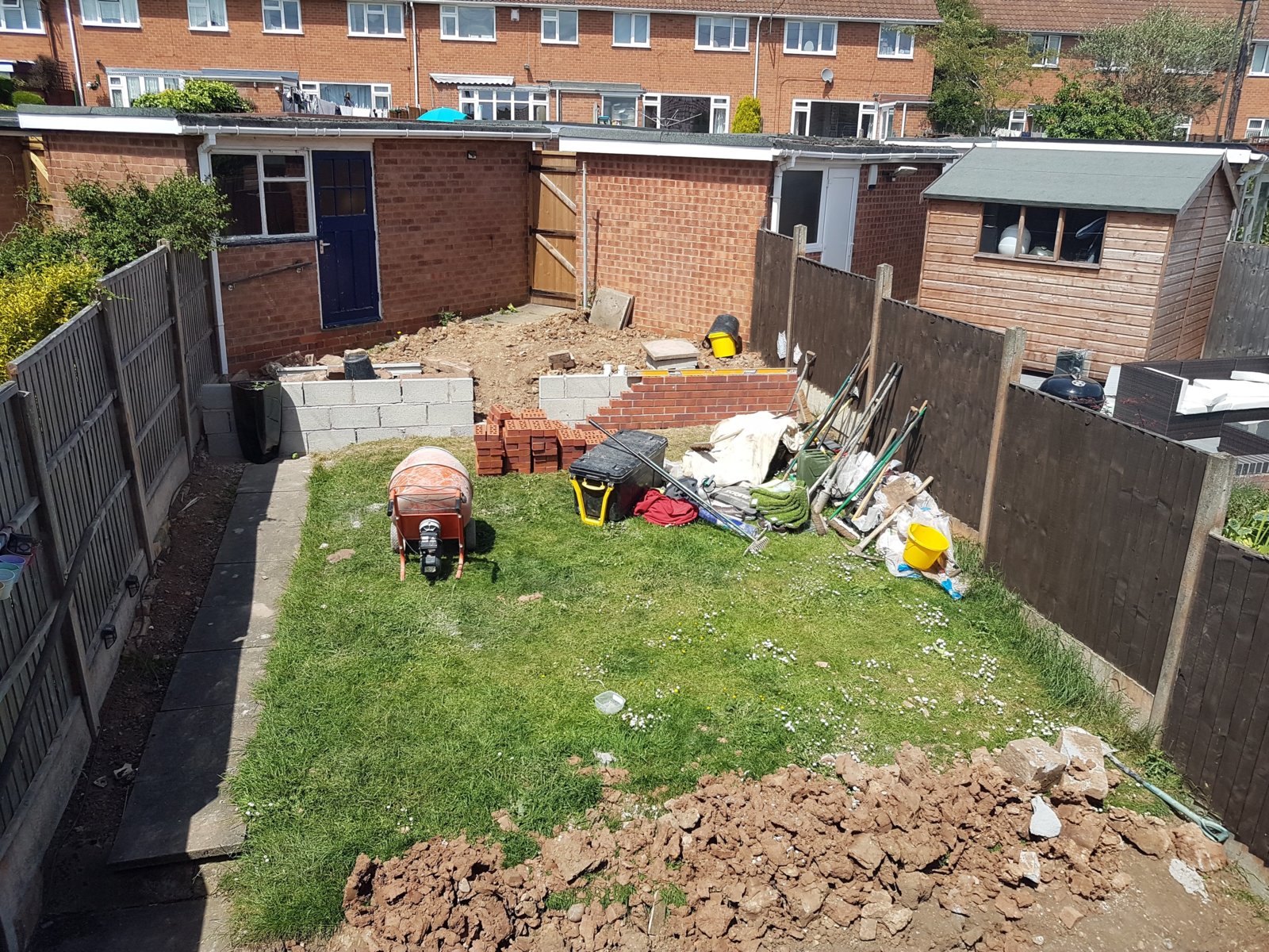

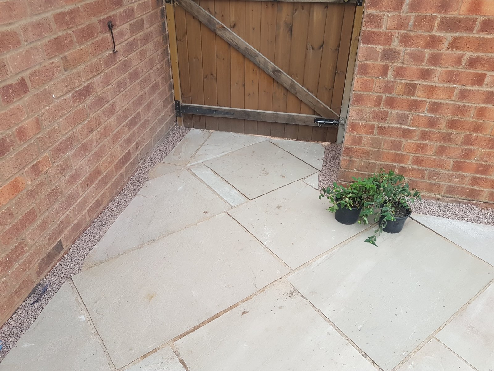

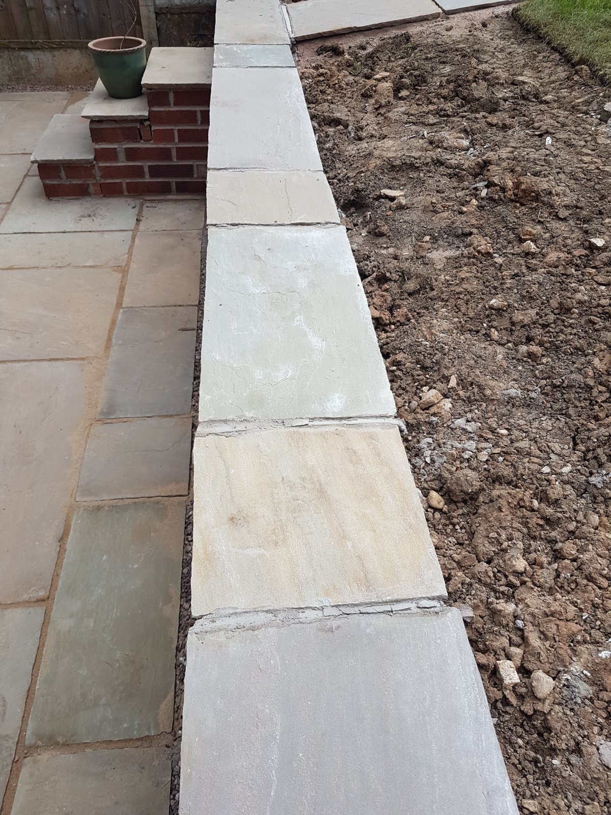

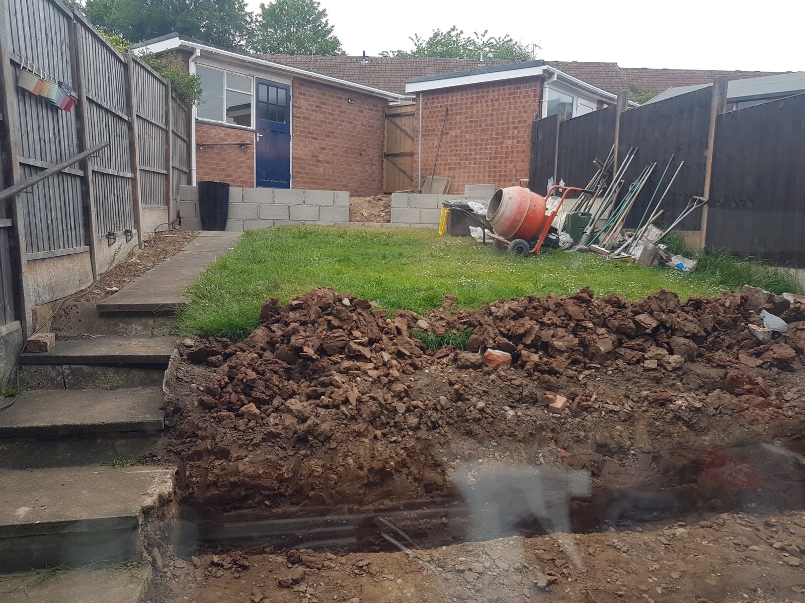

Further photos...mostly of the path, wall and the top garage. I'll get a whole picture in too.
I've had excellent work done in the past by different people (especially plumbers and heating engineers). This is our first foray into gardening/building as this is our first house and it's been long and arduous. If the builder had been a bit more professional and been like "yes we expect some issues. When can I come and take a look" we wouldn't be having a problem. But he was like "this is all just snagging. I know why you're bringing this up - you don't want to pay me! You're really patronising you've been questioning my work all along. I've got 20 years in the building trade, I know what I'm doing." I've got it on a recorded message, so that's lucky. All i did was send him a message with most of the faults found and he freaked out. Since then I've decided I wanted a second opinion as I don't trust him saying that everything is fine... I need to get to the drains for maintenance for example!
We're going to let him come and take his photos, but I've arranged for someone to be here as he was rather intimidating. We're also going to say that we're going to get a second opinion as we're not confident all of the work has been done with reasonable "care and skill" and we'll give him a list of thing we'd like done in order for him to get paid. We also want an invoice, which he hasn't provided.

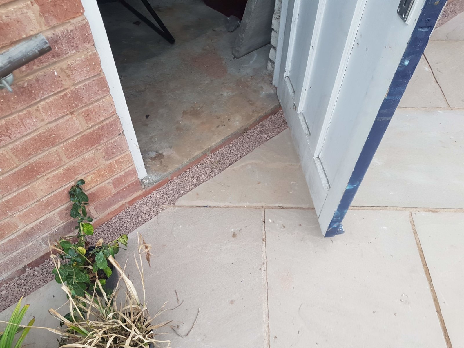

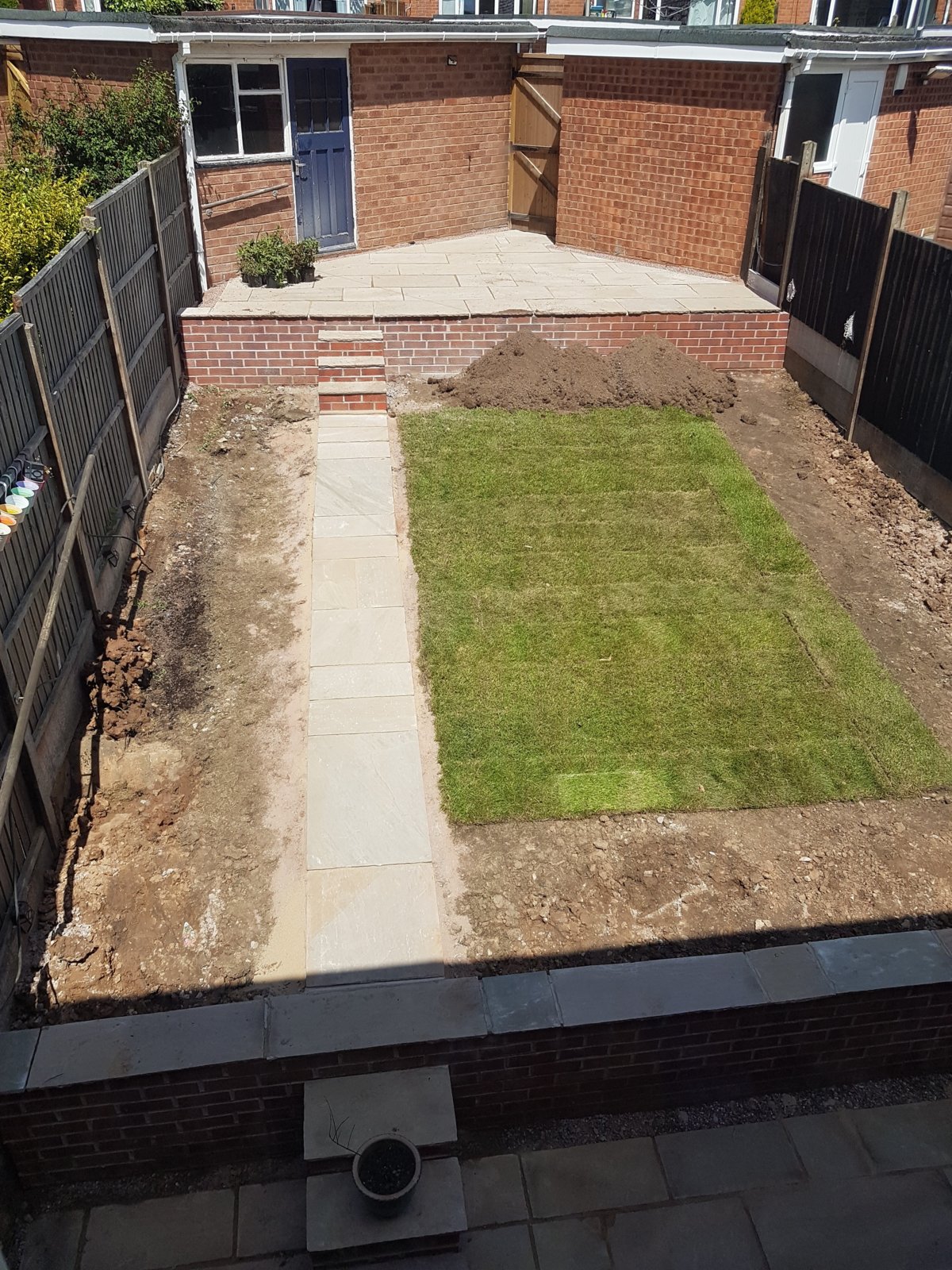

Final photo... "finished garden". The walls look fine, and we're going to spread that topsoil around and start planting. Otherwise when you look close things aren't level, pointing isn't done, the bricks are coming off the steps, the drains are blocked, the path isn't stable, all of the slabs there were fixed, are not fixed (the mortar or cement was far to dry and didn't stick and is crumbling) etc etc.

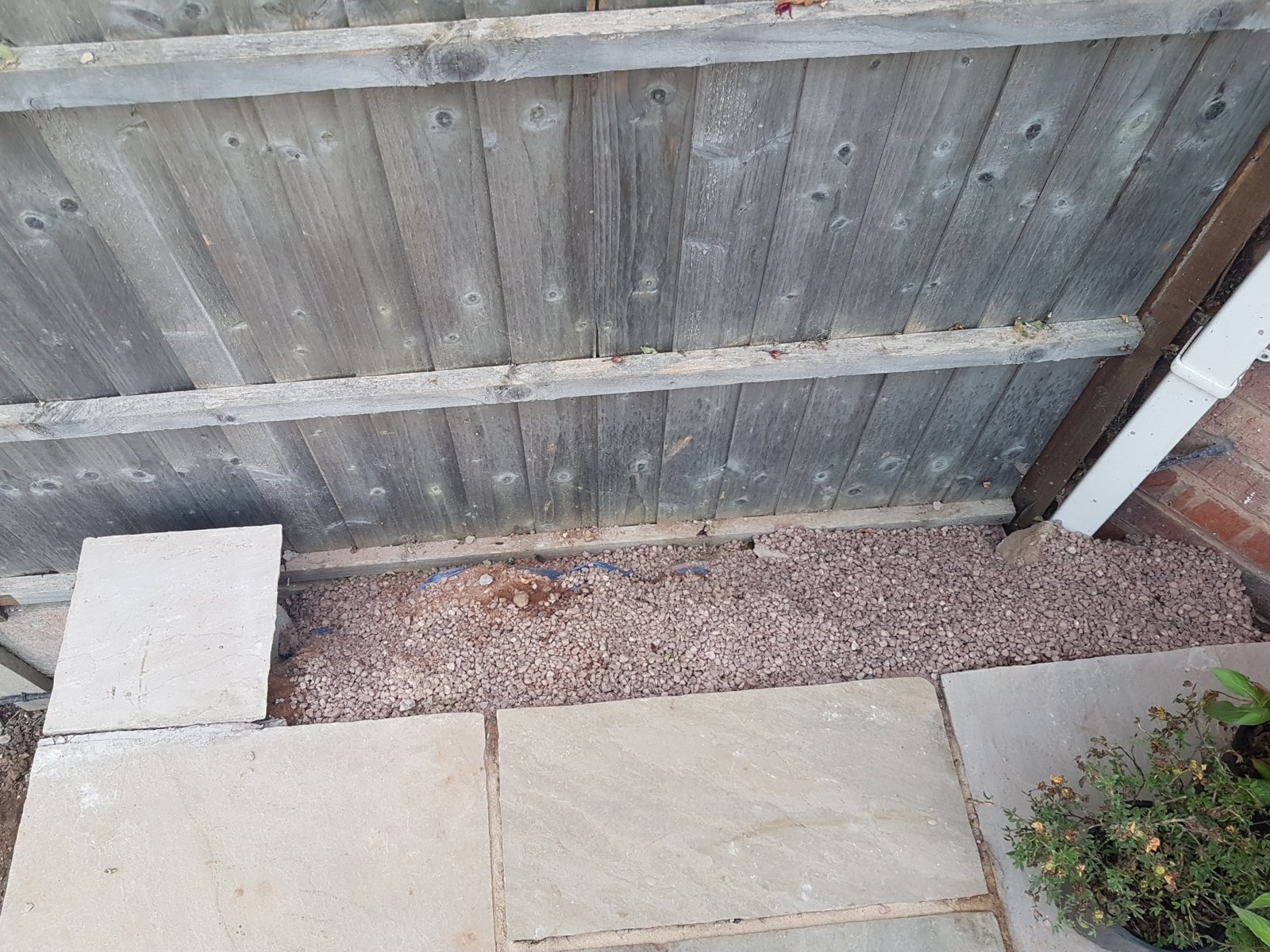

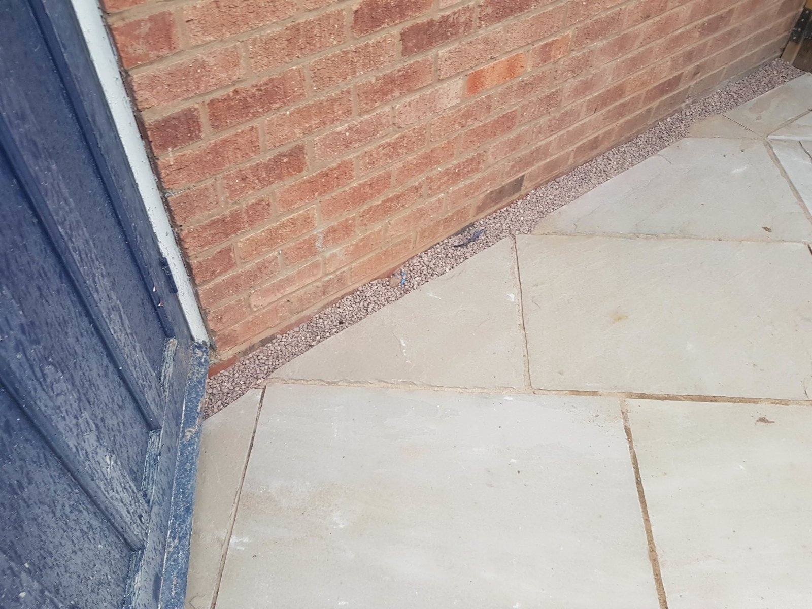

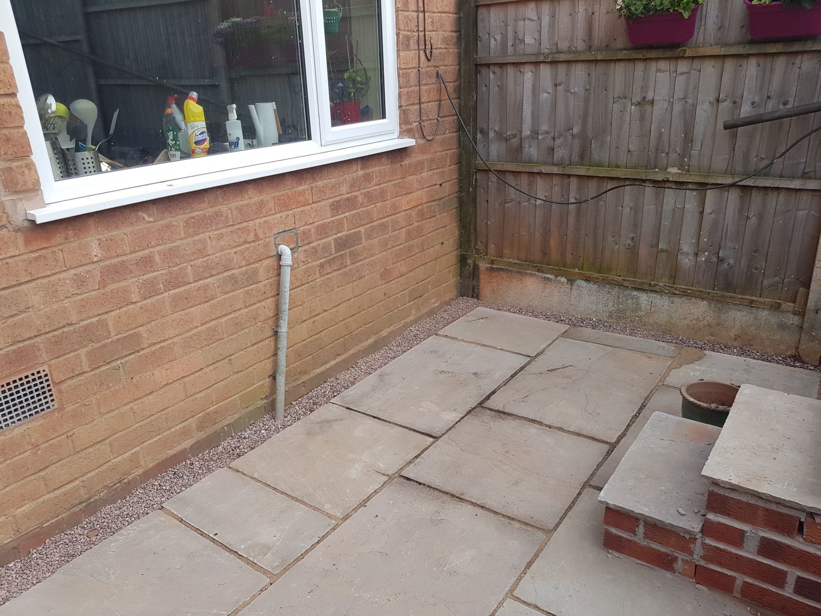

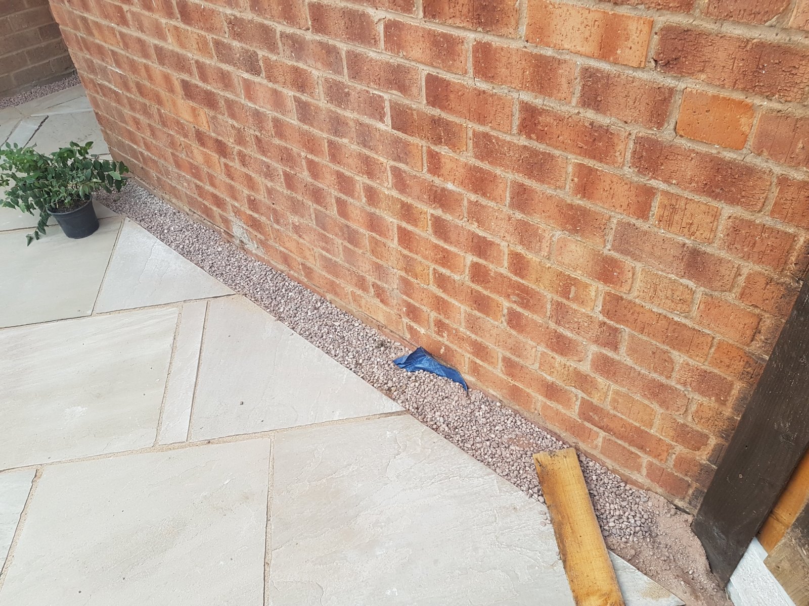

My first concern is this 'drain' filled with gravel.
There is no way all that will be able to be removed so some will remain at the bottom and some may get washed down into the main pipe which could reduce the flow rate.
The gravel just below the dpc 'may' be acceptable as it will help prevent splashback from falling rain, though I am not a builder/gardener so this is just my opinion. I can't comment on the brickwork for the same reason. If the 'weed control' is a tarpaulin with eyelets then it certainly isn't permeable and will not allow water through to the subsoil. This in turn will cause drainage problems. Is the higher section higher than your neighbours garden? If so then this may lead to flooding on their side due to inadequate drainage on your property. The water will simply find the easiest course of run off, which will be from the sides of your property on to theirs.
You really do need to get a professional landscaper in to give a written second opinion. It may cost you but it may save you a lot more then you owe the original guy, especially if it ends up in court.

I will only comment on the gravel in the drains...
It just should not be there at all, it demonstrates a complete lack of care, skill or supervision on site. I managed to accidentally get gravel down one of my gulleys 40 years ago, caught in the U trap. It caused restrictions and subsequent regular blockages for much of that time, until around 10 years ago, when I acquired a wet vac and was able to clean the U out properly.

Sorry to be so blunt but the entire project smacks of either a cowboy or somebody who has no idea about what they're doing.
1) Drains - no professional would ever cover gullys with pea shingle. Either lay the patio at the correct depth or fit a gully riser and bring them to finished level.
2) The membrane (if it can be called that) is not a membrane - it looks very much like a cheap B&Q tarp, totally unsuitable.

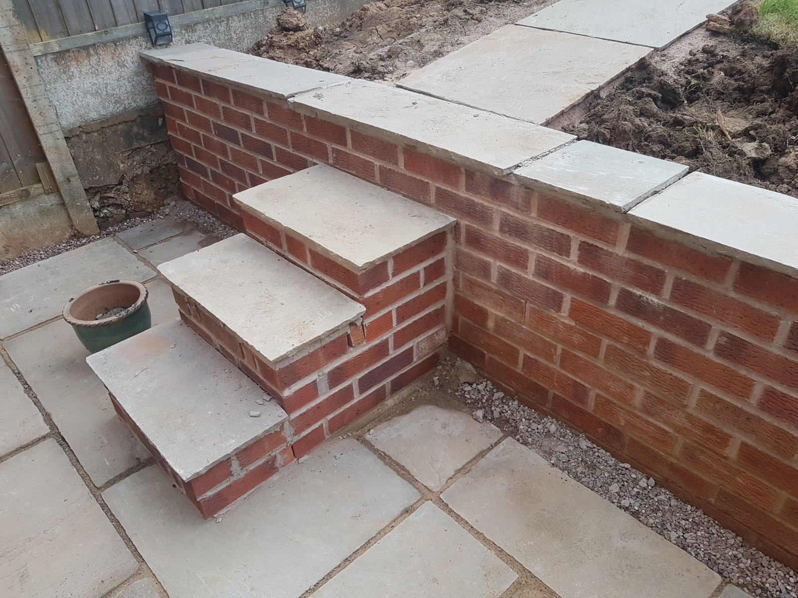

3) The step look to be built on top of the slabs. They are uneven and the rise changes from step to step. The tread depth is also odd with small pieces of brick varying on each step. I would bet that they are not tied into the wall.
4) The retaining walls doesn't appear to have any weep holes.
5) The slabs laid on sand (or possibly a dry mix) will be moving as soon as the bedding is washed out.
6) The retaining wall nearest the garage doesn't appear to have any returns and seems to rely on on the fencing to provide lateral support.
7) The finished level is way too high - as your own research has shown it should be two courses below DPC.
8) Slabs are not finished with kiln dried sand (as used for block paving). They should be pointed with mortar.
9) Where the slabs have been pointed (lowest retaining wall), the mix looks to have way too much cement in.
10) Where the slabs have been used on top of the retaining wall, if the same mix has been used then the bond will almost certainly fail - it's usual to either use a SBR/slurrey mix to ensure a good bond (especially in the warmer weather)
11) Slabs cannot be laid onto earth (your description in your OP).
12) Leaving a gap at the side of the new patio and filling it with gravel is not even a bodge - it's a mess.
13) Have the blocks and bricks been tied in or are they two separate walls and do they have a proper foundation?
Last but not least
NO - THE CONTRACTOR HAS NO RIGHT TO COME ROUND AND PHOTOGRAPH HIS WORK PRIOR TO A SECOND OPINION BEING SOUGHT.
HE HAS NO RIGHT TO COME ONTO YOUR PROPERTY WITHOUT YOUR EXPRESS PERMISSION.
Personally I would not part with a penny for the 'work' done so far as I suspect that a significant amount of remedial work is going to be required.

3). The steps are on top of the slabs (that are inturn over earth and builders sand). The steps are not tied into the wall.
4) There is one weep hole in the bottom wall (on the far right of it). No other clear ones anywhere else.
5). The slabs on the sand are already moving as it rained today.
6) You're right, they just built the wall and didn't consider filling the gaps. The gravel and sand is now running out of the gap between the wall and fence.
7) I did originally want the top patio to be up to the bottom of the garage door for a really cool way to walk in and out, but he convinced me out of it and said that you can go above 150mm if you put gravel down. On that information I said ok. I've done further reading on it and I'm uncomfortable with it still, but "had to trust him".
8) Most of the kiln dried sand... that has been washed away in a lot of places.
9) This was my guess. It's really brittle and it's shrunk huge amounts since it has dried and is useless now.

Unfortunately, to my eye the pics dont tell a good story.
My concern, which I expect is also yours, is that the visual defects are symptomatic of more construction errors hidden below.
The post above by NotSoNewboy has pointed out quite a list of concerns.
I would add I wonder if the walls have correct foundations.
The retaining walls shouldve been returned so that the fences are just covering the returns -it looks like the fences are acting to retain the soil which is of course wrong.
Legally a contractor has the right to correct any faults, but my guess is that the job needs doing from scratch and the problem is that your builder doesnt have the skills.
The biggest problem is that your builder does clearly not have the skills or knowledge and is out of his depth. it seems to me he has made it up as he has gone along. a skilled builder would have set it out correctly so it all tied in neatly avoiding the issues that are now visible. Sadly a skilled builder would probably have done it quicker, because if you set out correctly, it all falls into place.
Lets hope your pro landscape gardener can advise you what is doable
note: update Ive just seen you post and you say the walls have proper founds -maybe some of the work can be retrieved!

I agree with the posts above, the work is appallingly poor. I just don't rate RatedPeople at all. The suggestion I have heard are that those offering the services, pay to be listed on those sites and they have friends and relatives post recommendations for them. The site owners never vet those offering their skills. It is in the interests of the site owners, to have as many as possible offer their services via the site and its no good complaining to the site owners about bad workmanship.
Please don't pay this guy any more than you already have, until it has been properly sorted.
