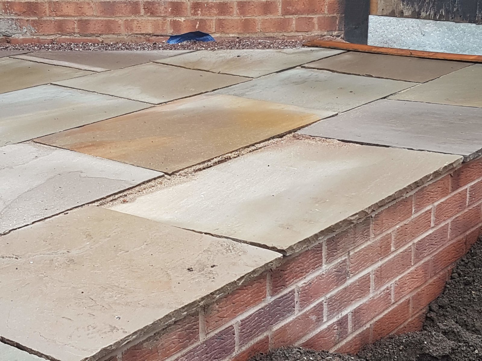

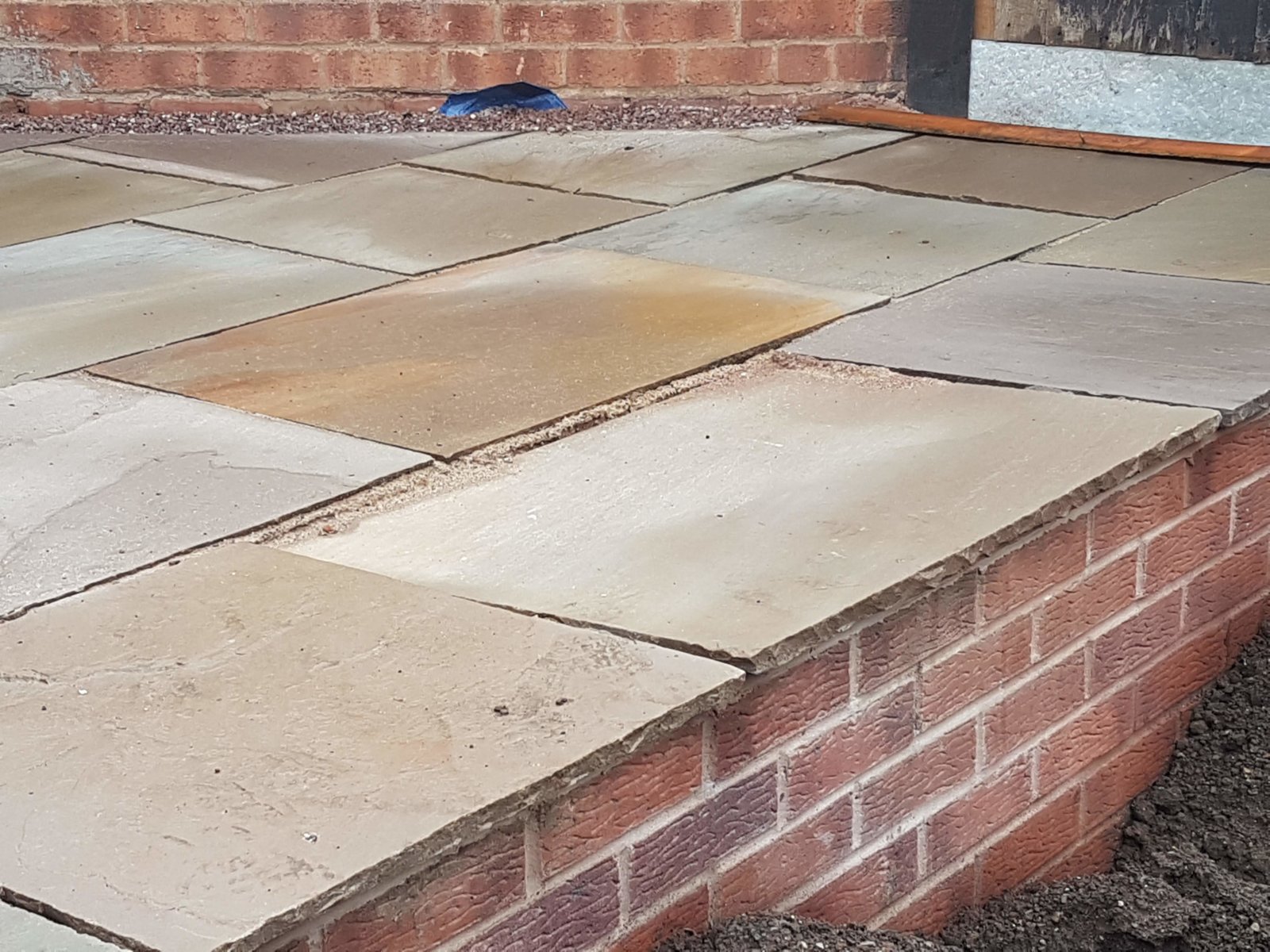

Wall foundations - been reading around - so the foundations were dug and was just a cement layer across. He left it dry for a day and then put the brick and block walls on them (not into the concrete foundation). Does that sound fine too?
I'm no building expert, but I expect it should have been a concrete foundation, with some depth.
yeah there was a concrete/cement layer. I'm guessing around 2-3 inches deep (from the depth of the holes) and across the bottom of the walls. They put that there, let it set and cure and carried on with the walls the next days later. They didn't do all of the concrete at once as they left the old steps that were removed later in place crossing over the bottom wall.
I'm having to question everything he's done now, especially after learning about wall ties etc too! I'm learning fast.

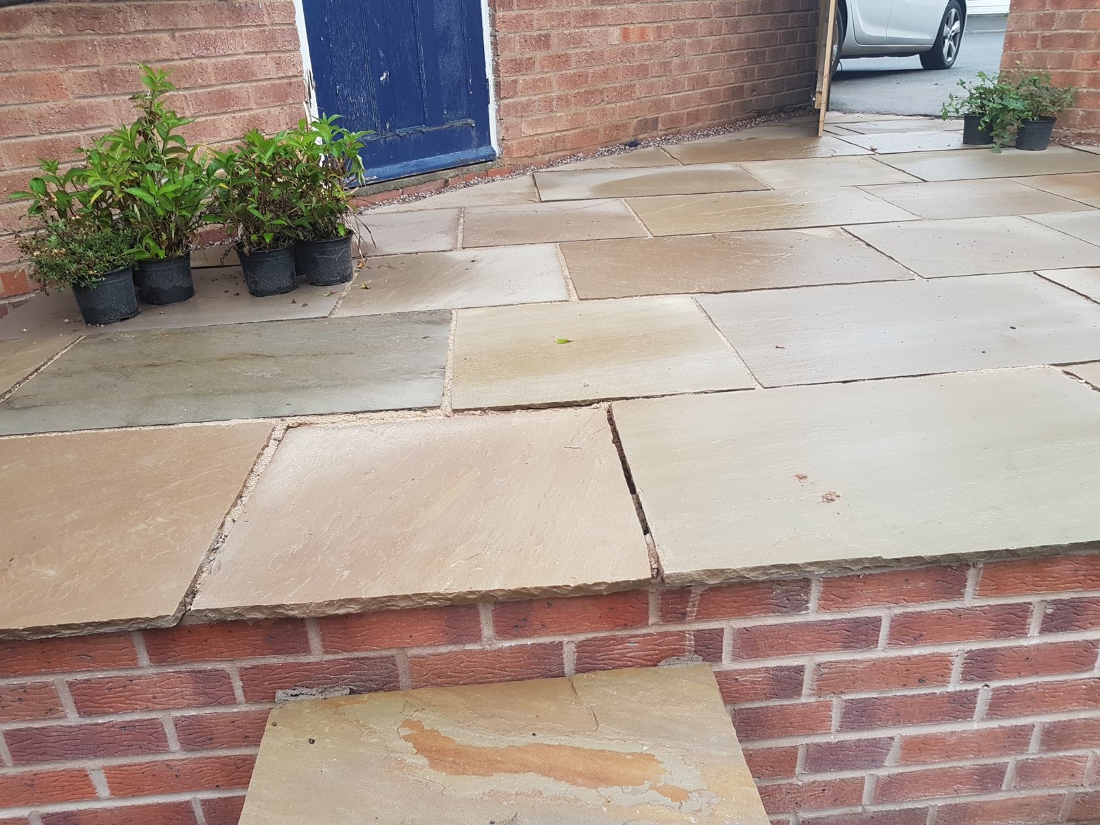

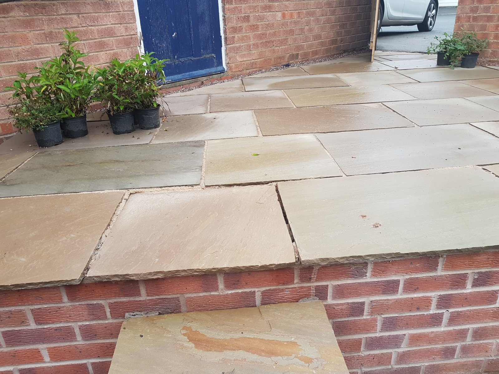

Also two photos attached showing collapsing patio after the rain (taken this morning) - for your amusement. The rain washed away the kiln dried sand and some of the builders sand underneath and then went down into the cavities. The slabs sat on a pool of water/sand mix and when stepped on sunk. I assume that's because of the "membrane" storing the water.
Being very blunt, I suspect this is going to be a case of having to rip out and start again. So far there is no part of the works that is even close to being done correctly.
The wall with no foundation is just waiting to collapse and is potentially dangerous.
Get the expert report together as quickly as you can - although quite how you are going to offer the contractor the opportunity to complete remedial works is another question as he is clearly either a cowboy or incompetent or both.
No -it's because they are not bedded on anything - the tarpaulin won't be helping but the end result would be the same.
Keep an eye on the wall - as the cavity fills and the non-existent foundation softens the wall may well fall forward.
