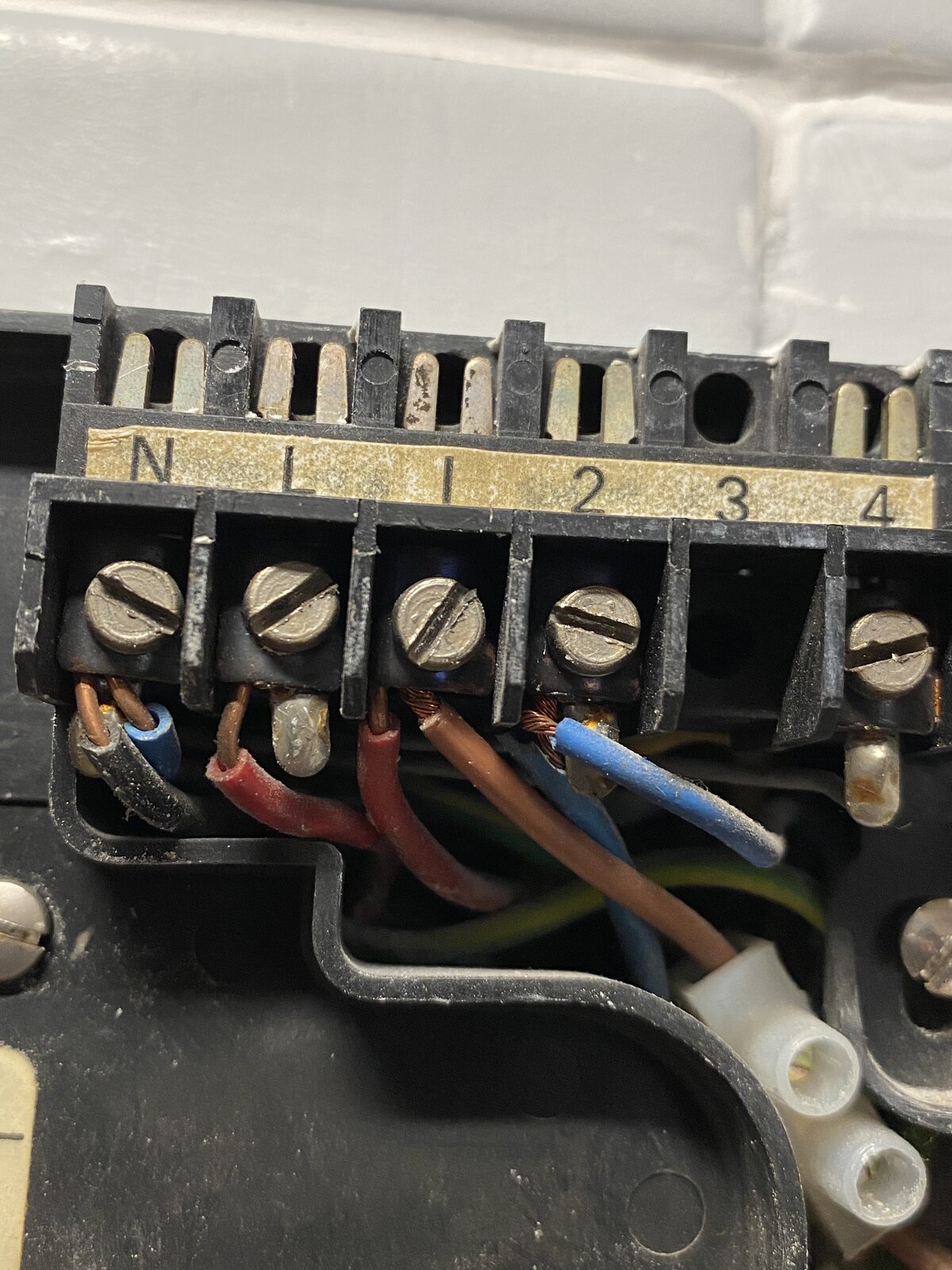

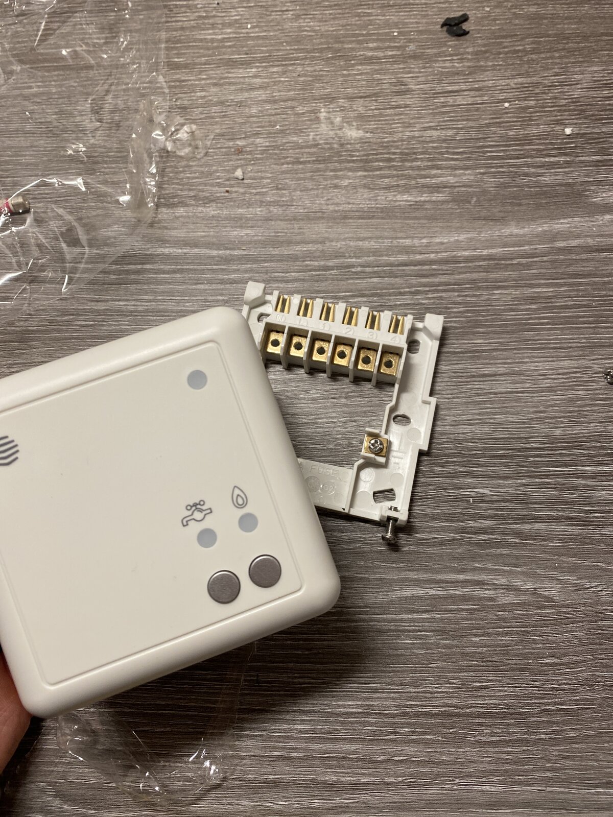

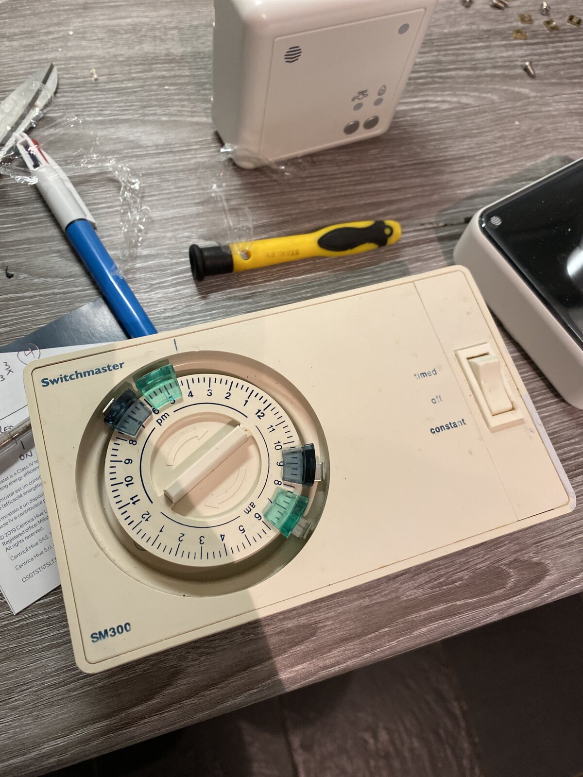

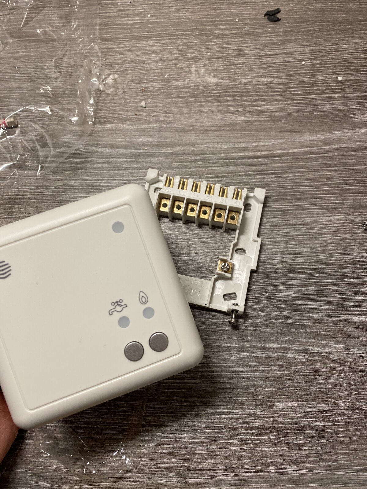

Hi all,
After many google searches I’ve come across this forum, I’m just about at my wits end!

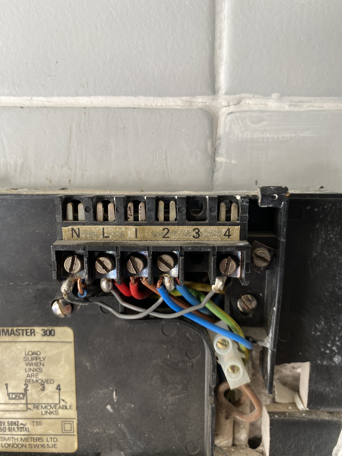

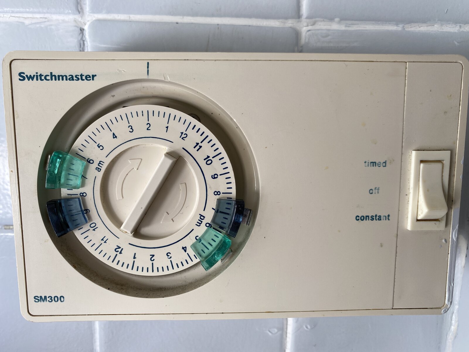

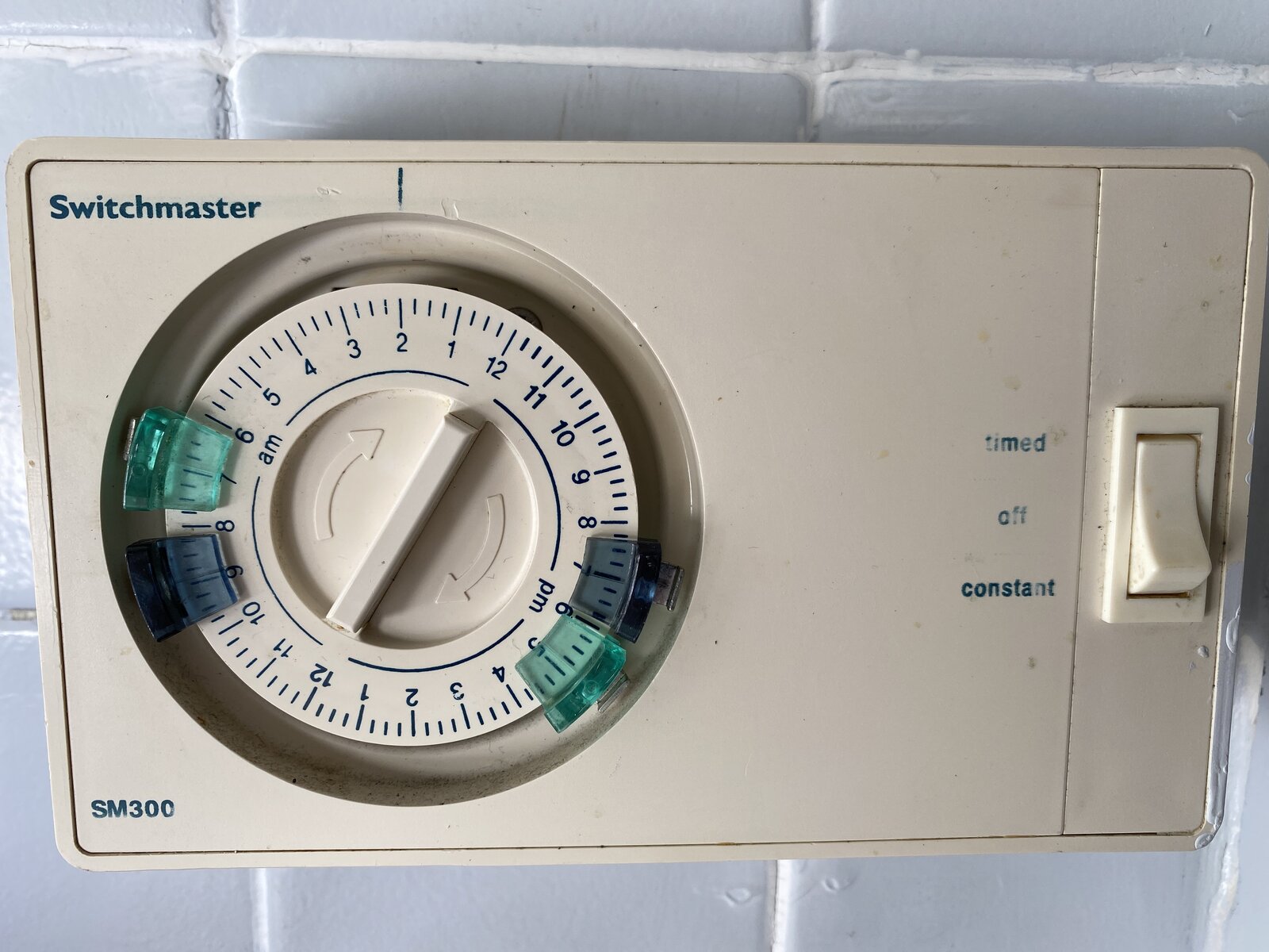

My current switch master SM300 has finally died and I’ve decided to buy a Hive heating and hot water earlier on today and have been trying to set up all evening/ night!
I’m abit of a novice with wiring however I was told it was fairly easy to do!
I tried to copy like for like with the wiring however it’s blowing the fuse every time and after trying different wiring setups, I’ve just about had enough!
My setup:
Potterton Kingfisher II
Switch master SM300 with timed/ off/ constant switch

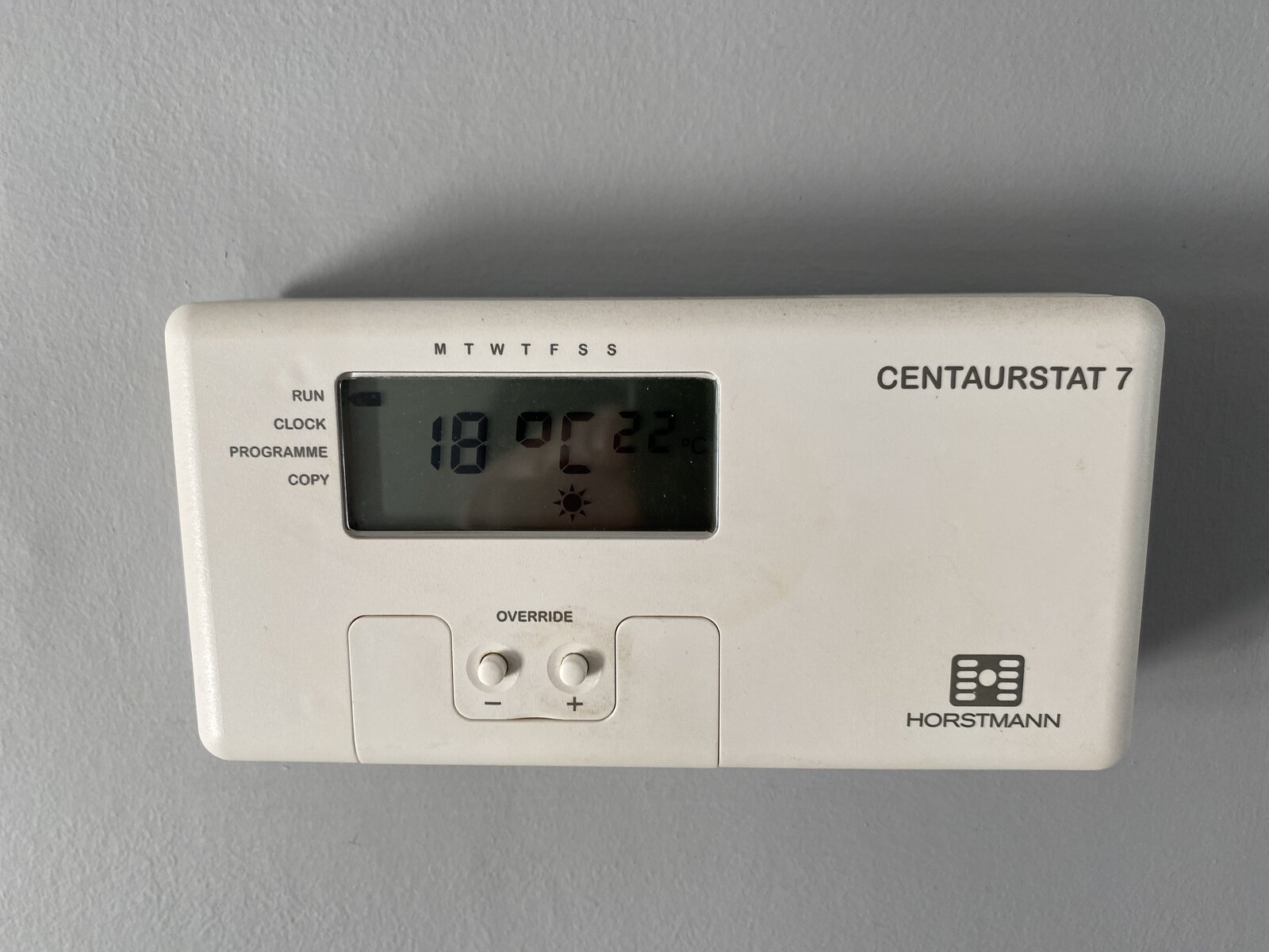

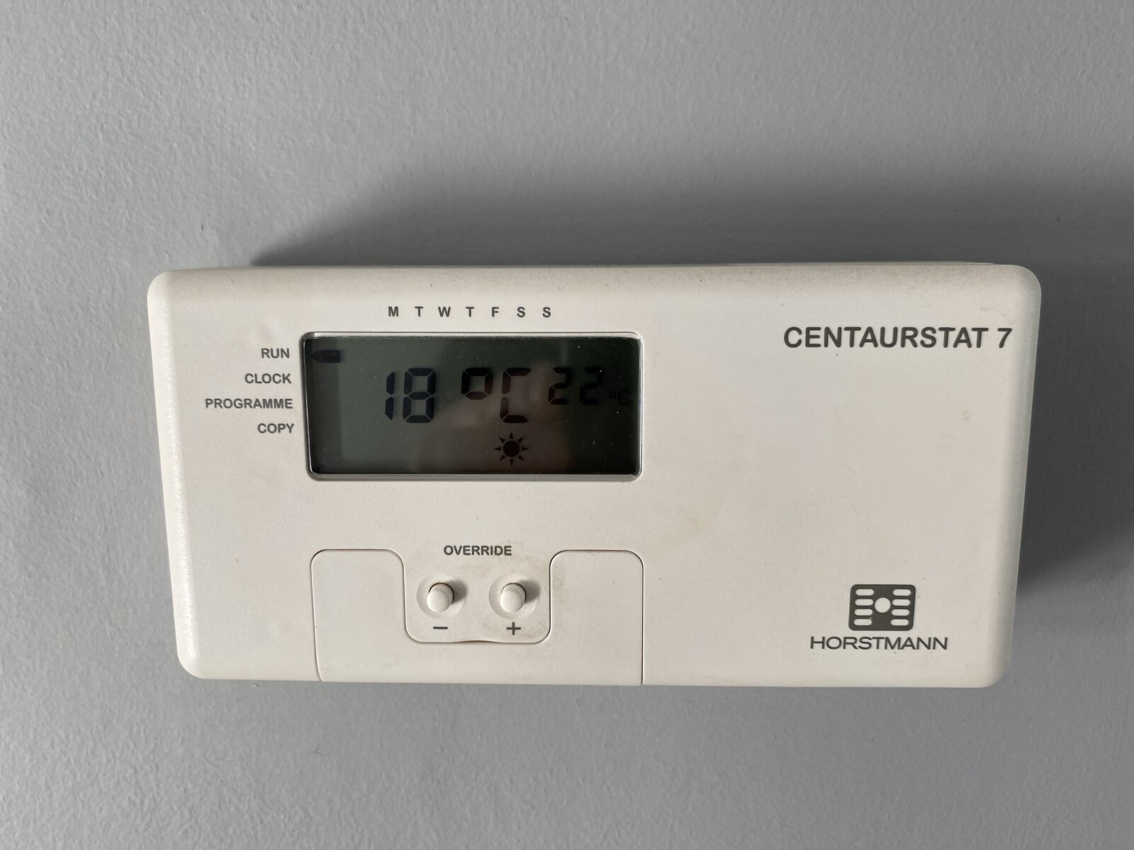

Horstmann Centuarstat 7 in hallway
Hot water cylinder in upstairs airing cupboard
Can someone please assist where I’m going wrong and maybe help with wiring up new hive?

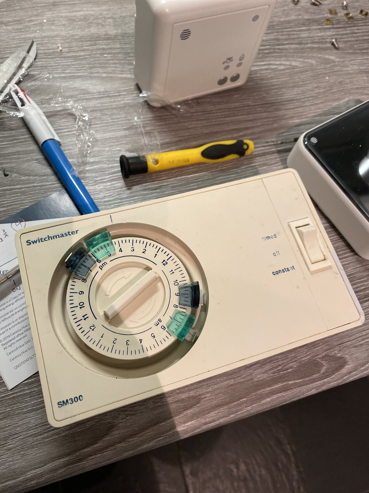

I’ve currently taken it apart and put old SM300 on as I can still use the functions on constant.
Any help is much appreciated

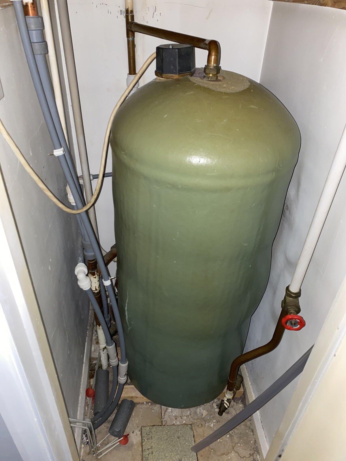

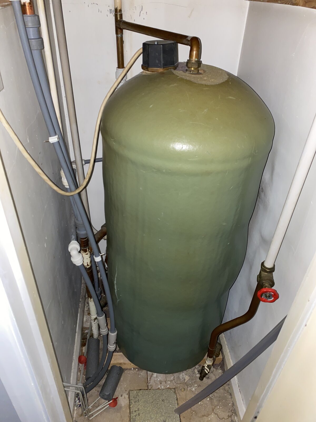

The switch master SM300 is a single channel time switch not a programmer, so you will need a bit of rewiring the Dual channel hive wont just accomodat the wires in there, we need to know what system you have, I think it will be gravity HW a pic of your HW cyl should show it
Hi Ian
Cylinder in airing cupboard and fed via tank in loft
potterton kingfisher II in kitchen has pump for CH if this helps?
Yes you have a gravity HW system, you can wire the hive to work with this, but you wont get individual control of the CH you will only be able to have HW on its own, or CH+HW at the same time
That’s ok. How do I go about that?
I have the heating and hot water hive, should I return and get the single heating hive?
You have a boiler and a pump, and the Hive supplies each independently, so when you want central heating boiler and pump is supplied, but for domestic hot water only the boiler is supplied. Since you don't need access to the Hive base it can be fitted close to boiler.

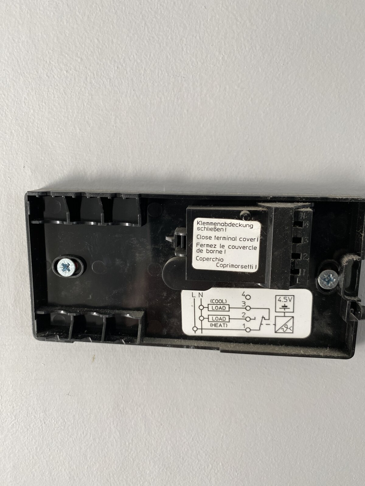

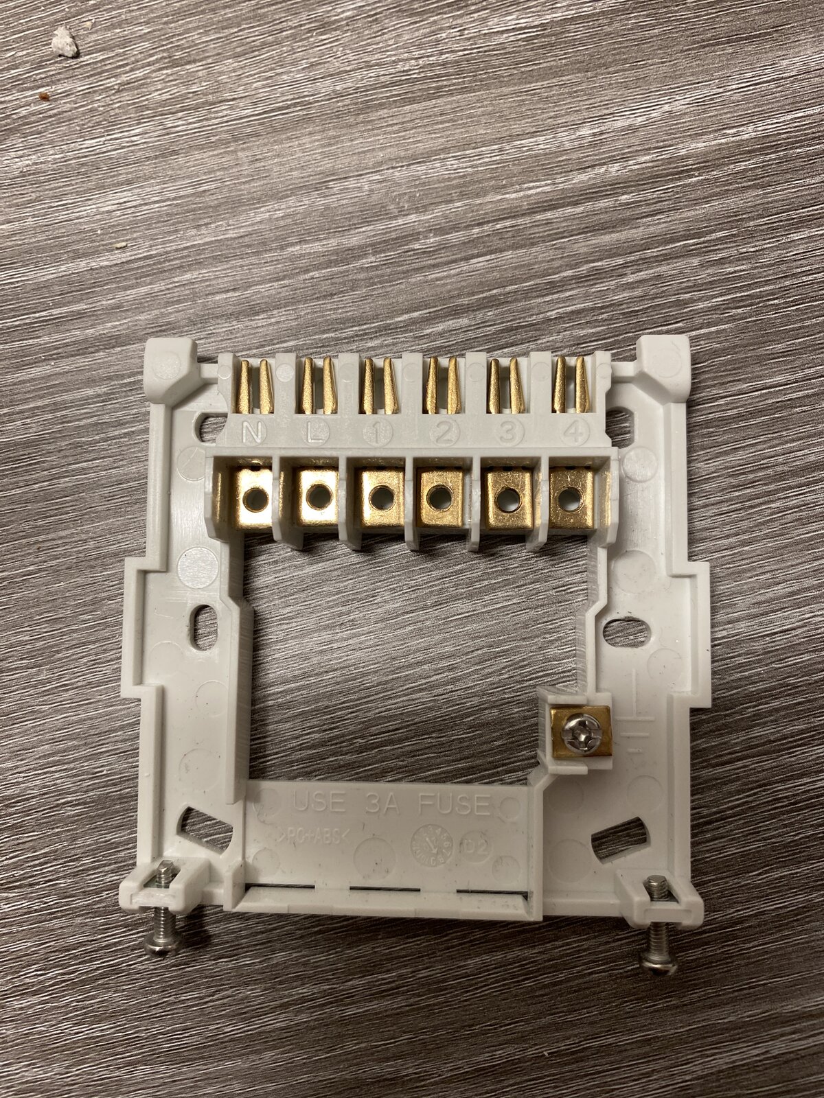

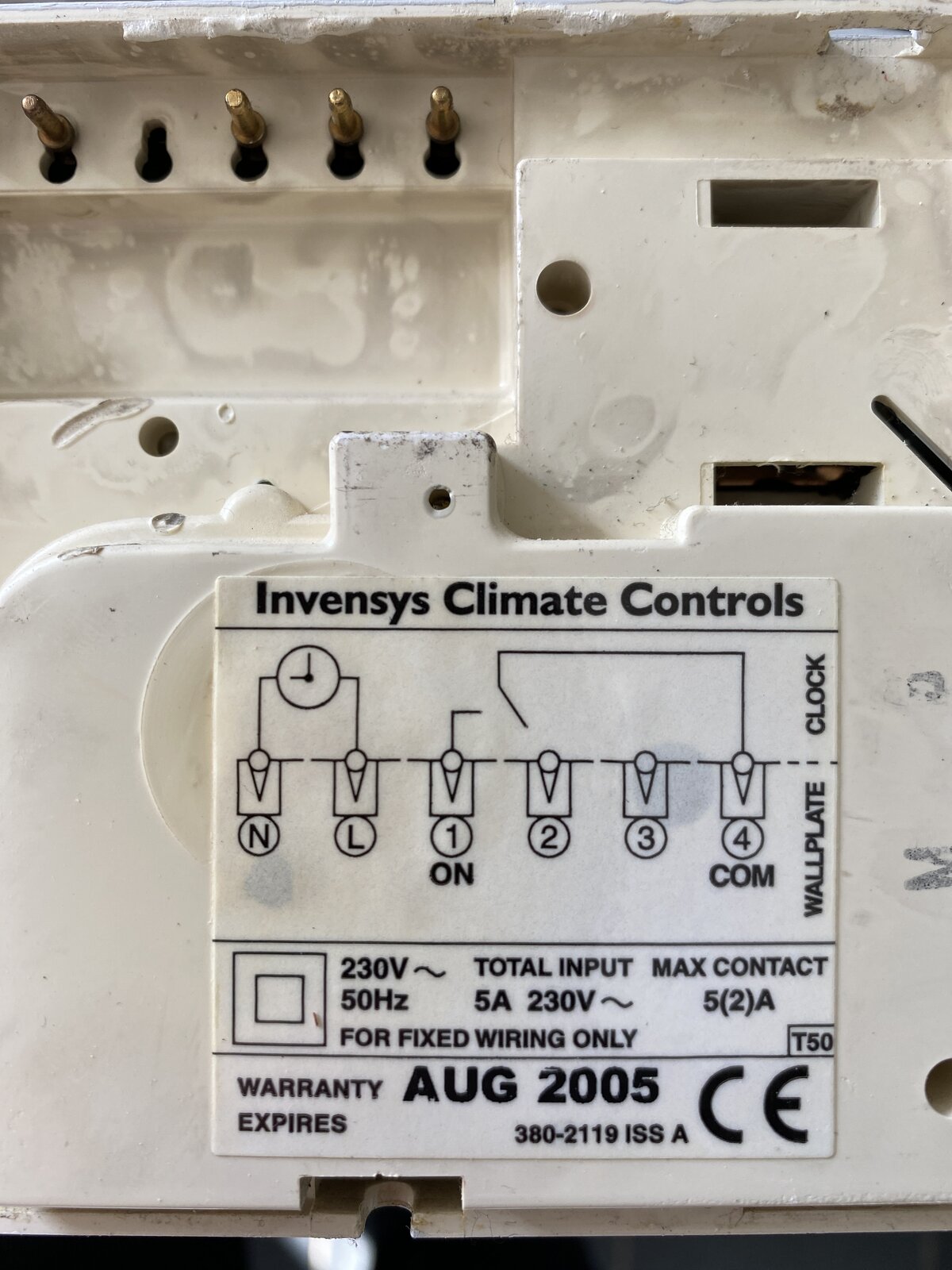

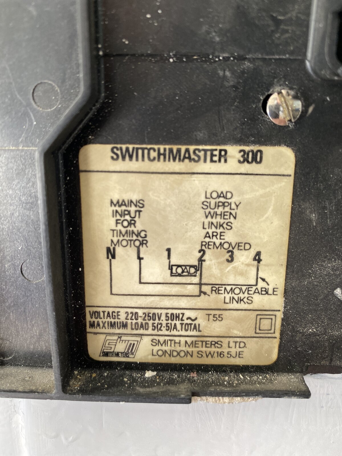

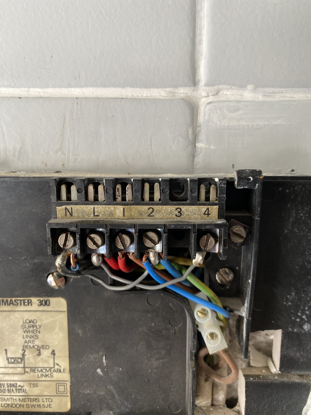

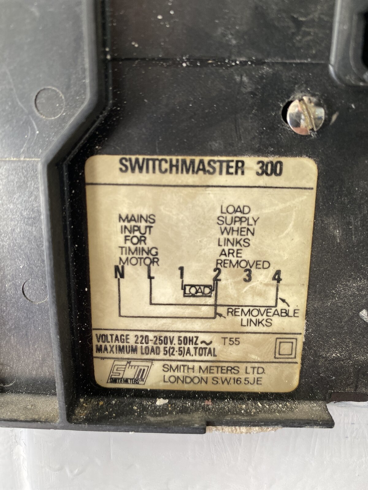

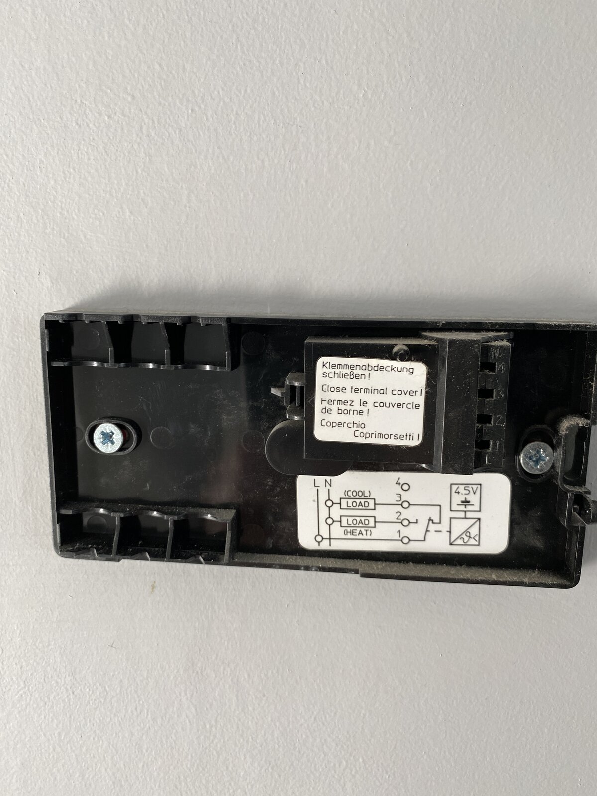

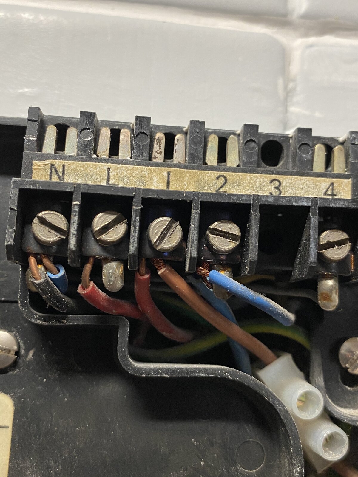

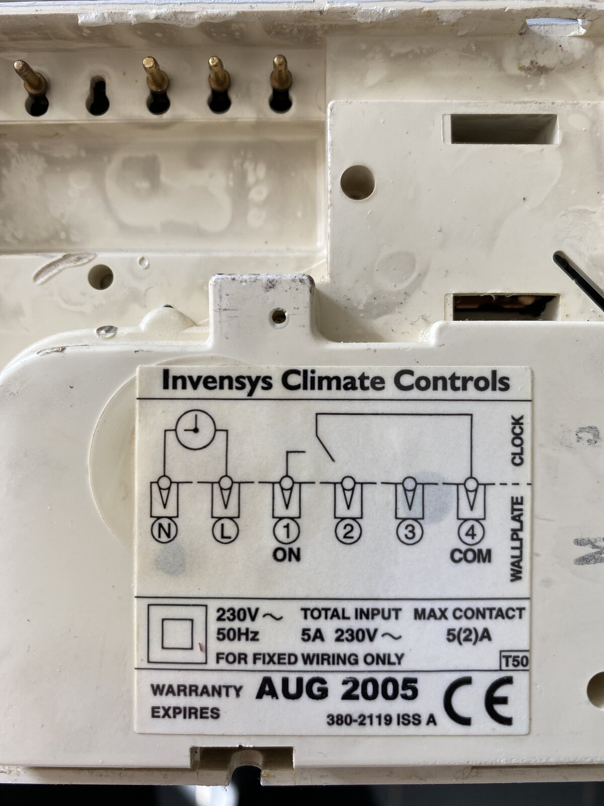

no you need the twin channel which you have, is there a wiring diagram on the back of the cover of the SM300 ? can you post a pic if there is, you have wires in 1&2 I would have expected it to be 1&3 but cant find a diagram for the SM300
Hi Ian
appreciate the help, uploaded a few pics.

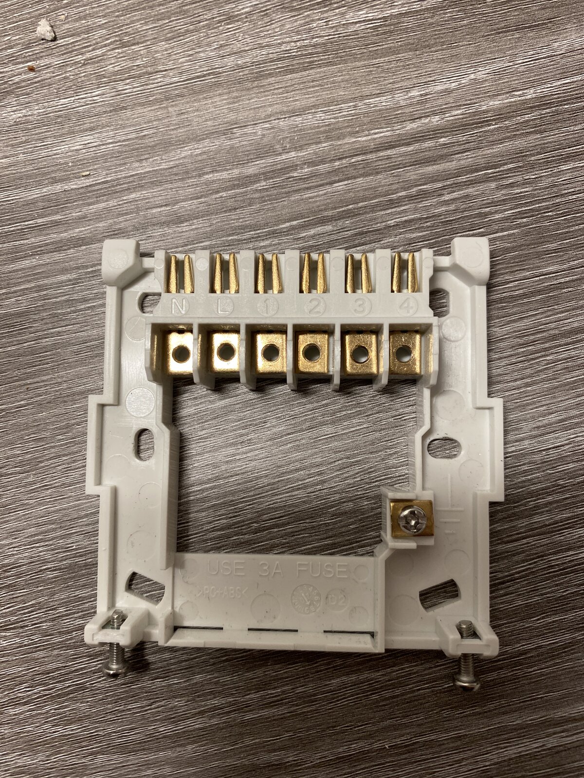

You would be better totally ripping that lot out and start from scratch, LN&E are constants (the hive doent need an E but the boiler and pump do).
3 on Hive to Boiler L
4 on Hive to Pump live
No links anywhere
Totally discard everything else and set Hive to Gravity HW
How do you mean ripping out?
Unless I rip out the walls I can’t trace the wiring?
How do I know what’s the boiler L and the pump L?
you will just have to follow them, I use a multi meter to ping them , but sorry no easy way with your pics to tell you what is where, just dont go by colours they mean nothing
Just a question to ask.
Do I need to link the N or L to any other terminals? Or is that just for the timer motor on the old SM300?
Or will I need to link to power the system boiler pumps?
