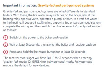

Once you have identified the cables, to connect Hive to a gravity hot water system with pumped central heating, the cable going to the room thermostat cable is completely disconnected and removed. The remining cables / wires can be connected to a dual channel Hive as follows:
The earth wires should all be connected to the Hive earth tether.
Once the wires are connected, the Hive should be set to gravity mode.
Some boilers also need a permanent live connection, but if my memory serves me correctly I don't think yours does. Post back if in any doubt.

All up and running perfect - once thermostat wires identified and with Stems diagram it took less than 5 mins to get up and running once set in gravity mode.
