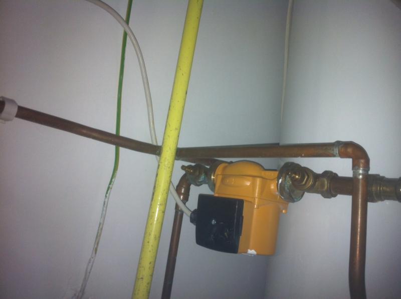

The boiler doesn't have a timer on it and has three buttons in total two on the left of the boiler and one for the Orange thing ( see below) which i am not sure what it is. The boiler has been constantly been dripping water through the drain pipe. I am not sure what it is and what it means? Initially i thought it was possibly a condensation pipe but its constantly running water which is more then a dripping water.

I can't make out the orange thing. The colour is about right for a Grundfos Bronze or Stainless pump, if you have long pipe runs to the hot tap. Take a better pic of it.

I have attached the picture for the orange device and also the meter now.

that's interesting, it is a Grundfos bronze. Very expensive so what does it do?
And, I spy with my little eye, a gas pipe.
I am not sure what it does i have switched it offf? What is this for?

Is the yellow thing a pipe? Where does it go?

Guys - look @ the "pipe" it`s crooked and no clips - how could it be a gas pipe :shock: . Believe it or not there are still some areas of Sussex that don`t have mains gas .

The yellow thing is the mop indeed. Will get a timer fitted for this once switched to e7.
What is the orange device for ? Do I need to have this on all the time?
