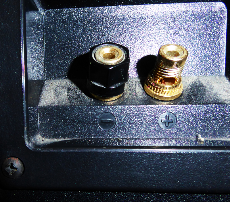

A couple of the plastic screw caps have broken off a pair of speakers. I usually just connect the cable bare via the screw cap and slot.
How do I determine the guage of the screwtop, or were I to go down the 'banana' connector route is the size I would need the internal dimension of the existing connector as shown below?
I'd prefer not to dismantle the back of the speaker, but so far I haven't found anywhere that stocks just the caps. Gone are the days of popping down to maplins!

AFAIK banana plugs are a standard 4mm.
I had seen 6mm ones advertised, but maybe that is max cable size?

You could look here for a something similar "speaker binding post", buy the cheapest, and just use top screw down section.
You would need to cross your fingers that they are the same size, but might be worth the try for £3.

As in my reply above, the threads look different.
Thanks for helping expand my search term words, as I didn't know they were called 'binding posts'.
You are probably right as the ones on your Speakers also look like a captive thread, in that the thread does not go all the way to the top to stop the caps from being fully unscrewed.
For all the speakers and lab gear that I use, I buy and use "4mm Banana plugs".

I'm probably going to have to 'bite the banana' and change my connection method then...lol
(I'm assuming that the screw cap isn't required to 'anchor' the banana connector?)

Banana connectors are friction held in the hole, the screw cap is not needed.
Banana connectors can go into the top hole or side hole (which you used for cable) - Although in your photo the side hole looks a bit obscured by the mounting nut.

Thanks for all the replies.
Have just ordered a set of banana plugs.
