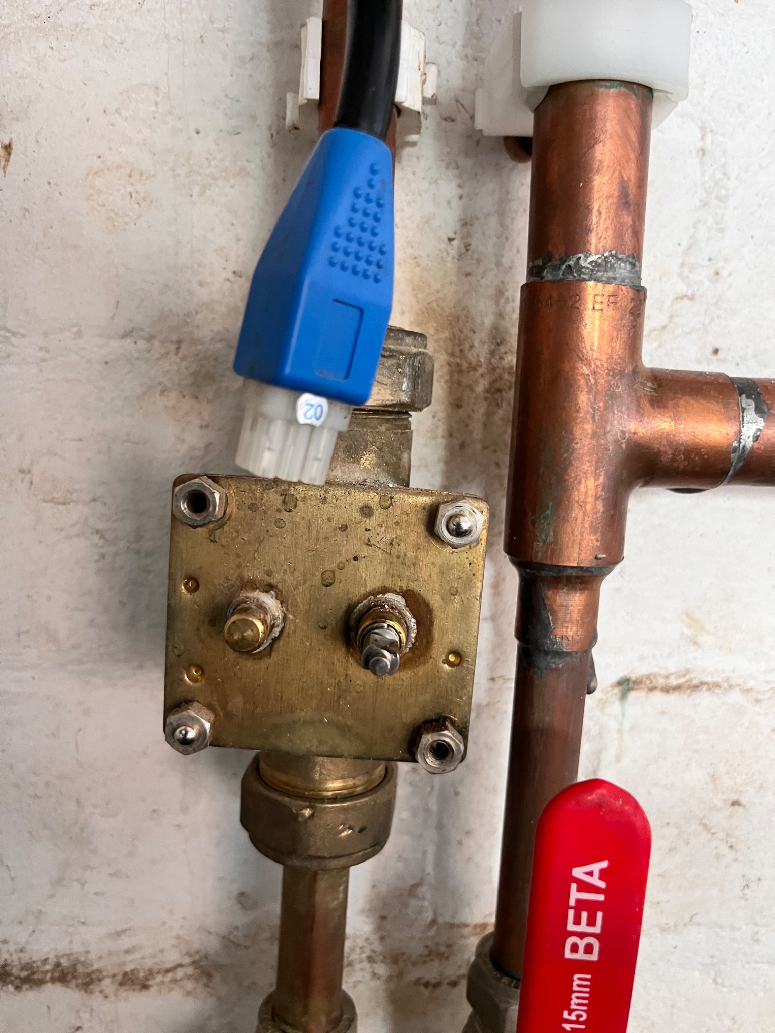

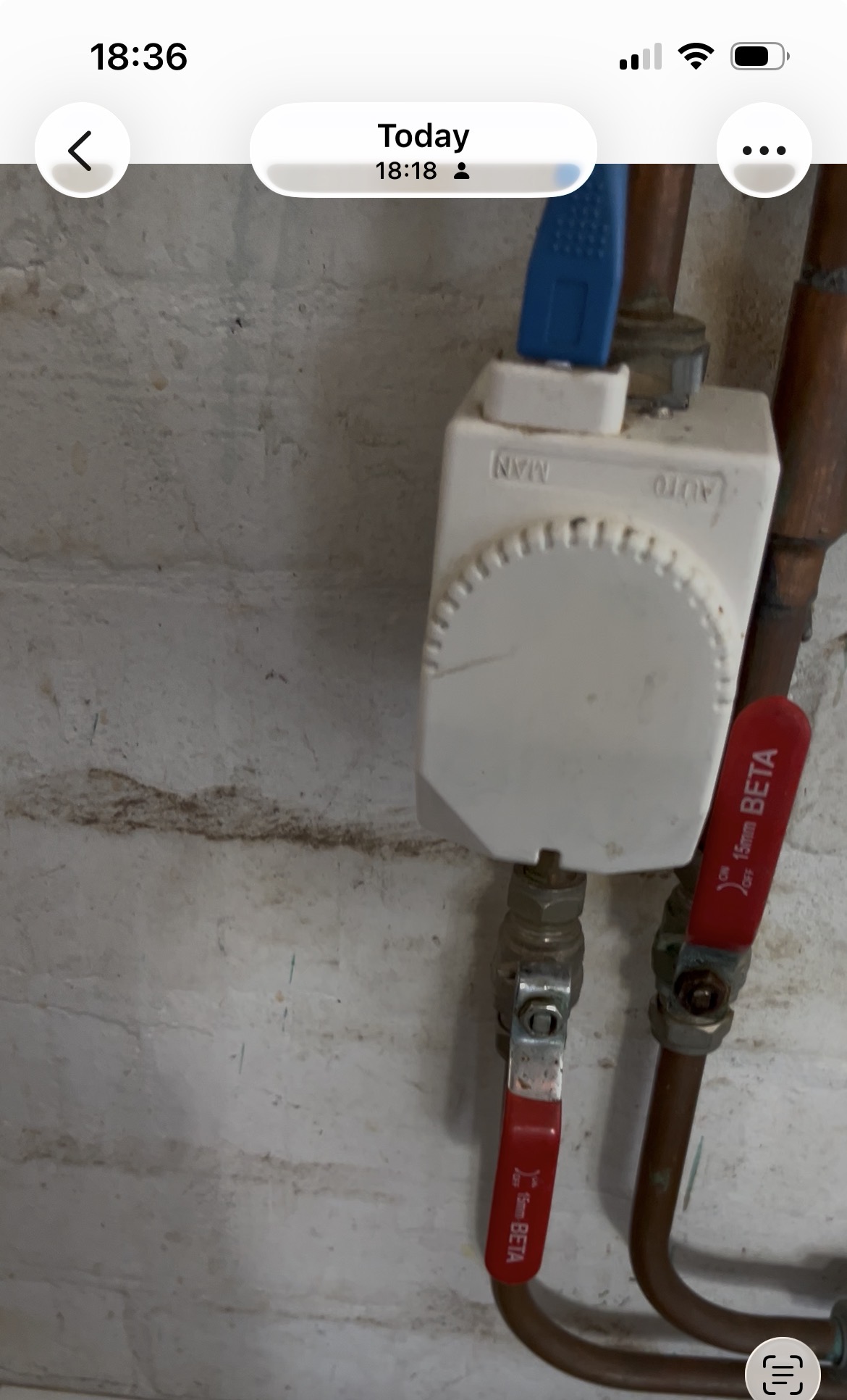

I hope you are able to help me please. My actuator head is no longer working for underfloor heating.

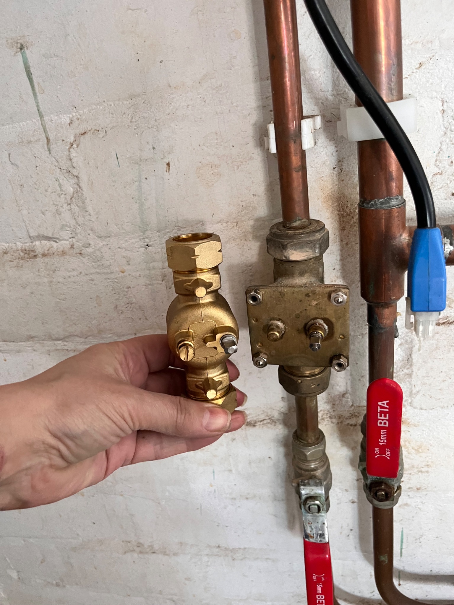

I couldn’t find the same model online, so I bought one that had the same wiring in Hope it would fit … but the brass fittings are different & I don’t want to have to drain the system down.
I have attached photo of original part, current brass fitting, part that the new one needs to fit in to ‍♀️
Any recommendations please

Use the isolator handle directly below.
Release any pressure in the system
Undo the other end, only a small amount of water will be lost.
No need to 'drain down' anything.
