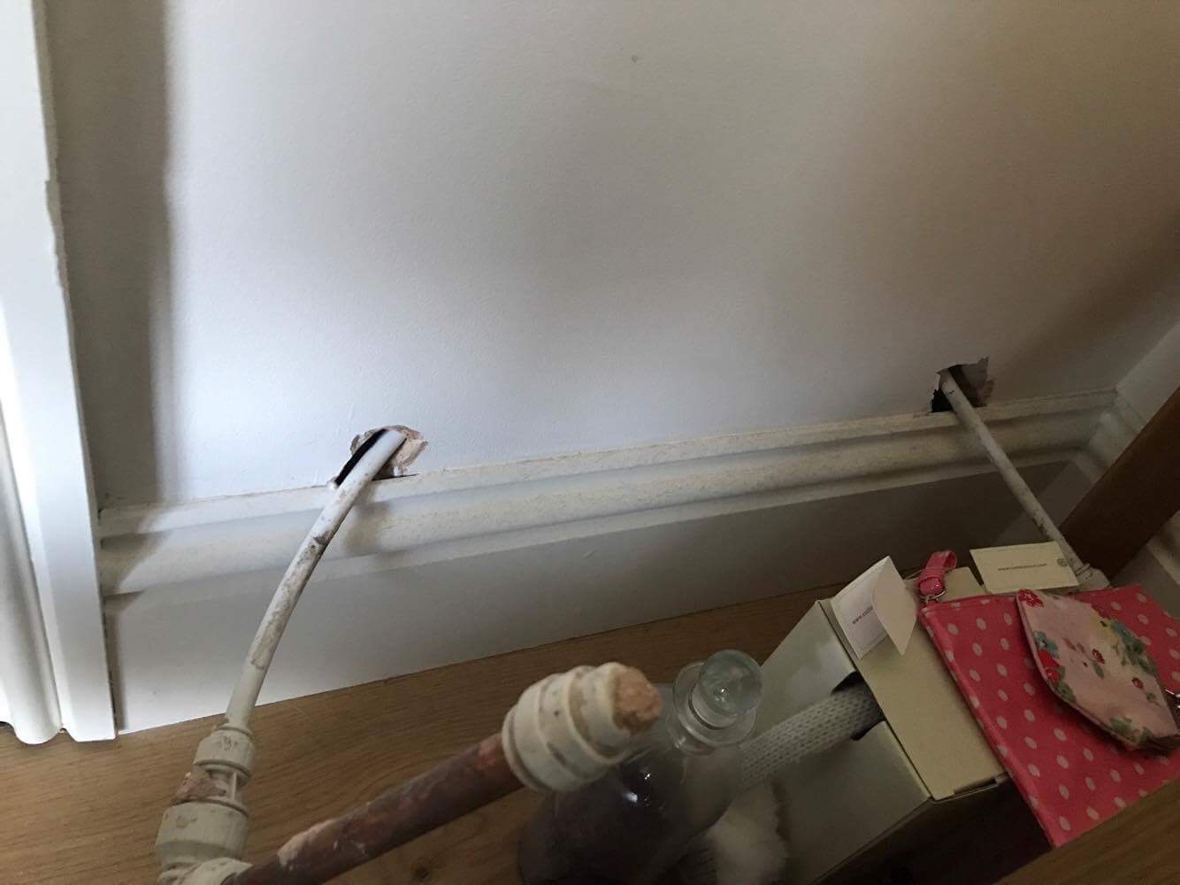

I need to install a vertical radiator to this pipework that someone else installed.
Any advice on the best way to do this to make it look tidy.
some have a distribution baffle

lots of the vertical radiators can only have the direction of the flow from the boiler going one way , they have distribution baffles in them that sends the hot water to the top of the radiator , you need to check the install instructions of your new vertical radiator , they usually have a sticker on the connections saying flow, it is also possible to fit them upside down
is that a 10 to 15 or a 15 to 22 conversion going on in that pic. If it was me I would put 90 deg elbows including inserts on the pipe as near as poss to the wall and push them into the wall so you can bring the pipes out nice and straight in either copper or plastic. You could start bashing out the board to bring the pipes up but will it really look any better? Its worth noting that you can get rad valves that are angled and straight through.
