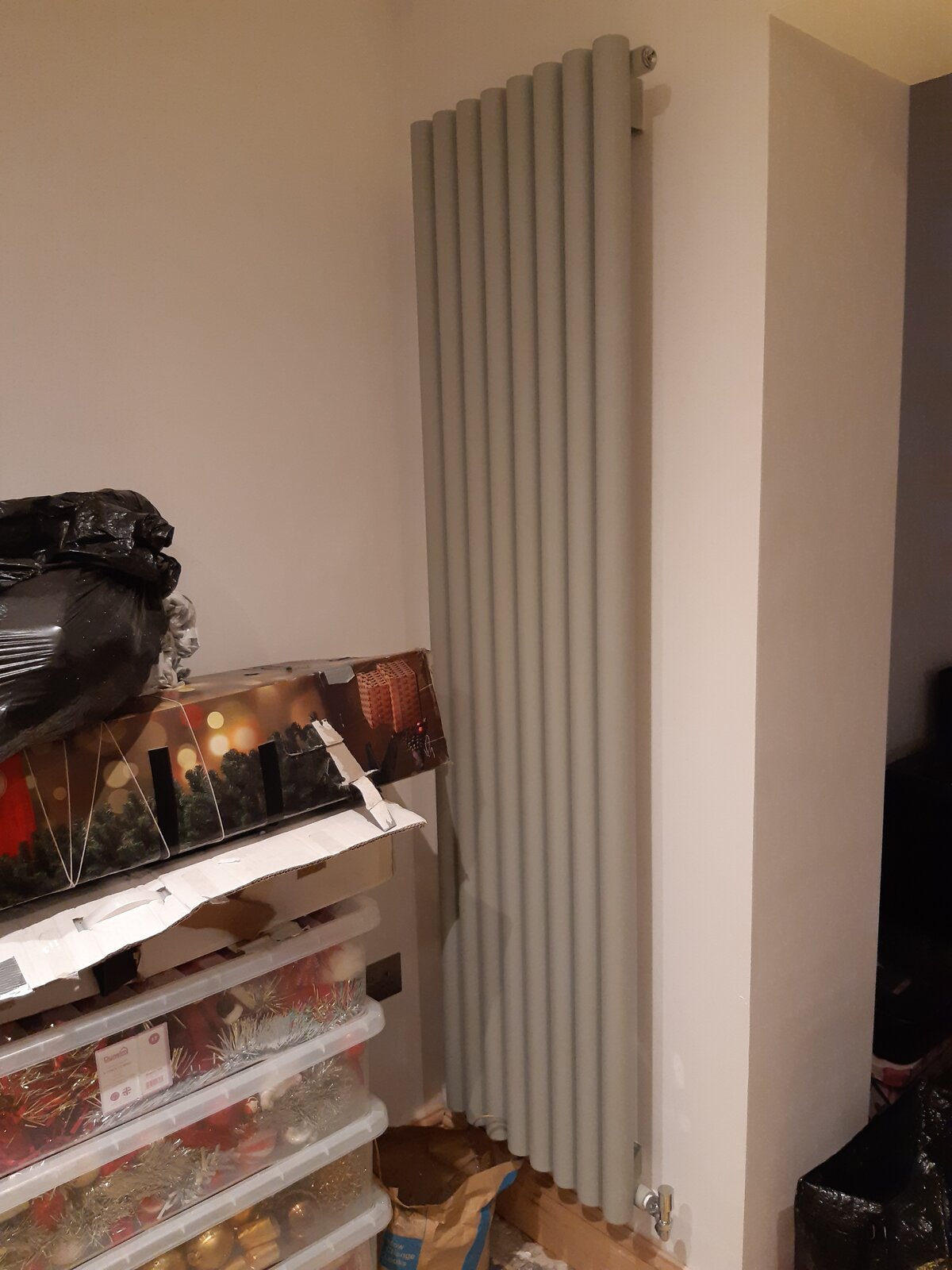

Hi gang, New extension built, one 1 radiator removed, 2 New ones added, another radiator moved position. The main house still heats up fine, the 2 New ones won't get hotter than low luke warm and the repositioned one now only gets quite warm. The main house in 15mm copper pipe. All pipework to New and replaced is 10mm white flexible stuff. Could the lack of warmth to new stuff be due to 10mm new pipe? Builder blaming my boiler but it works fine on main house. Even when new is isolated from main house it still won't get hot. Kids devastated... Could it be my boiler or the new pipes etc? Cheers all

Thanks Gas 112. I have tried turning all off apart from the 2 new. Pipes inlets at base of rads is red hot but the new never get much hotter than just above luke warm. I've even shut off all rads except just one new and it still only gets slightly warmer. Really frustrating
If you 10mm pipes feeding a radiator then they need to be teed off a 22mm pipe. Ideally copper.
Just to add, over the weeks as I've tinkered as a home DIY'er, after fully bleeding the system, tweeking pressure etc, I now have the 2 new rads fully closed as they don't work anyway but all others rads opened as full as possible both valves sides of each rad. I suppose that's not helping 'balancing' now is it? thanks again all.
Sometimes these radiators are directional. It may be the the flow & return pips are the wrong way round
When I knocked through my dining room kitchen, we bought a tall tower rad, which I hung myself to save the plumber time, after he ran the pipes and connected them, he fired up the system and we found only the bottom of the rad was hot. He checked a few markings on the rad and told me I was a c**t, the rad was upside down, there are baffles at the bottom of the rad to deflect the inward flow upwards.
I've no idea what the markings are but that would be my first line of enquiry.
Hi, sort of, tall thin radiators, thanks
I have one of those, and can confirm it has got baffles on the bottom.
It could very well be upside down! :rolleyes:
A relatively straight forward check - (with all valves closed) undo and remove the bleed valve and blank plug on top of the rad and shine a light through - if you can see through to the other side, it is the right way up. If you can see something like an angled penny washer inside, then it is upside down!
I'm 100% certain that's the issue. Top marks to Bod. Correct diagnosis.
