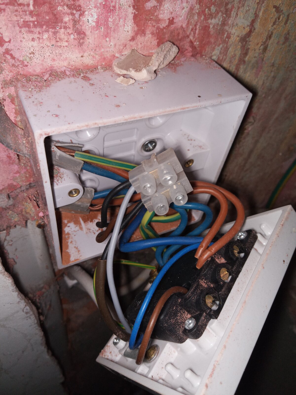

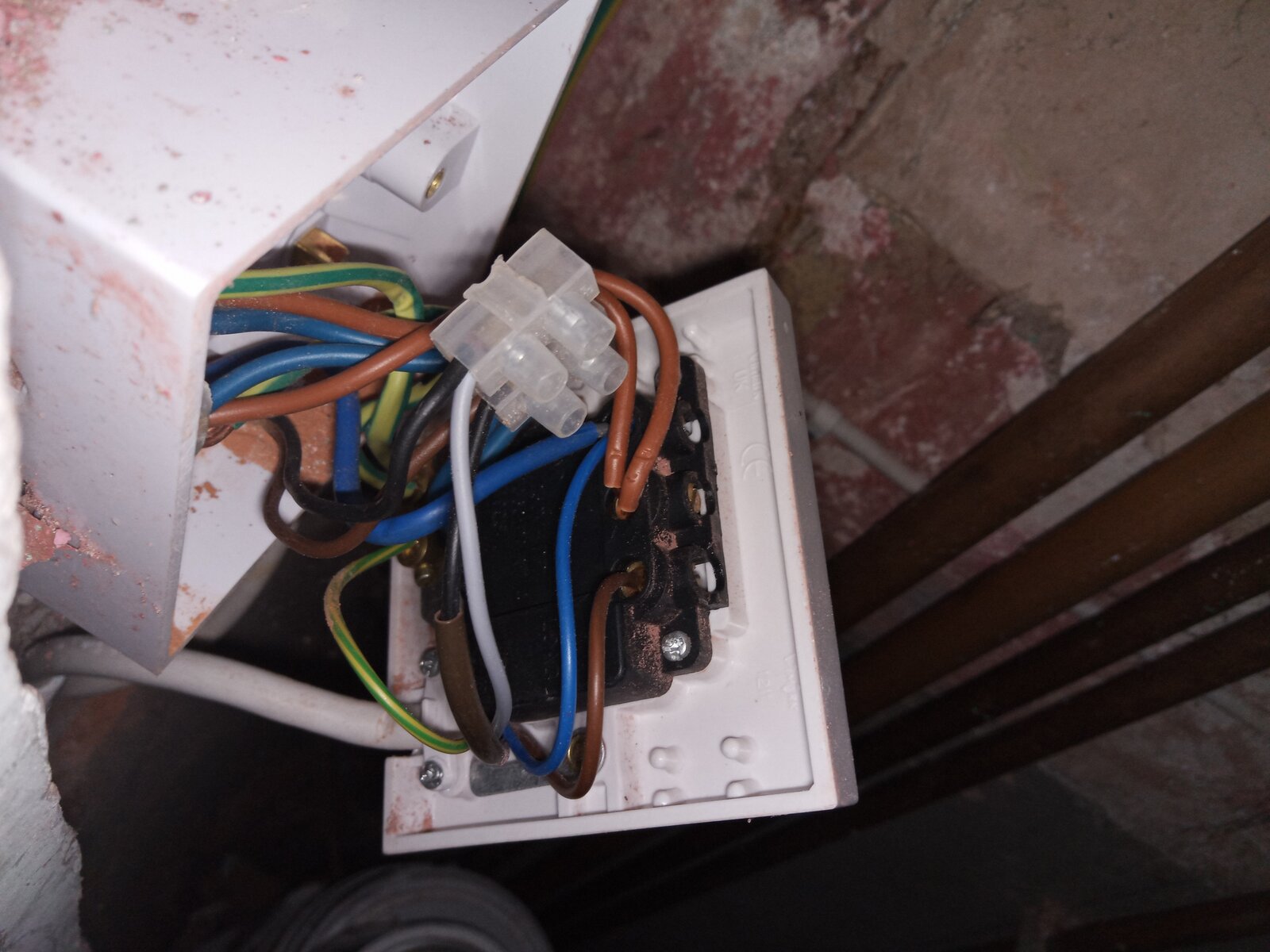

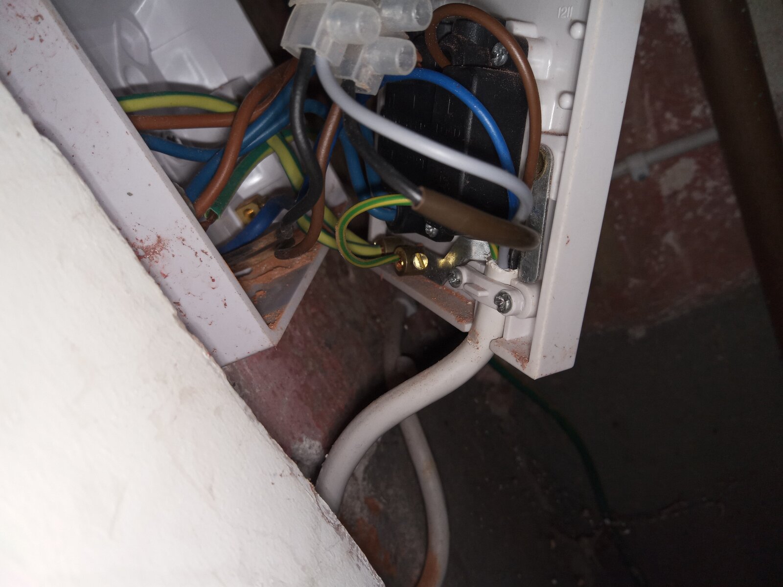

There is a brown (with black under), yellow/green, blue (with grey under) and just brown.
So there is a grey, 3 core and earth cable, coming out of the FCU, and connecting to the thermostat - this would explain the use of sleeving.
We could do with seeing a picture of the wiring behind the FCU to confirm the connections - this would be best done with the circuit off at your consumer unit.
...although I'm still going with my original guess! ;)
Blue to Neutral
Brown to Live
A small link wire between Live and Com
Black with brown sleeve to Open
And safely park the earth.

Not the easiest angle to take pictures but hopefully this shows.
The grey and the brown covered black connect to a black and a brown.

Appears so, yes
Ok, then:
Blue to Neutral
Brown to Live
Or very specifically,
Grey covered with Blue sleeving connects to N on new stat
Brown to L
Add a short link wire, from the same L terminal on the new stat, to the 'Com' terminal
Black covered with brown sleeving to 'Open' terminal
Safely park the yellow/green earth wire in a terminal block out of the way.
and let us know if that works...

Yay that appears to be working. Thank you all for the help.
