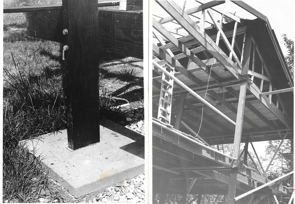

With respect but that is not a good idea. Cutting a slot exposes end grain in the slot.
In 1980 we DIY built a Walter Segal timber frame ( post and beam ) house. The design is that the posts ( Douglas Fir and Oregon Pine ) stand on lead sheet on the paving slab. 38 years later ( and 4 floods ) the posts show no signs of deterioration due to water.
The photo was taken before the excess lead was trimmed.
