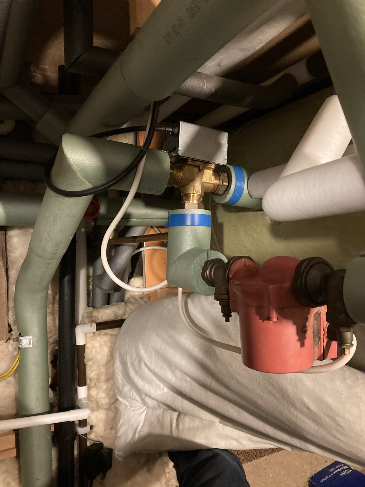

Help Required ... 3 Way Valve not always switching to Hot Water
Yes, I always assume because we only have the HW on once a day for an hour the tank stat will allow it to start 23 hours later.
What I’ve never checked is whether ours ever gets up to the temp set by the stat … 65 I think
Sorry for the delay … B to tank coil and A to return (?)
Thats the way I might expect it, you say it makes a buzzing sound when trying to change to HW, but I would expect it to be de energized on HW demand but not sure with these diverter valves.
Yes the buzzing is a bit random and not sure what the circumstances need to be, it could start at 7pm when it changes from HW to CH but it might 8am when we notice it … we just flick the fused spur off and back on again to solve it.

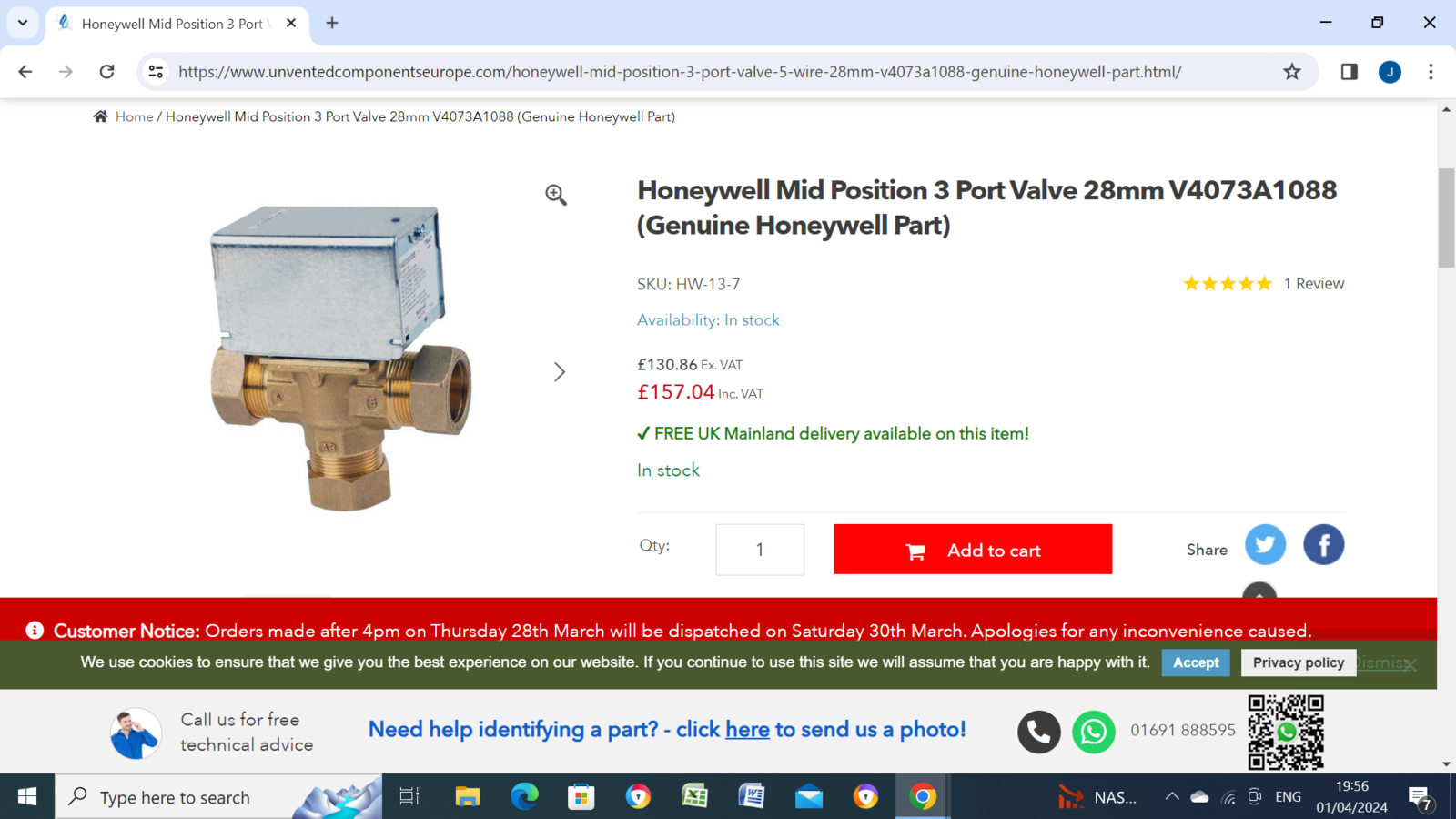

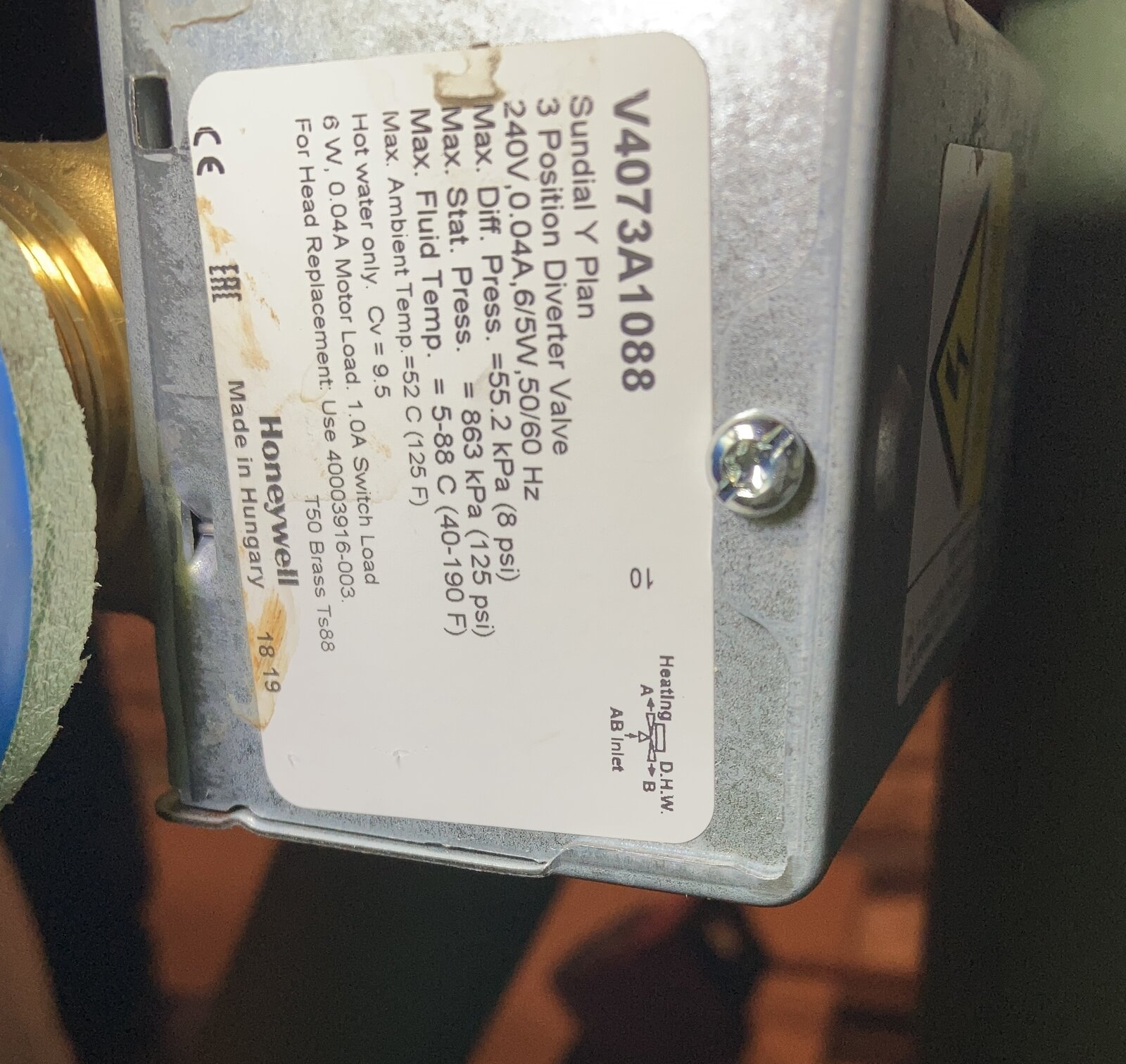

Revisiting this again, looking at the model number, I think you do have a MPV (mid position valve) even though the descriptor on the valve actuator is a bit confusing, but it does say "3 Position Diverter Valve" if you just put both to boost now with both roomstat and cylinderstat turned up, see if both CH & HW start heating together.

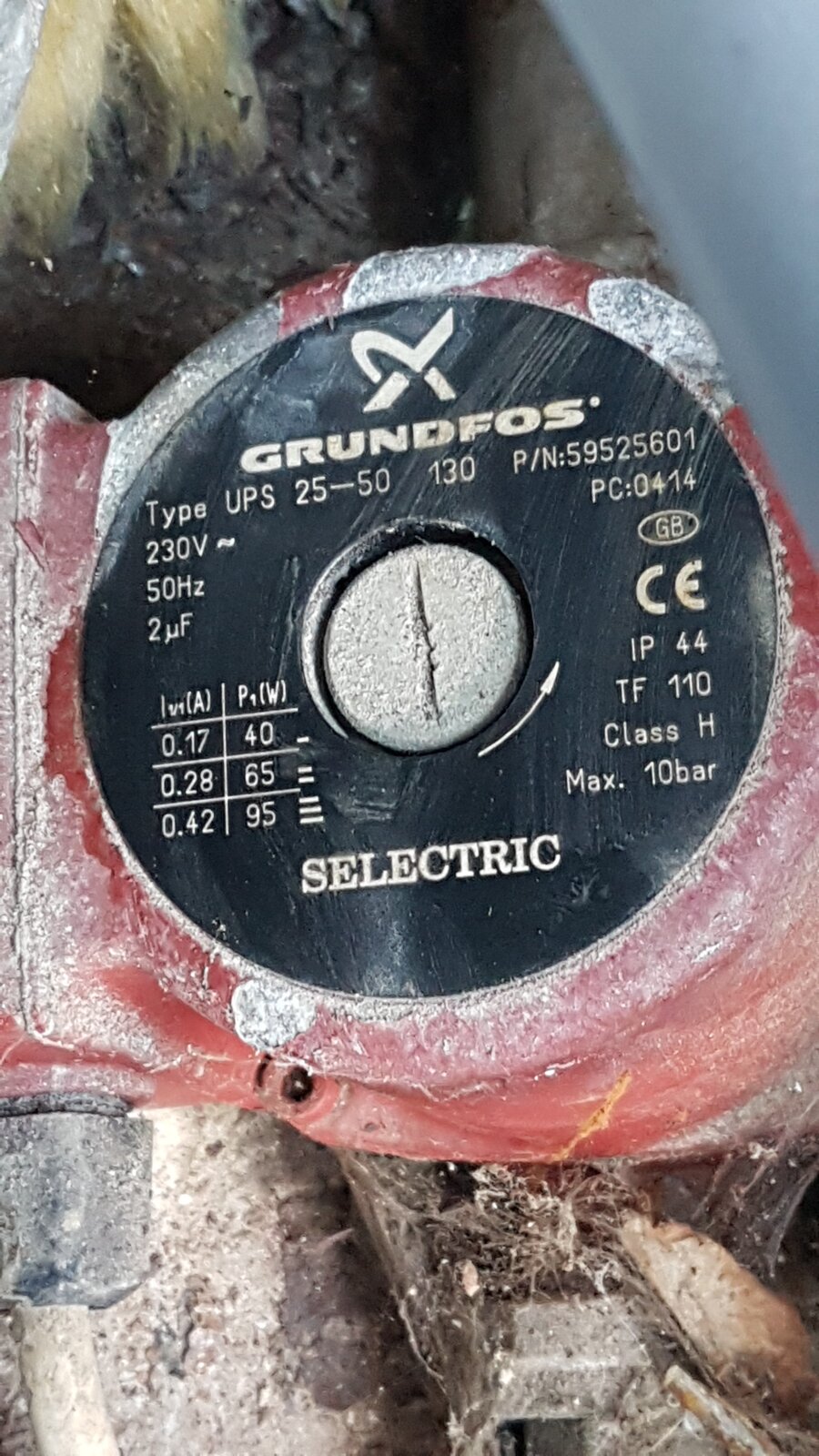

Yes, as is vertically upwards but I know of a Grundfos selectric running upright for the past 18 years!., no, past 20 years, PC:0414

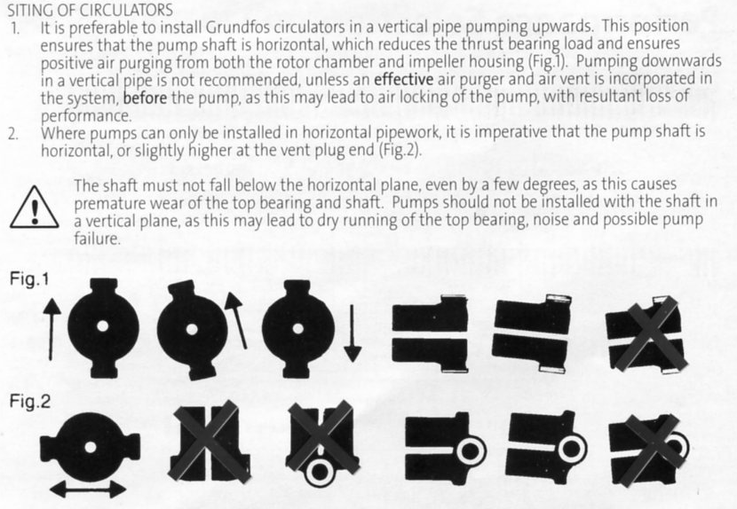

I hadn't realised the pump needed to be in a particular orientation ... how should it be, and why?
Ray
Should be hozirontally, the pump thrust bearings arn't designed to take the weight of the pump rotor.
