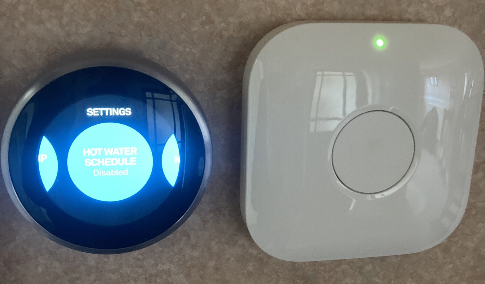

Problem was ... The last few days the HW hasn't kicked in at 6am but would if boost option was used.
Same again this morning, no HW response ... boosted for 30 mins at 0645.
The CH came on at 0700, noticed the rads got up to normal temperature.
(Always imagined the HW would take away from the CH)
Boosted again at 0715 ( The HW has been normal temp all day)
Set a new HW schedule for 4pm and stood at the side of the boiler ... nothing happened ... not a sound.
Assumed the problem was with the Nest or the connection between my phone App and the thermostat.
Checked the schedule on the wall mounted Nest Thermostat and found the extra 4pm one was showing ruling out the App
During the course of checking all the settings on the thermostat dial I found the problem ... " Water Schedule Disabled !!! "
Sorry to have troubled you and thank you all again for your help

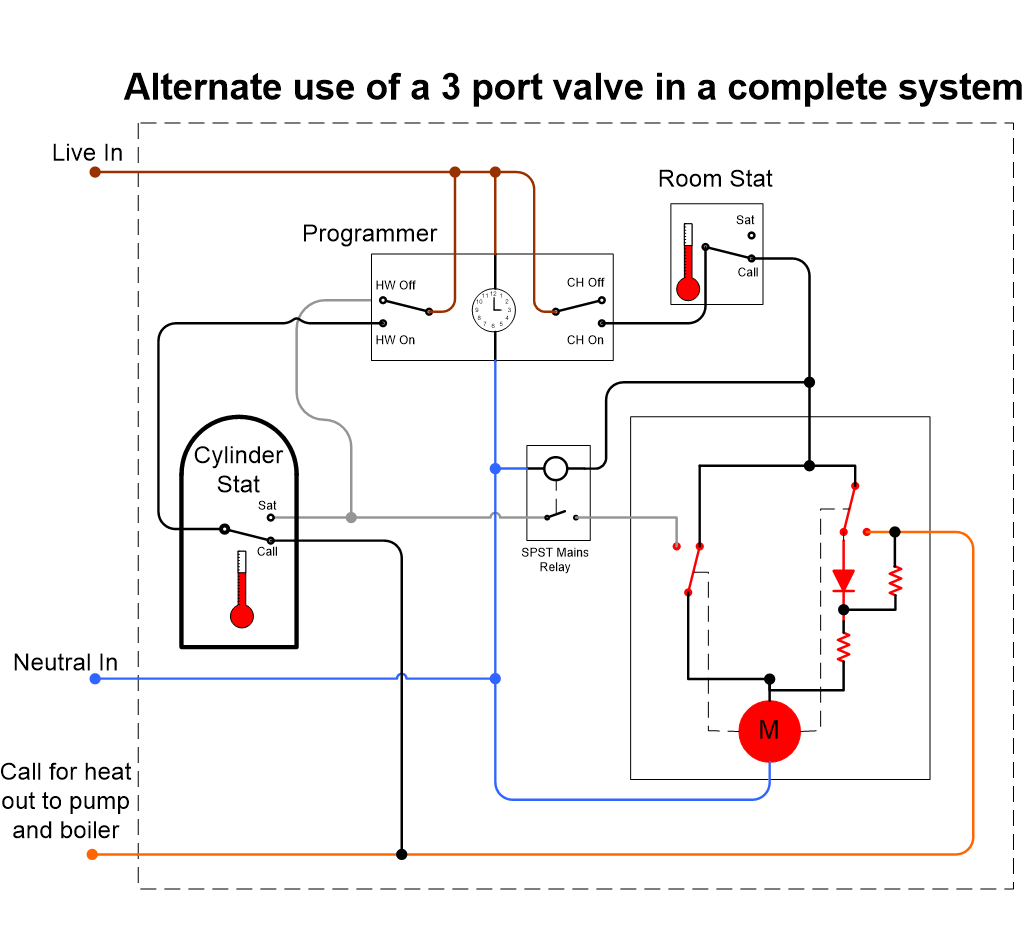

A frequent theory/fact? for the relatively short life of MPVs is their last port of call which is nearly allways CH, so even when the CH is programmed off for the night then the valve is still powered on overnight, I know someone who modified the wiring years ago and the MPV is still working nearly a dozen years later, I recently came across a neat schematic of how I imagined he did this, attached.

.... their last port of call which is nearly always CH, so even when the CH is programmed off for the night then the valve is still powered on overnight,

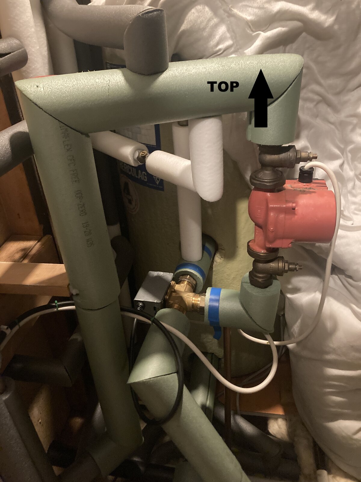

I take it you have got a system bypass in place
Manually switching on the HW for a few minutes is fine as long as the cylinder stat is calling, won't work otherwise, the relay in the above schematic ensures that the actuator is powered either fully or partially only while there is a demand for CH, it will all ways return to the unpowered state.
I think so - in a fashion - pressing the button at the side of the Nest Stat shown in an earlier picture puts both CH and HW on.
While the tank stat would control the HW I'm not sure about the room temperature under these circumstances.
I'm not sure where the actual thermostat is, but if the Nest ring were thought to have failed it would be a matter of trying another one ... it simply clicks into place.

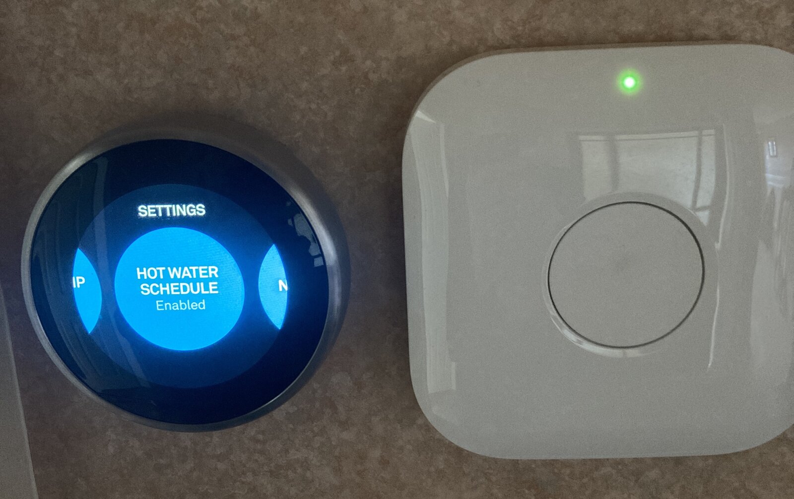

Just out of interest we’ve now got the HW & CH coming on together at 7am to 8am and it’s working fine.
Thank you again for your help
