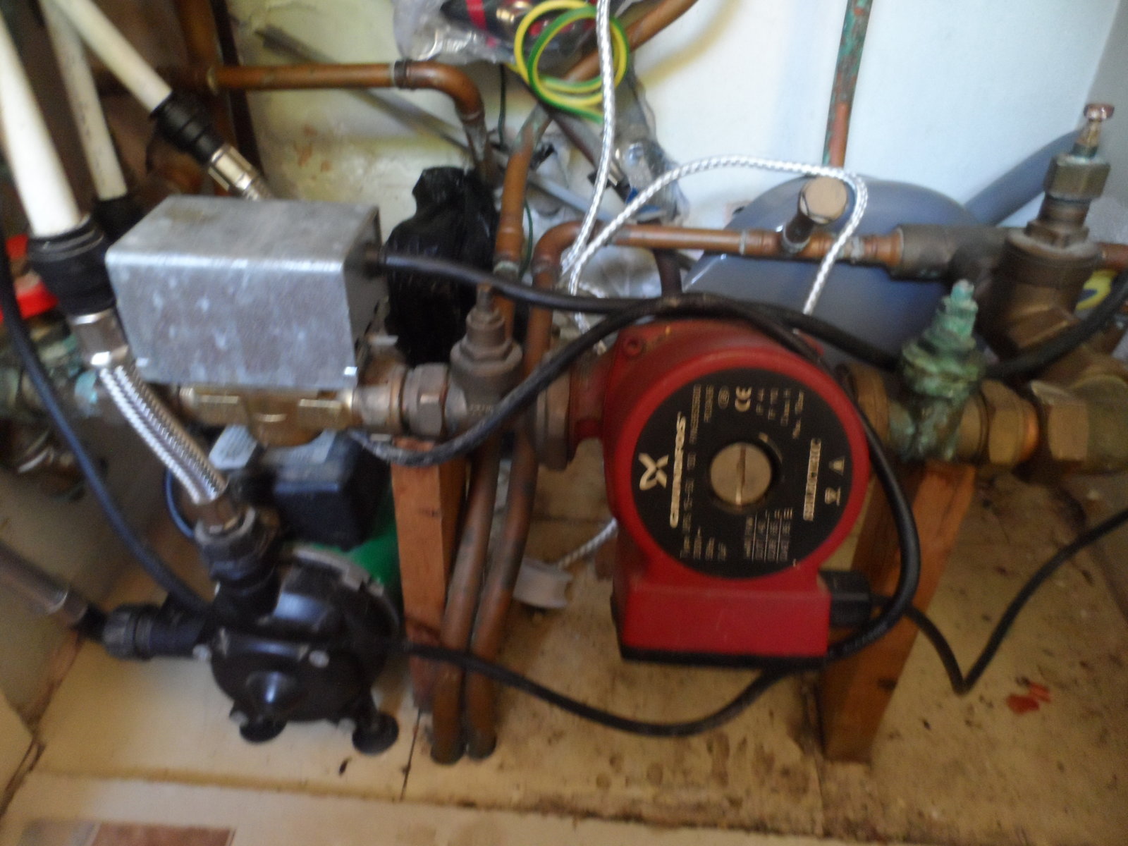

post a pic of your existing backplate wiring, you could have used any 2 channel timer didnt have to be the sunpro, wire colours mean absolutely nothing in a heating circuit, do you have zone or mid position valves ? your post infers that you have 2 x pumps one for HW and one for heating, will be extremely unusual if you do
The system is about 40 years old but works like a trojan horse !!!, i know its not energy efficient but until it goes to boiler heaven quite happy with it, as i am not a boiler engineer not sure if i have zone or mid position valves ?

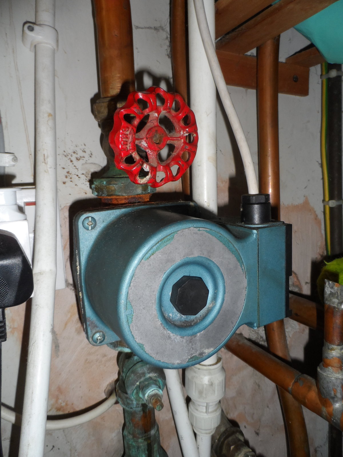

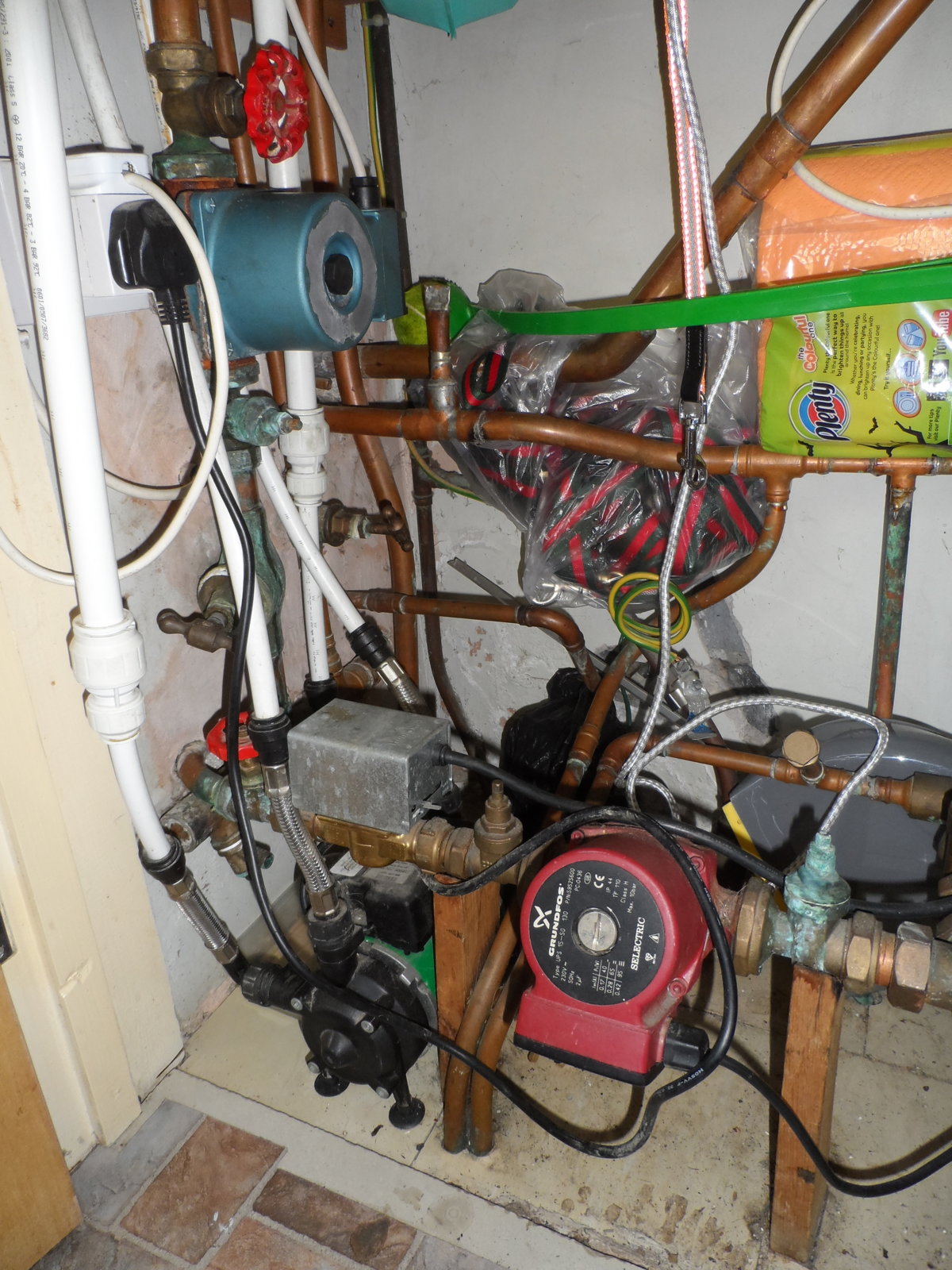

With regards to the pumps i defo have 2 the older blue one works with the hot water (when turned on you can hear it slightly and feel the vibration in the pipe going to the tank) and the newer red one next to the valve is dormant unless heating is asked for. I have taken some pictures and attached
That looks like a complete bodge, the square silver box to the right hand side of the red pump is a zone valve, it looks like it has been fitted to close when you only want HW running and not CH to stop reverse circulation to the radiators, sorry I cant help with your wiring as it is a heath robinson set up
You really need to rewire your heating system into a junction box, most modern controls are not big enough to have that many wires in them. Looking at a wiring diagram for the 423 Coral, looks like this is configured for gravity type systems and I am guessing you do not have a room thermostat anywhere...
Additionally, the grey and the orange from the zone valve are not in use, this would simplify the whole process... But, here goes...
-> Set the SunPro to Gravity mode (Switch with a P&G on the rear, needs to be set to "G")...
