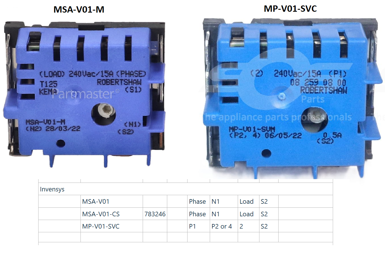

help ! Simmerstat MSA-V01-M to MP-V01-SVC wiring connection
21 Sep 2025
2
France
Hello

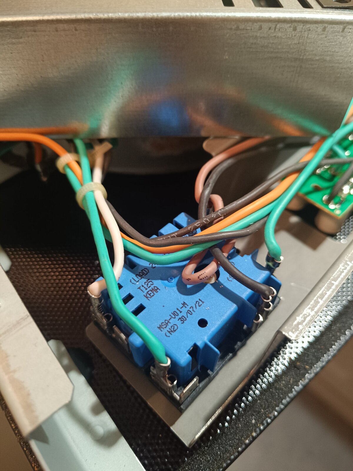

my cooker uses a MSA-V01-M (wiring pic linked) which isn't working anymore and I'm trying to change it with a MP-V01-SVC (pictures linked).
First of all can someone confirm that this swap is feasible? if so Can I get some help with the wiring please?
I've found this https://www.ukwhitegoods.co.uk/help...lts/4357-diamond-h-regulator-conversion-chart
and it seems that the connection is :
PHASE -> P1
LOAD -> 2
S2 -> S2
N1 -> P2,4
that leaves the N2->? is this a 2nd neutral that can be wired to P2,4 ?
any help is appreciated, Thanks !

I can't find anywhere that says the MP-V01-SVC is suitable for a Baumatic oven which the other number is recognised as being suitable for. So I would be inclined to go for the correct part for your oven. Unless you can find somewhere that says it is a suitable alternative.
thanks for the reply, in my case this is not a Baumatic oven but a ceramic cooktop (FRIONOR DV29) I'm not sure if this changes anything ... the thing is I can't find any cheap MSA-V01-M (almost 90euro with delivery at that price might as well buy a new one), while I've found MP-V01-SVC for 20e or so
Yes I noticed that also. FRIONOR is distributed by Beko and made in Turkey.
Perhaps Beko can help you. I would suspect that the green wire you are asking about may just power a neon indicator that operates when the hob is on but can't be sure of that. Can you measure a voltage to earth at the LOAD terminal or the green wire when you switch it on
