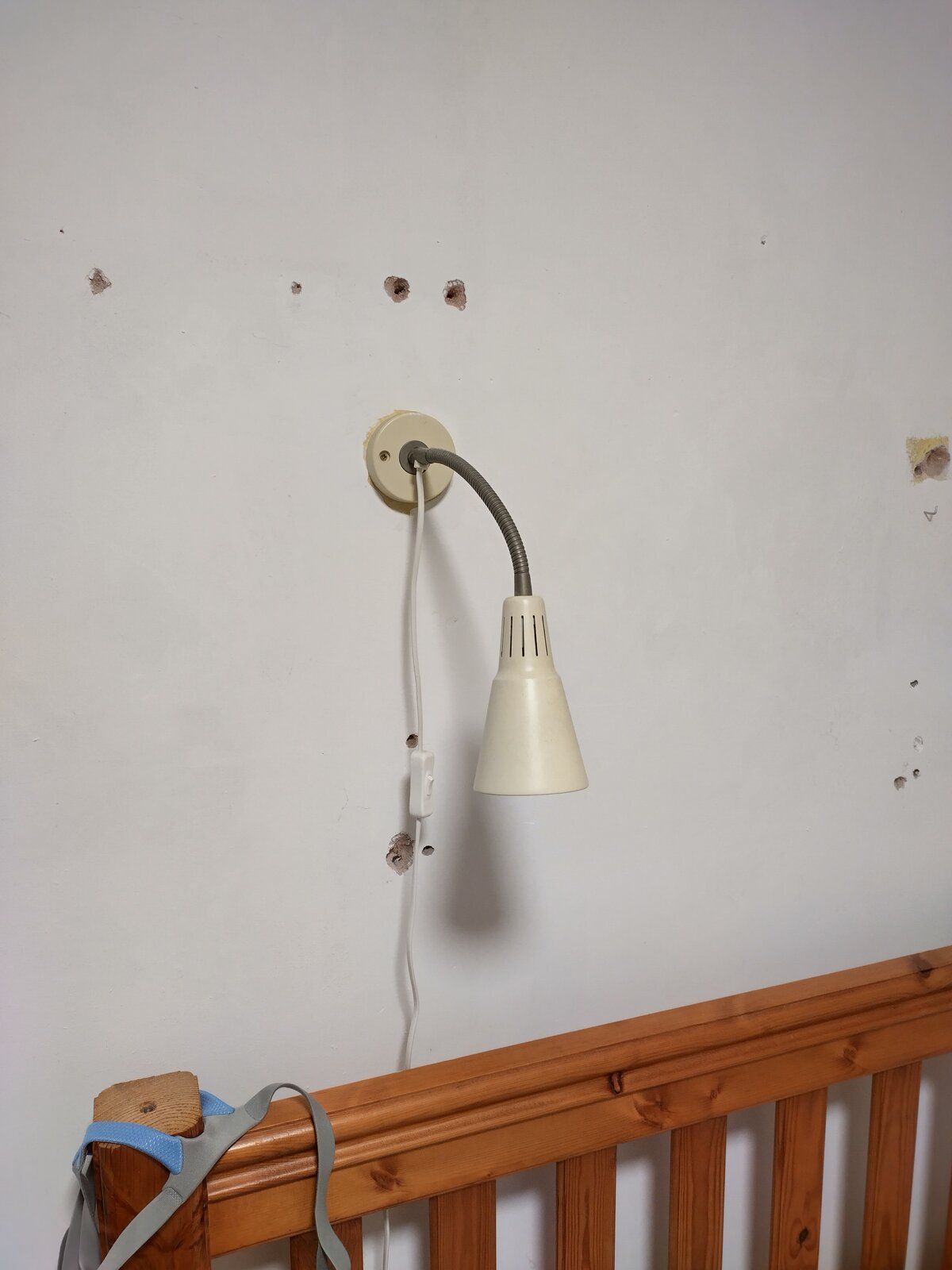

Hello.
We have a room we are renovating and I'd like to fit two Wall-mounted reading lights, one over the bed and one over a desk.
At the moment there's an old IKEA fitting over the bed which is the sort of thing I'm looking for (wall-mounted, flexible, built-in switch), but I need one with a switch in the base and be hard-wired.
I've tried places like Q&B, Dunelm and IKEA and places like TLC and QVS but with no luck.
Can anyone give me some supplier's names I can check out please?
Cheers.

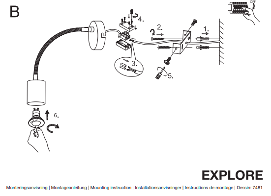

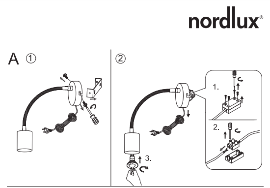

Same make and model number, but from an Australian supplier (click here) gives a link to installation instructions (click here) which shows the following. It seems that it comes with and lead and plug emanating from the hole at the bottom of the casing (Diagram A) but that one hardwire to a connector block inside some sort of (presumably plastic) mini enclosure inside the back (Diagram B) ....

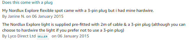

... and a Q&A on Amazon for what appears to be the same product (in 2015) seems to confirm that it comes (or, at least,did then) with a fitted lead and plug (seemingly a 3-pin UK one, not the 2-pin job shown in the Australian instructions)...
