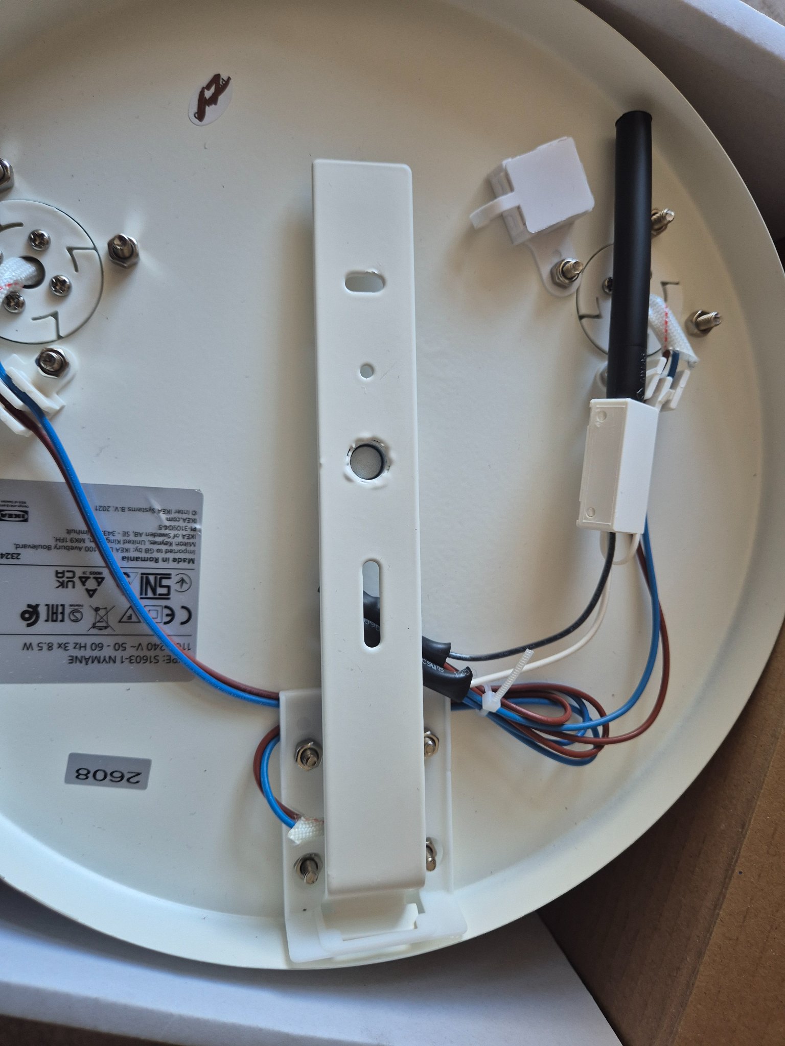

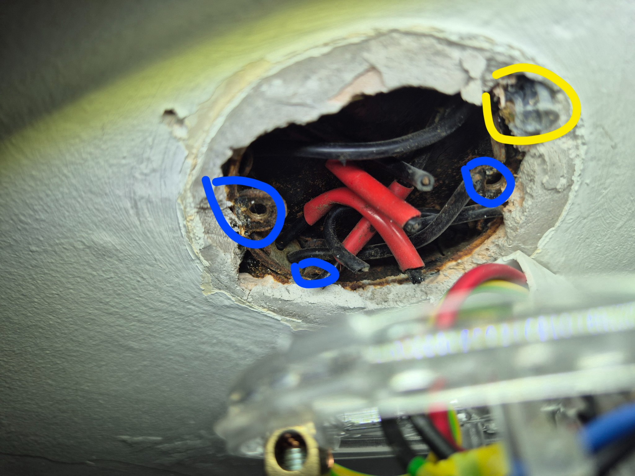

I'm trying to install an Ikea ceiling light ( https://www.ikea.com/gb/en/p/nymane-ceiling-spotlight-with-3-spots-white-00336267/ ) but am having trouble getting the backing plate onto a firm fixing.
My electrics are surface mounted (rented property) but after removing the ceiling rose, I found a metal box where the old wiring was. The problem is the Ikea plate holes don't align with them and I am unsure which type of screw would fit into it anyway.
There is a wall plug precariously hanging into the side which I am reluctant to disturb - it is used to secure the ceiling rose at the moment.
Attached is a picture of the ceiling (screw holes in blue, wall plug in yellow) and the Ikea plate. Any ideas?

Electrical rethreading tool M4 size and modern electric box M4 bolt.
Normal is 3.5mm..
Fix ply wood.
Fix light to that.
use wago to wire.

Looks like a standard conduit box to me. Old would be 2 BA new would be 4 mm and 2 inches apart. This has been a standard for years, so the Ikea slots should match that standard.
As said you do need permission from Landlord to do this work, and normally they will require a minor works certificate raising to cover it.
2BA looks about right. Two screws secure the pendant base to conduit - what appeared to be a 2BA and a crosshead going into the wall plug.
I tried putting the Ikea baseplate over the holes and couldn't get the screw holes to line up.

The other option would be to reinstate the ceiling rose with a long piece of flex and re-site the existing fitting nearby.
Then, when you leave, you just trim the flex to length, refit the lamp holder and remove your fitting from the ceiling.
my gut feeling is the base looks to be around 200mm which would make the minumum slot spacing around 100mm. Personally I'd take Flamepors suggestion and drill one or 2 holes to suit the conduit box spacing
Given there's a slot on the ceiling fixing already it might only need one hole drilled in the right place
Besa box is slightly over 50mm centres, assuming that centre holes a 10 or 12 mm lighting bar hole, the slot and hole is likely fine, proberly need opening up to 5mm to take the 2ba screws
