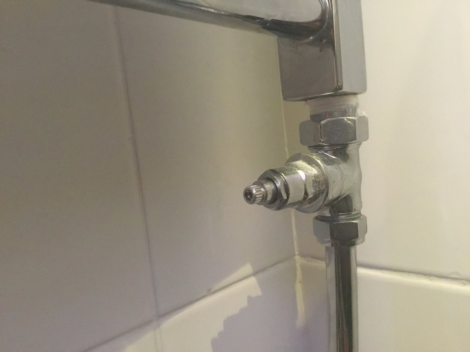

Help, towel radiator cold all the time
Got it off. Looks same as other side

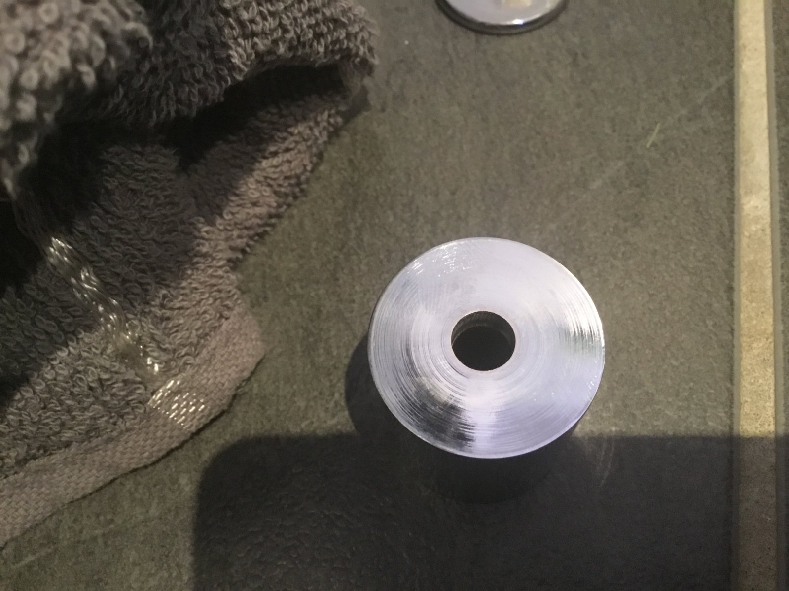

The collar is smooth inside so assuming this is just a cap for the lock shield valve on that side?

Heating on now so will see if heats up. Should both sides remain fully open?
Left hand side is half a turn, right hand side which I think is lock shield side is about three turns
Seems to be warming a bit but still way behind other rads
Close the TrV' s on all other rads ,do not touch their lockshields. Bleed air from the problem rad. It should then get to full temp very quickly. If your system is pressurised ensure pressure is 1 bar after bleeding.
