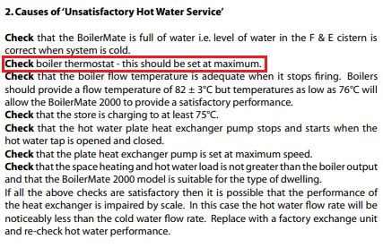

If your cylinder actually is a thermal store, then that's not quite how it works. For your hot water, the cylinder works like a combi boiler. The cylinder is full of very hot water. Cold mains water passes through a heat exchanger in the cylinder, and the hot water in the cylinder heats it instantly, like a combi. Then the heated mains water goes to the hot taps. Obviously, this cools down the water in the cylinder, and after a period there's not enough heat left in the cylinder to keep warming the water from the mains. I'm not sure if this will help, but hopefully it might help you work through a solution.
I'm not a thermal store expert, but I have worked on the controls of a couple of them.
Those I saw all stated that the boiler thermostat be set to maximum.
The below is from a Gledhill Boilermate manual, so may, or may not be applicable to yours.
Also, it was recommended that boiler should be left 'on' permanently 24/7 because when there was no demand the thermal store would be charged up and ready to go instantly, the idea being that if there is no requirement for heat, the controls would shut the boiler down until there was a demand. Although users reported that due to heat loss, the boiler would fire up occasionally for a few minutes to top it up. Sometimes in the middle of the night. In one case I added a dual channel timeswitch and used the hot water channel and set it to switch the boiler off between 11pm and 6am so that it didn't wake the sleeping household.
In your case, as the thermal store is now being used to provide CH as well as HW I'm imagining in the winter it isn't storing enough heat to do both.
