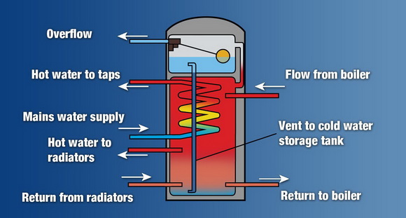

1.) Do I definitely have a thermal store? Increasing the temp seems to have resolved the issue but I just want to make absolutely sure that it is not another type of cylinder that I now have the temperature too high.
I have checked for labels on the cylinder and can't find anything. How can I be certain this is a thermal store?

The two pumps are the clue to it being a thermal store, one circulates water from the boiler to heat the thermal store, it will run whenever the boiler is on, the other pump pumps the water around the radiators and will run whenever the radiators are on.
An internal coil heats the mains water as it passes through the thermal store.
THERMAL STORE
