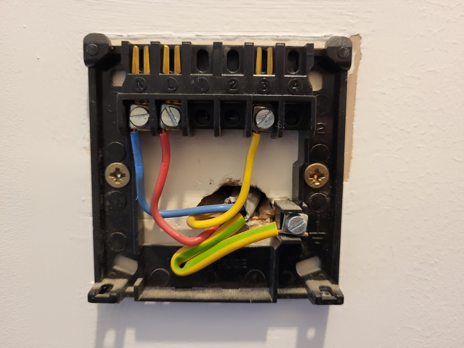

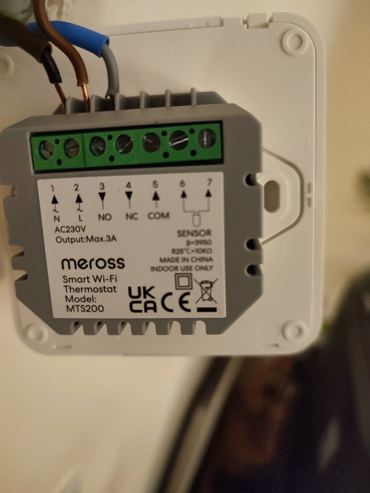

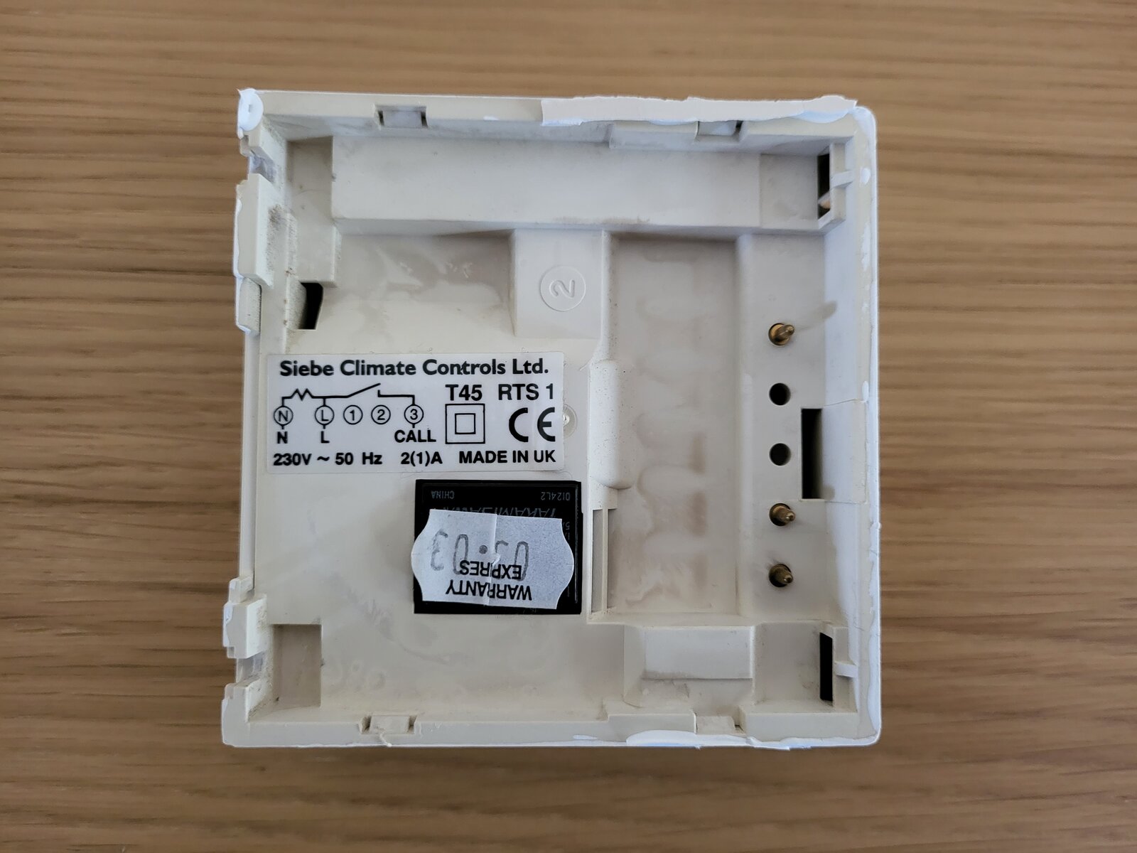

I am replacing my old Drayton RTS1 thermostat with the Meross MTS200B and I don't get the heating switching on. I thought it was going to be straightforward but at this point better to ask for help than screwing something.
The old thermostat wiring is this one:
The new thermostat has this wiring:
I assume I placed the N and L properly but I moved the other cable arround withouth success. Any help is welcome.
Blue to N
Red to L
Yellow to NO
Additionally...
Add a short link wire between L and COM
Safely isolate the earth wire in a separate terminal block.

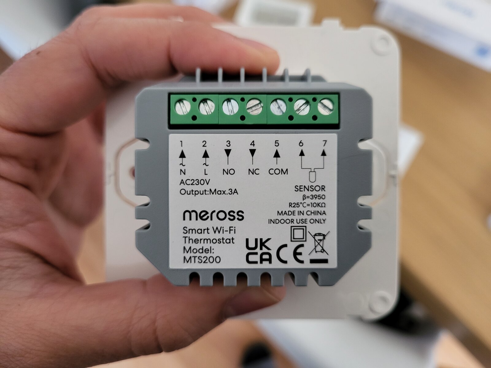

Hu guys. I had 2 - wires mechaniocal thermostat, tried to set up the Meross. Did everything as suggested here (N to N, L to L, and additionaly L to COM), but heating not turning on. I am hearing "click" sound on the thermostat when it turning on heating mode, but in boiler room lamp indicating that heating is ON, do not light. What I did wrong, any suggestion?
If you had a 2 wire mechanical thermostat, then you a) have one different to that of the OP and should have started a new thread instead of hi jacking this one and b) you won’t have a neutral wire, it’ll be live and switched live, it’s even brown with no blue sleeving!

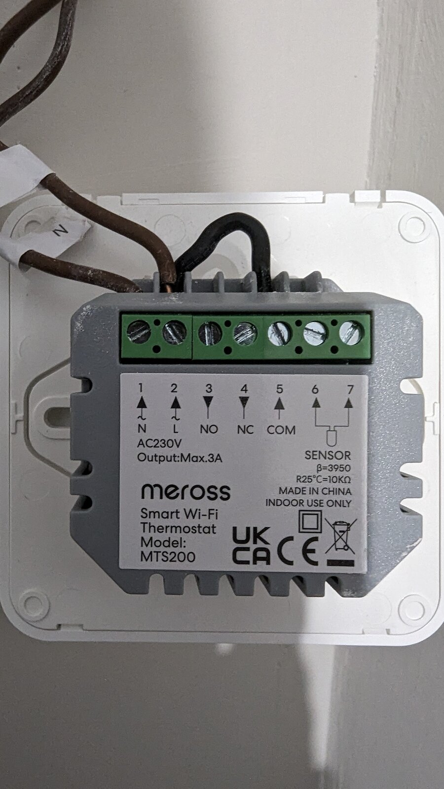

Hi I have the same Meross thermostat, which isn't powering up properly. The screen keeps turning on and off. Would the short link wire from L to COM solve this issue?
Well, at least in that configuration, it wouldn't have blown up.
Keep it turned off for the moment and don't touch it - you appear to have wired it up incorrectly.
Was there an existing 'stat that you have replaced, and did you take any photos of its wiring?
